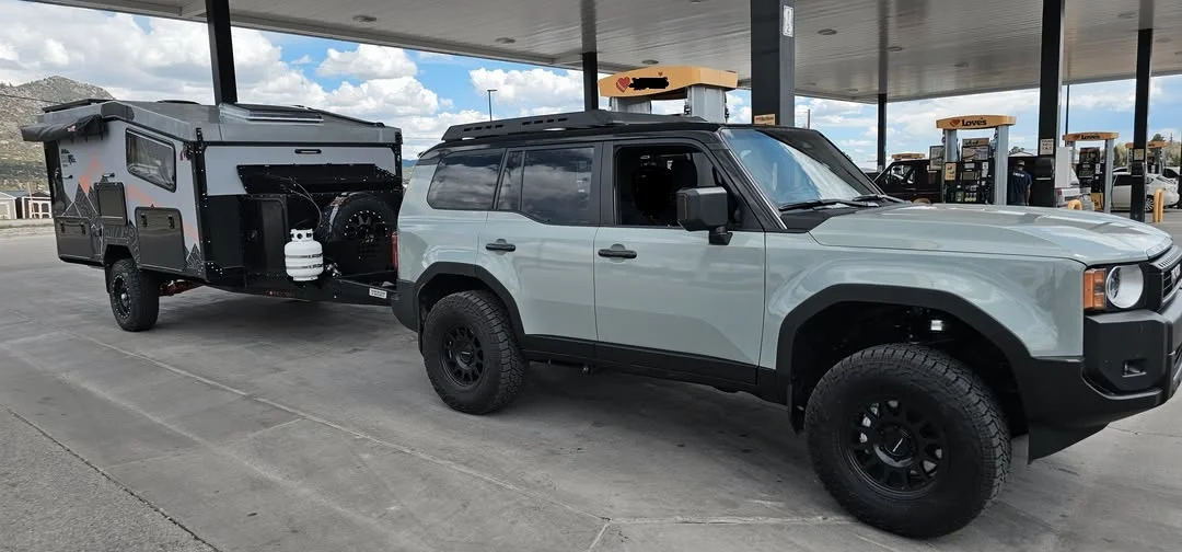

Photo not mine, i just found it on the web,

Doubt you would fit 35s without it being stuffed? Maybe 295/70/18 Recon Grappler or 315/70/17 Goodyear? Little smaller and not super heavy.
On a side note I bet that little 250 cruiser was an absolute joy to drive with that oversized heavy tire combo and travel trailer!
Oh, that little 4 banger must have been screaming (literally) for help on inclines. I am sure the owner would say otherwise though... :rolleyes:
And on any scale those Falkins usually rate as absolute heaviest.
Transmission was definitely crying.

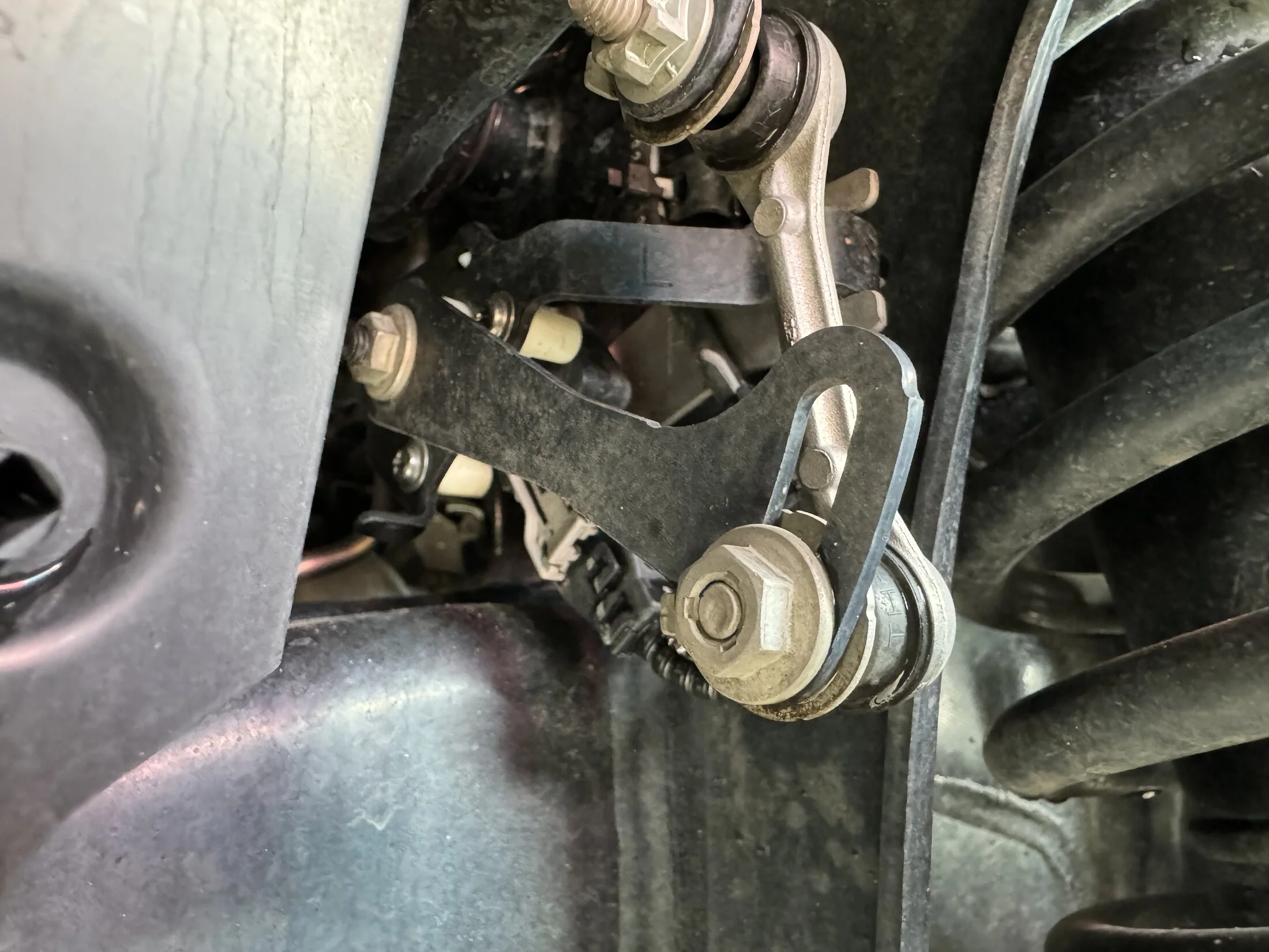

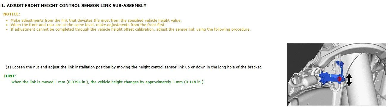

Have you tried adjusting the height sensors? On the 100 and 200 series AHC trucks there are height sensors at each corner that you can adjust and set the neutral ride height about 1-1.5” higher.
If you have techstream there is also a height offset utility.

I’ve done it… nets 1” of extra lift. I suppose you could adjust just the front to help level it.
Lowering the rear causes the system to bottom out in L, which raises the vehicle back into N so don’t do that.
The arms are easy to adjust so it’s simple to play around with it. Just loosen the bolt on the adjustment arm and slot it all the way down to lift the truck.

So essentially only lower the front adjustment arms is what you did?

Does this increase the height of H2 (max height) as well?
Cool so to be clear, put all 4 all the way to the bottom to net a 1” lift? Any downsides to this?
Correct… just loosen the nut and slide the bolt to the bottom of the bracket and then tighten it back up. No down sides.

Bringing back this post...thanks for the picture, got some questions. I'm looking to just level out the front of my AHC. When adjusting the arms it looks like you can adjust it to any position in the bracket, or do you have to slide it all the way? I haven't looked at mine yet, so this may be a dumb question, but does it need to be in any certain height mode when doing the adjustment?
And you said you've found no issues so far...so if I were to raise the front an inch, it would stay that way in all modes, so even when it automatically lowers at highway speed, it stays level right? And essentially, if you decide to do all four, you get a "free" 1" lift. Have you tested to see if it still raises up in 4lo?
