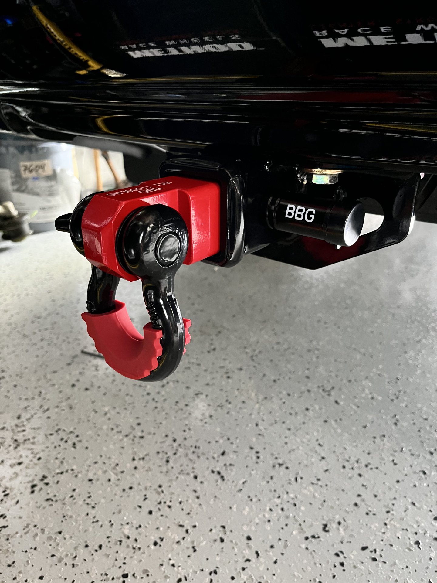

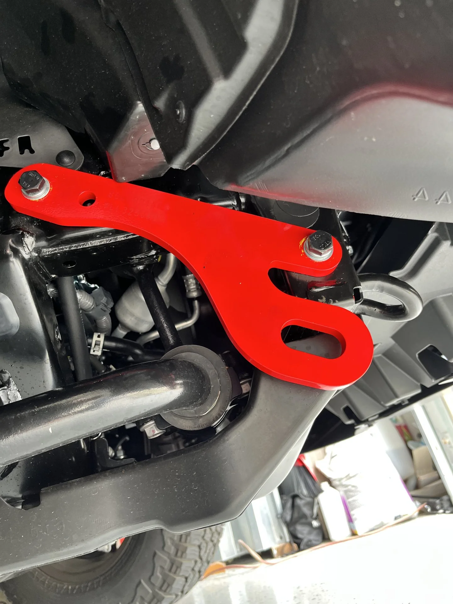

I have a 2022 GX460, and just purchased after market recovery points from Bbg4x4 for the front. However I’ve seen some IG posts with people hooking up shackles to the stock tow/strap points. Is that sufficient enough or do I need aftermarket recovery points bolted into the chassis? I’m guessing those stock points are not good enough for snatching? Thanks for the help!

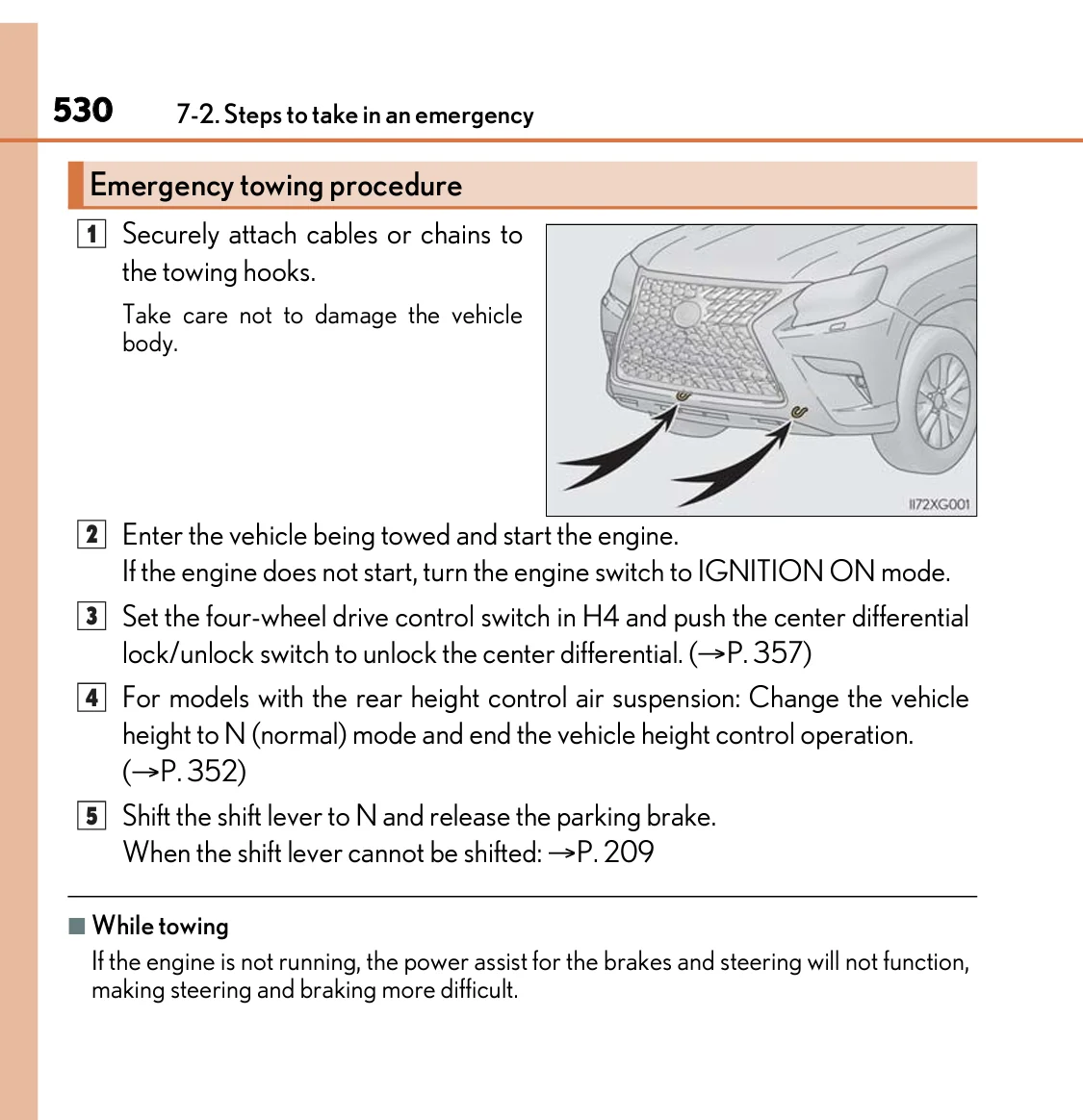

Read your owner's manual! On my 2018 it states in the owner's manual that you can use them with an elastic recovery strap. AKA a kinetic recovery strap or rope.

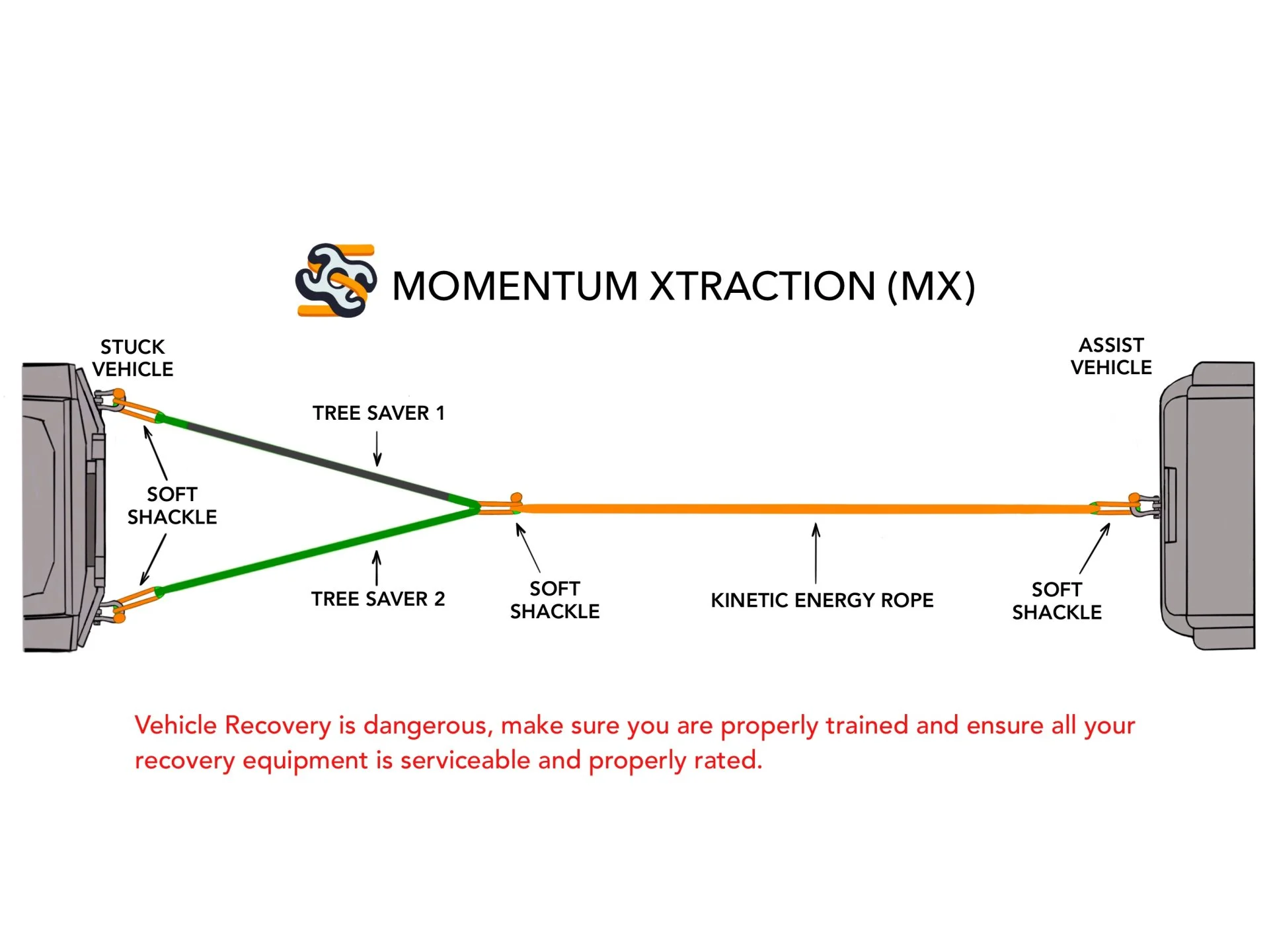

When conducting a kinetic recovery it is best practice to connect a bridle to split the forces over two recovery points (if equipped), see below example from Safe Xtract.

Thanks for tips and advice. I’ve read it before. Nothing in detail as your manual. Here’s a snip.

Recovery points are a must, IMO. They aren't just for you but can also be used for pulling out someone else. You also never know when you'll make a mistake off-road and need to be recovered. Sometimes streams or mudholes look a lot shallower than they actually are. My SRQ Fabrication recovery points were all of $120 shipped. It's easy to do a lot more than $120 in damage to a GX by recovering from the tie-down points and bending something in the core support. Or having the tie-down rip out of the core support and become a projectile.

Unfortunately if you've kept your GX stock, (read: not even trimmed either the front or rear bumpers) then there's a very good change you'll rip something off your rig.
I completely understand what Banandalorian is saying about using the factory recovery points.
Really, on a box-stock GX, the factory recovery points are best as tie-downs on a flatbed (piggy back) tow truck, unless you can pull/be pulled linear by something that is lower than the lower lip of the bumpers.
