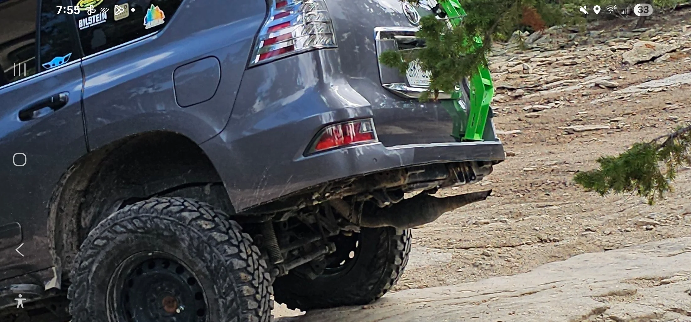

really depends on the car. i had 2 cars when i lived in the north east. one taken care of, one not really. the not really was rustier but not dangerously so. my so cal gx is mostly rust free. mostly because i drove through potash road in canyonlands and didn’t wash it for a couple weeks.

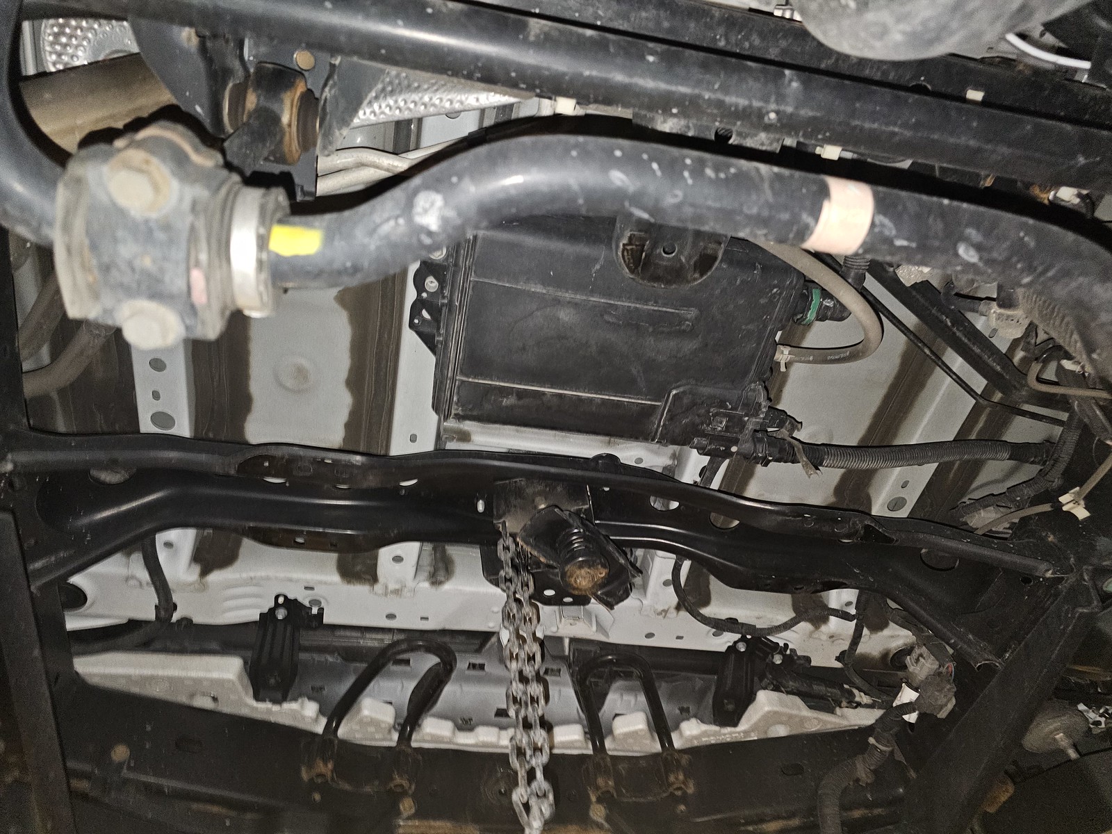

The best shot i have showing my frame rust. I am at 145k now and wash it at least once a week. I can take shots underneath once I clean it.
