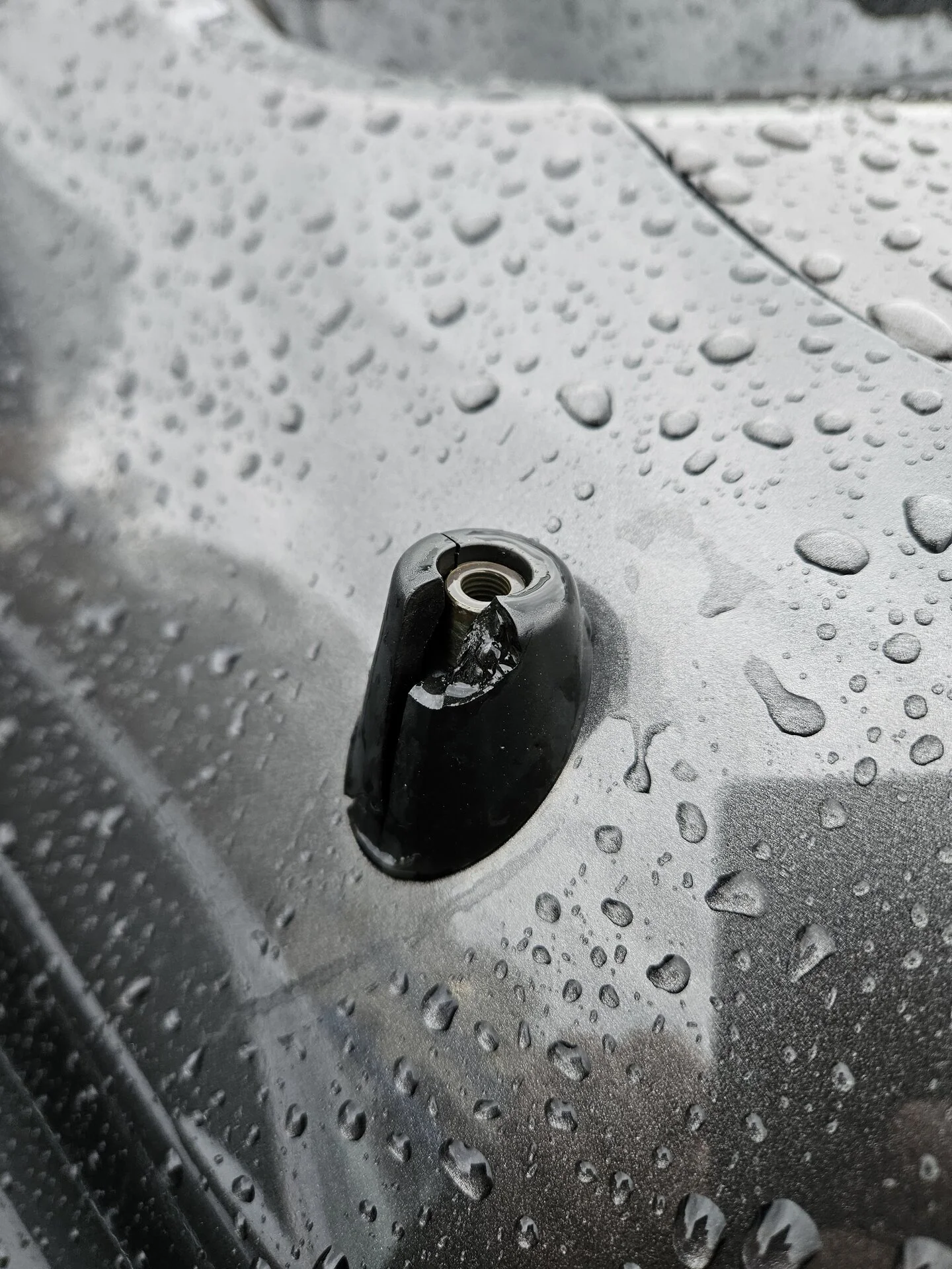

The antenna grommet rubber base cracked making the antenna getting loose overtime, I haven't replaced that, I removed the antenna like 2 years ago.

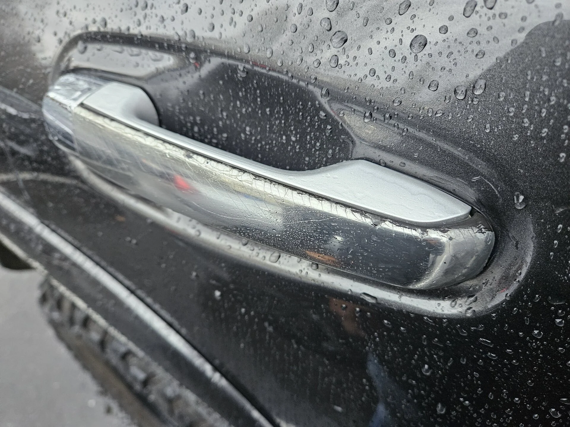

Another thing, all the chrome door handles fadeout and cracked. I don't think I will replace those.

My door handles are the same as yours also.
