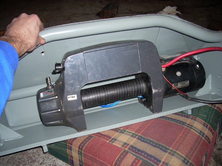

One question though, with that beastly train bumper you riding on the front....what if something goes wrong on the winch? How is there access to that without having to take off the entire bumper?
Yes, the bumper has to come off to "fix" the winch. While this may sound absolutely stupid in the United States, its not where all four wheels can be stolen while sitting in traffic in Liberia. =)

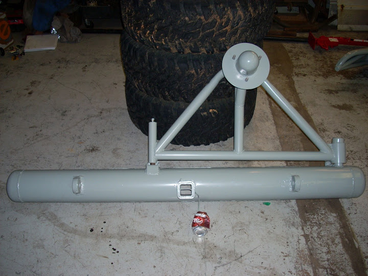

Rear bumper complete

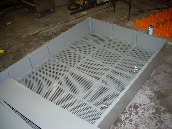

Roof Rack complete

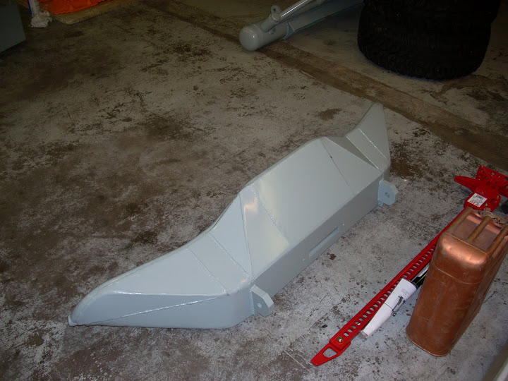

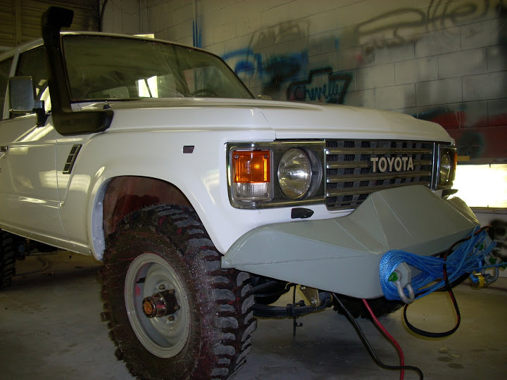

Front bumper complete

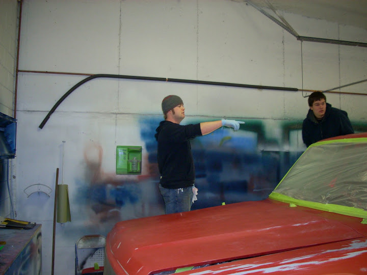

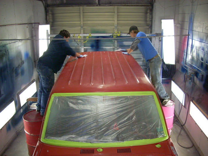

Brad Foster directs as the surfaces for the painting are prepped

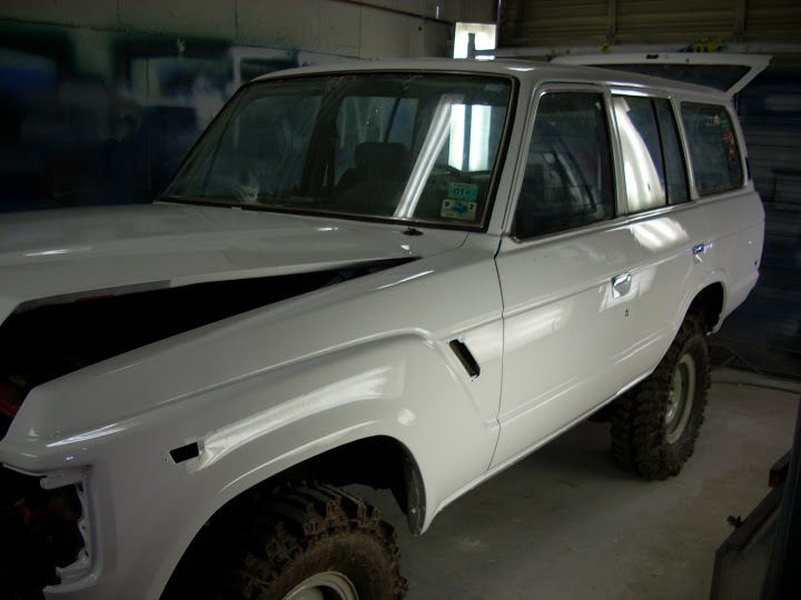

Paint is on. More pics tonight and tomorrow.

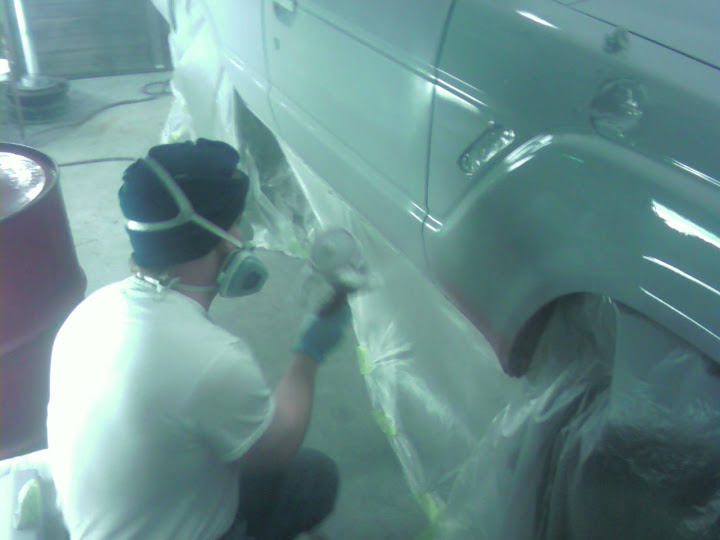

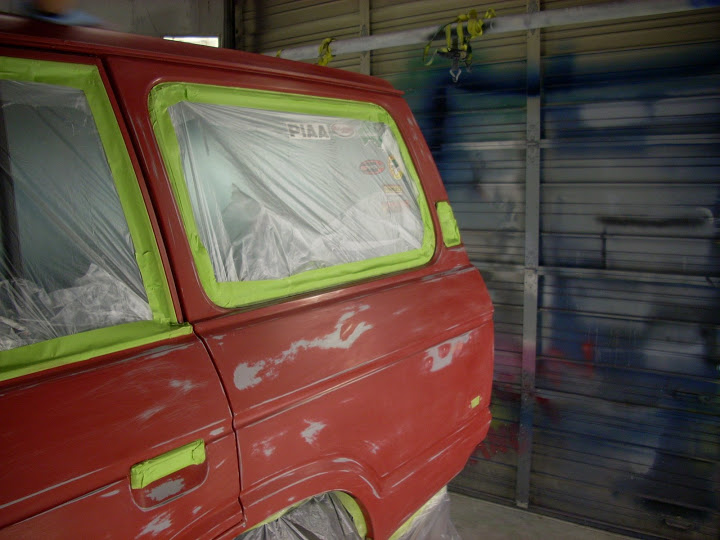

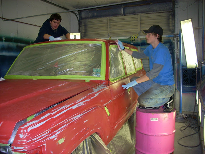

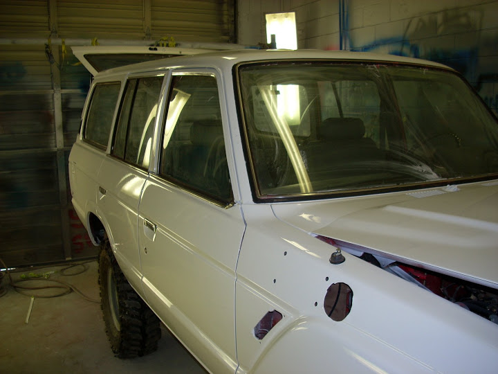

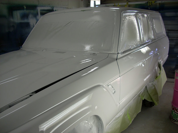

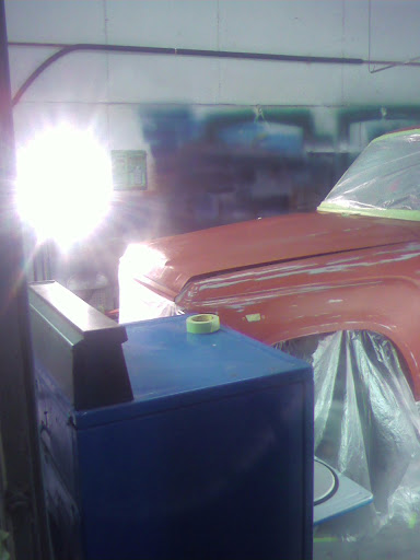

Painting pics

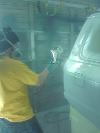

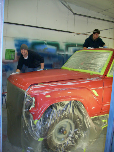

So it got down to 21 degrees last night (the coldest I've ever seen it in my six years living in East, TX). The minimum painting temp is 60 degrees so we used every possible method to get the temp up in the paint booth. We wound up taking our shop clothes dryer, taping the switch closed, putting a fan in front of it and ran the dryer wide open. We successfully got the the temp up to 61!

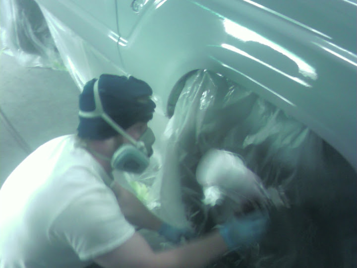

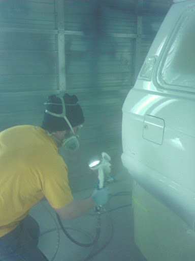

The spraying begins...
Joel with the self portrait...
Spray, Spray and Spray some more.

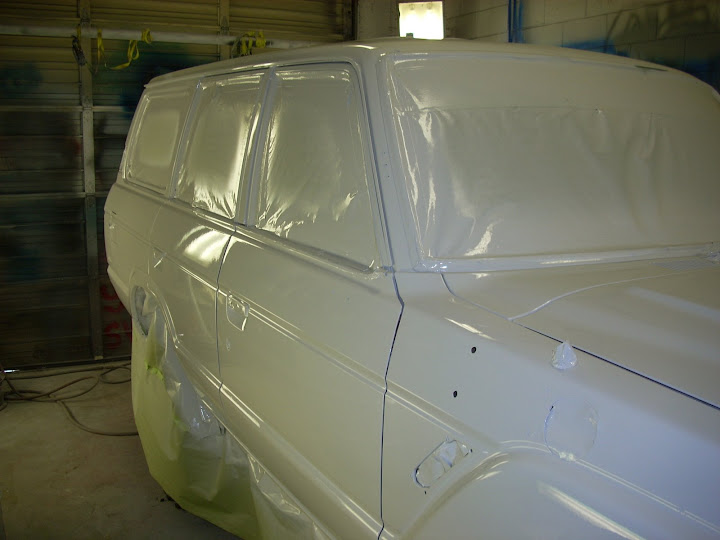

As a side note, we shot primer and then single stage urethane paint. Its supposedly the "toughest" paint you can spray. I guess only time will tell

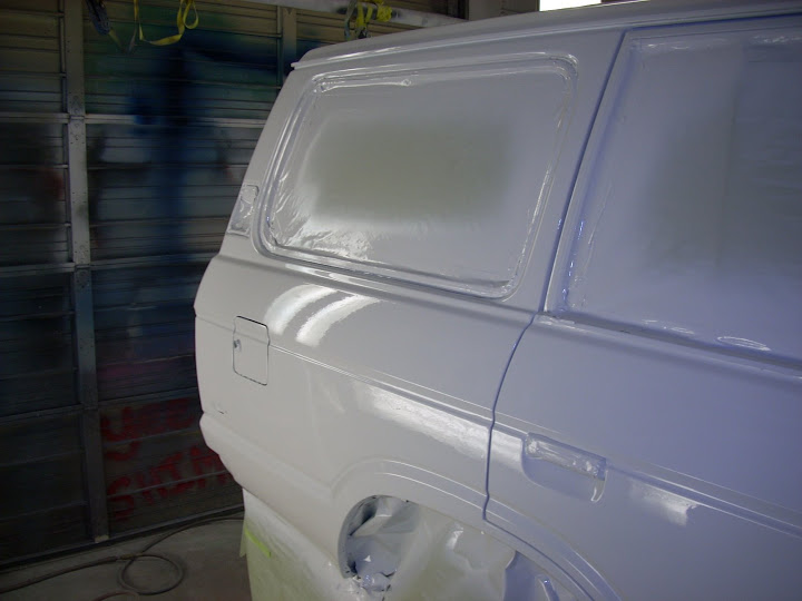

Spraying complete
Tape off

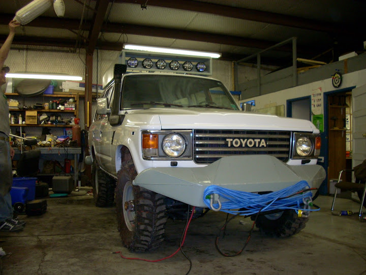

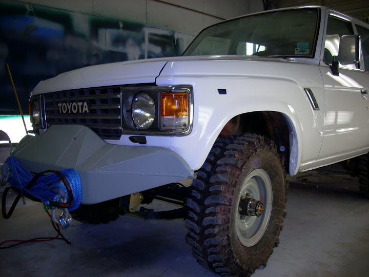

This is what the winch looks like from the backside inside the front bumper
Head lights and grill back on

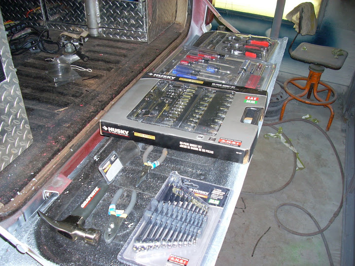

We got our local Home Depot to donate a bunch of hand tools.

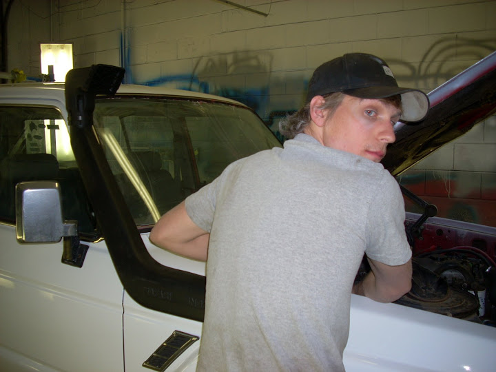

Joel Re-installing the snorkle
Getting there...

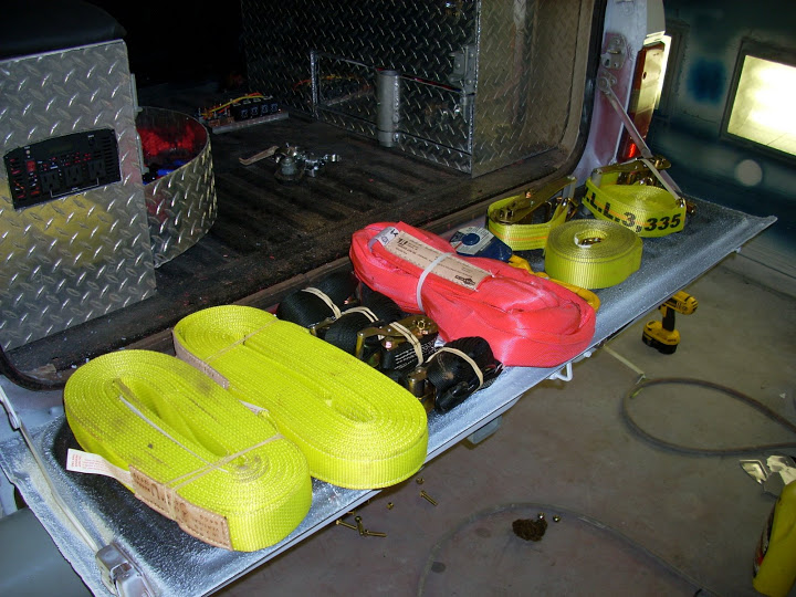

I would also like to give a "shout-out" to Maytex who is a local oilfield rigging company. They donated about 800 bucks in recovery straps, shackles, ratchet straps, block&tackle, etc
About 97% done folks
