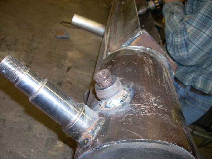

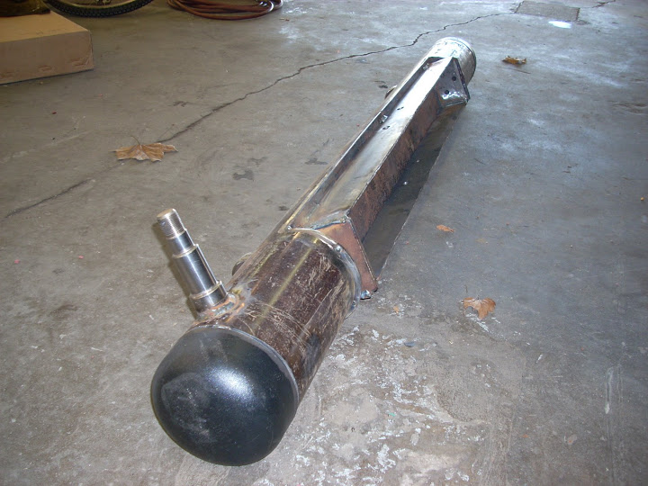

that front bumper is nuts... looks like it could take some incoming fire..
Yeah, it really is. The guys who designed it aren't off-road guys at all which allowed creativity into their design. So many of us that have been doing this for 10 years have a very exact picture of what a front bumper should look like (I blame ARB, Kamar, etc). These guys started from nothing and asked questions like, "How much impact should it withstand?" and "How can we FULLY protect the winch from theft and impact?" After asking themselves 10 or so questions, this is what they came up with.

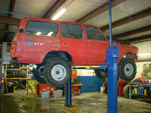

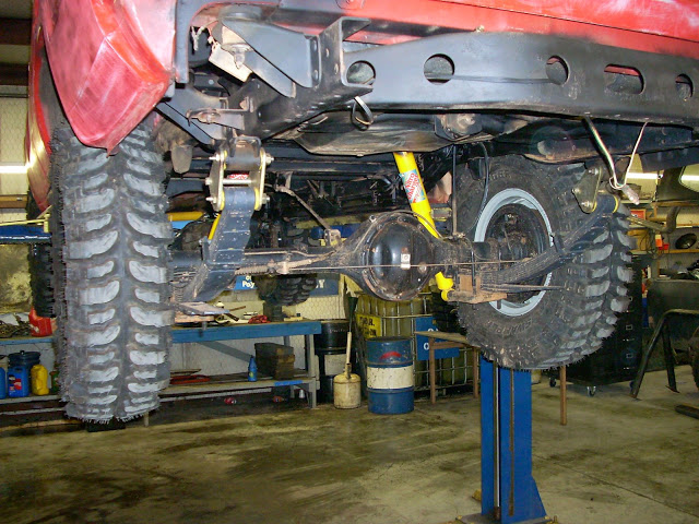

We put the truck on the lift to do the rubberized undercoating
Same thing from different angle

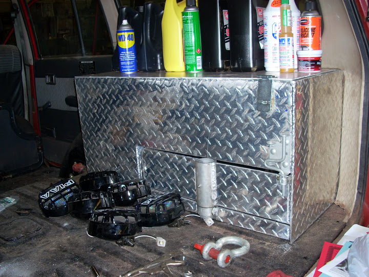

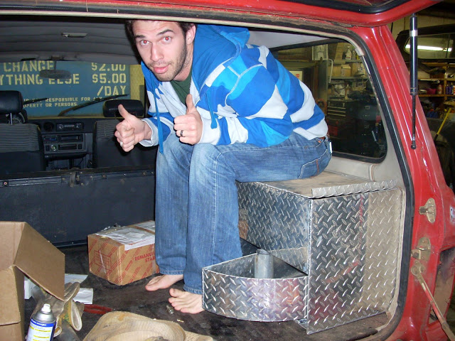

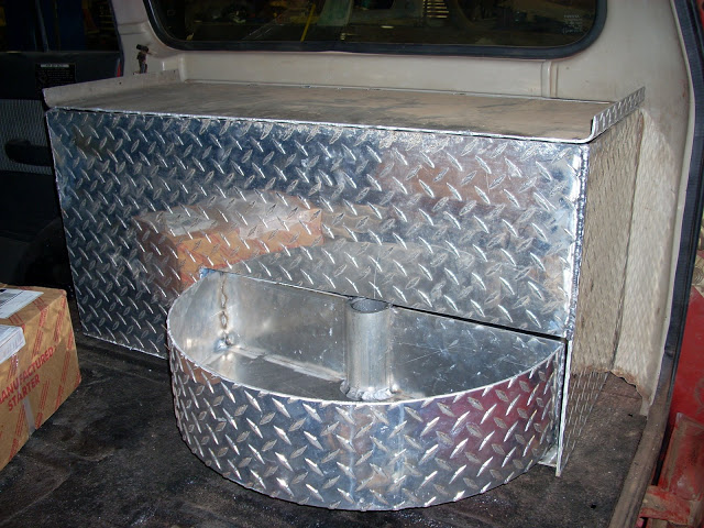

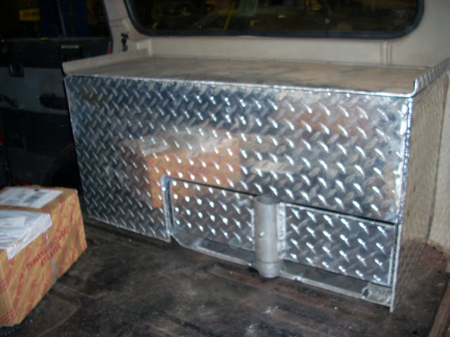

Got the first tool box done; showing that whoever sits on the tool box will have to be a small child. (I'm 6-3)
Tool box complete - it came out almost exactly how I had it built in my head. The other side is about 50% done
With the drawer open

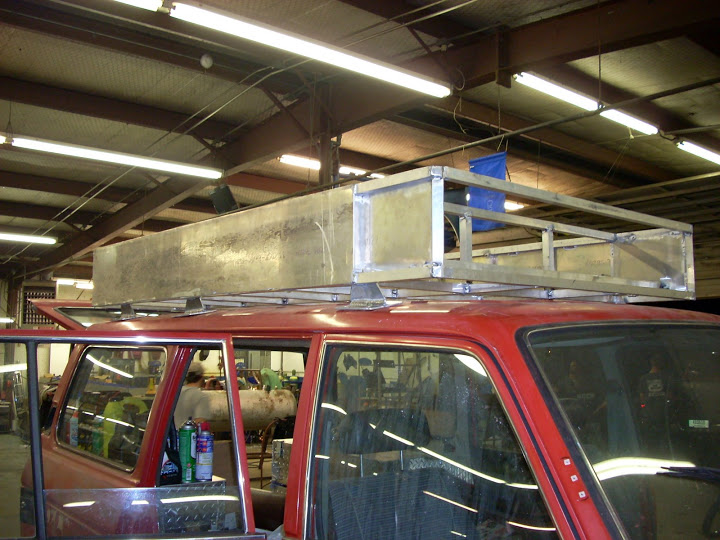

Now thats a roof rack!

Nice built guys, but reverse those rear shackle, they are upside down.
Yeah, I've known they were wrong ways for a while... I didn't catch it until some of the guys were already done installing the kit. Its at the bottom of the priority list right now. Something that will definitely happen before we ship it away though.
Thanks for the heads-up!

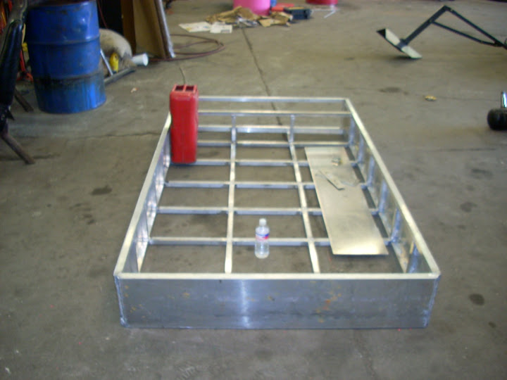

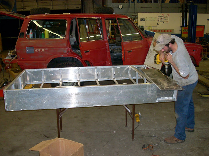

The roof rack is coming along very well. We expect to have everything done and off to powder coat this week. We decided to use .125 6061-T6 on the walls of the rack. .125 perforated will make up the floor

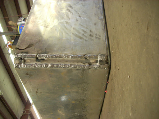

We've been TIG welding all the aluminum on the roof rack.
Bumper with the spindle welded on.

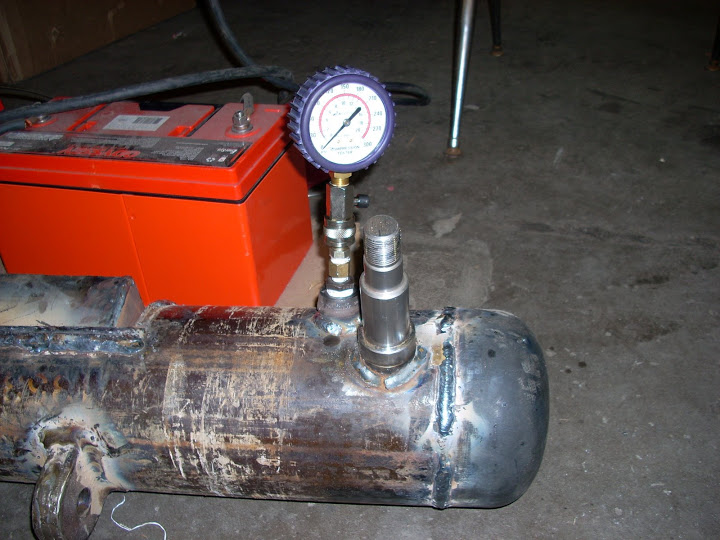

We welded in 1" NPT thread-a-lets to the air fittings.

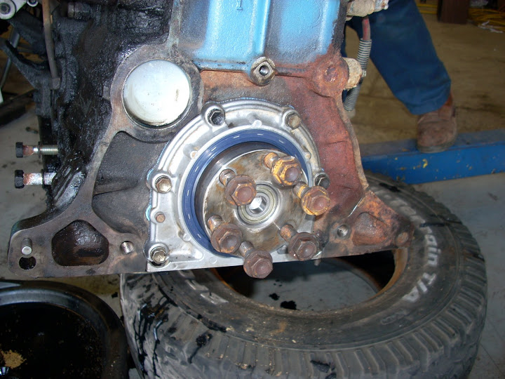

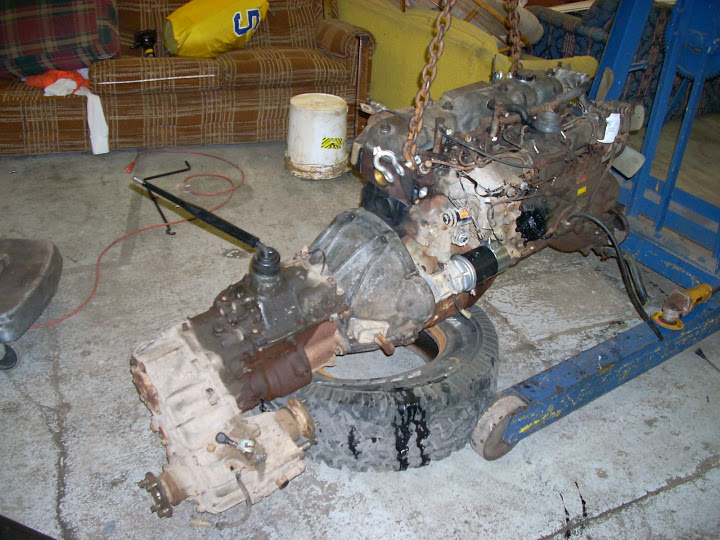

Took the time replace the rear main seal and oil pan gasket.
2H
Resurfaced flywheel
$OR clutch/PP, NSK/KOYO pilot and T/O bearing
Clutch
Drive-train all back together and ready to go in

Pressure testing the rear bumper. We had a couple small leaks as expected
