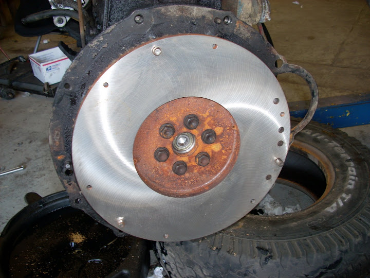

Resurfaced flywheel

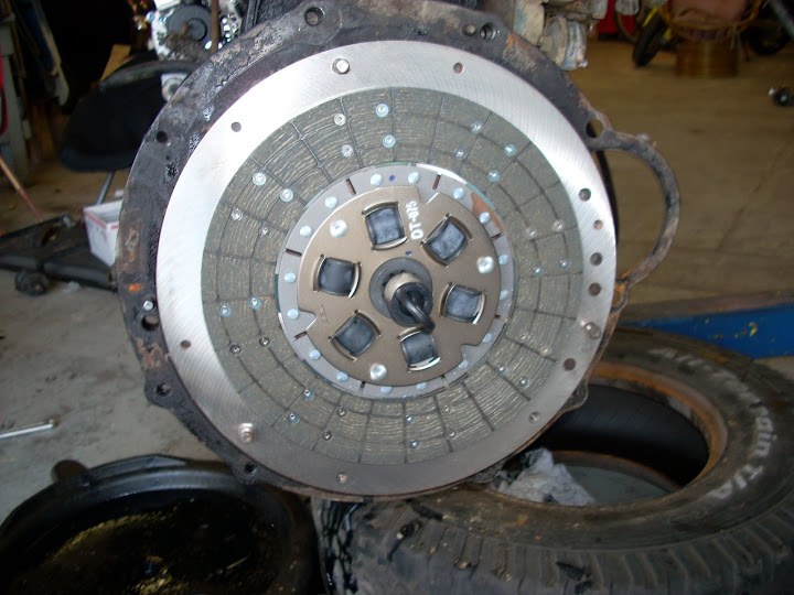

$OR clutch/PP, NSK/KOYO pilot and T/O bearing
Clutch

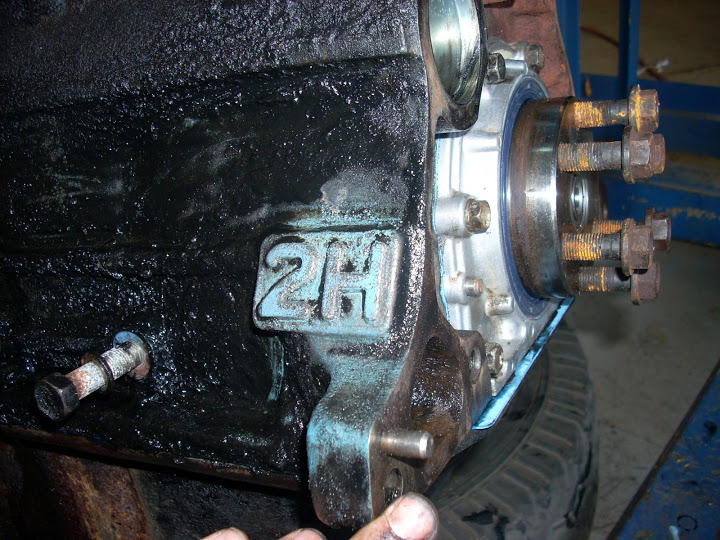

Not sure about the 2H diesel flywheels but the 2F motor flywheels need to be steeped.
