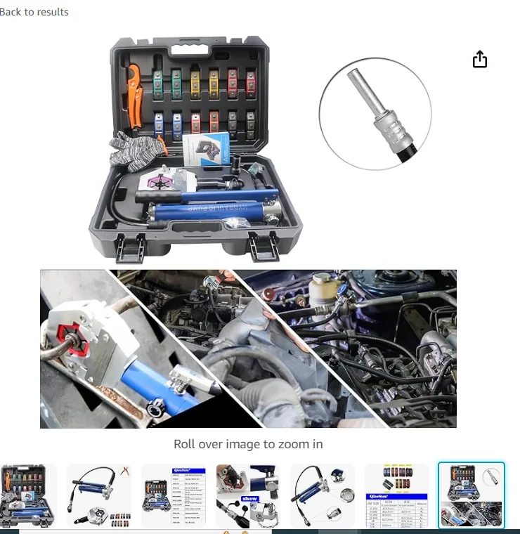

cool, thank you very much for the education. Something like this is what I think you're mentioning. Honestly, I just want the actual crimper but can't seem to find one easily but I'll keep looking. My immediate need is to do some crimping on a high pressure fuel hose on the DD. Since it's a Mercedes car, I'll need to measure the OD of the hose then buy some metric steel/brass crimps.

That's just a dimple crimper for AC lines.
Hydraulic crimp fittings are totally different. You are collapsing the entire steel shell. Magnitude more tonnage required.

ok, thanks for the clarification. The title says hydraulic fitting but it looks just like an A/C hose crimper.
