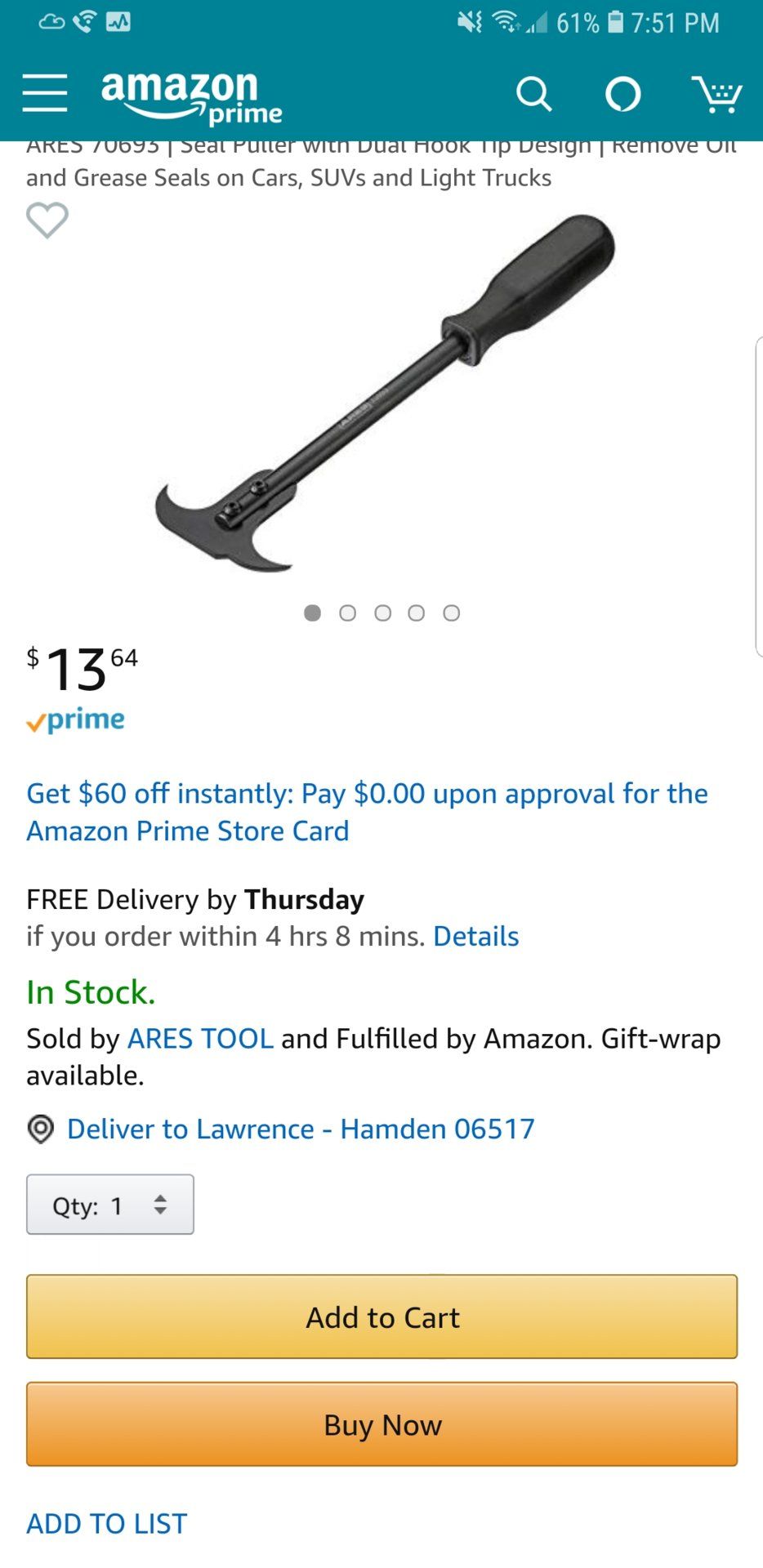

This is what I used. Popped right out

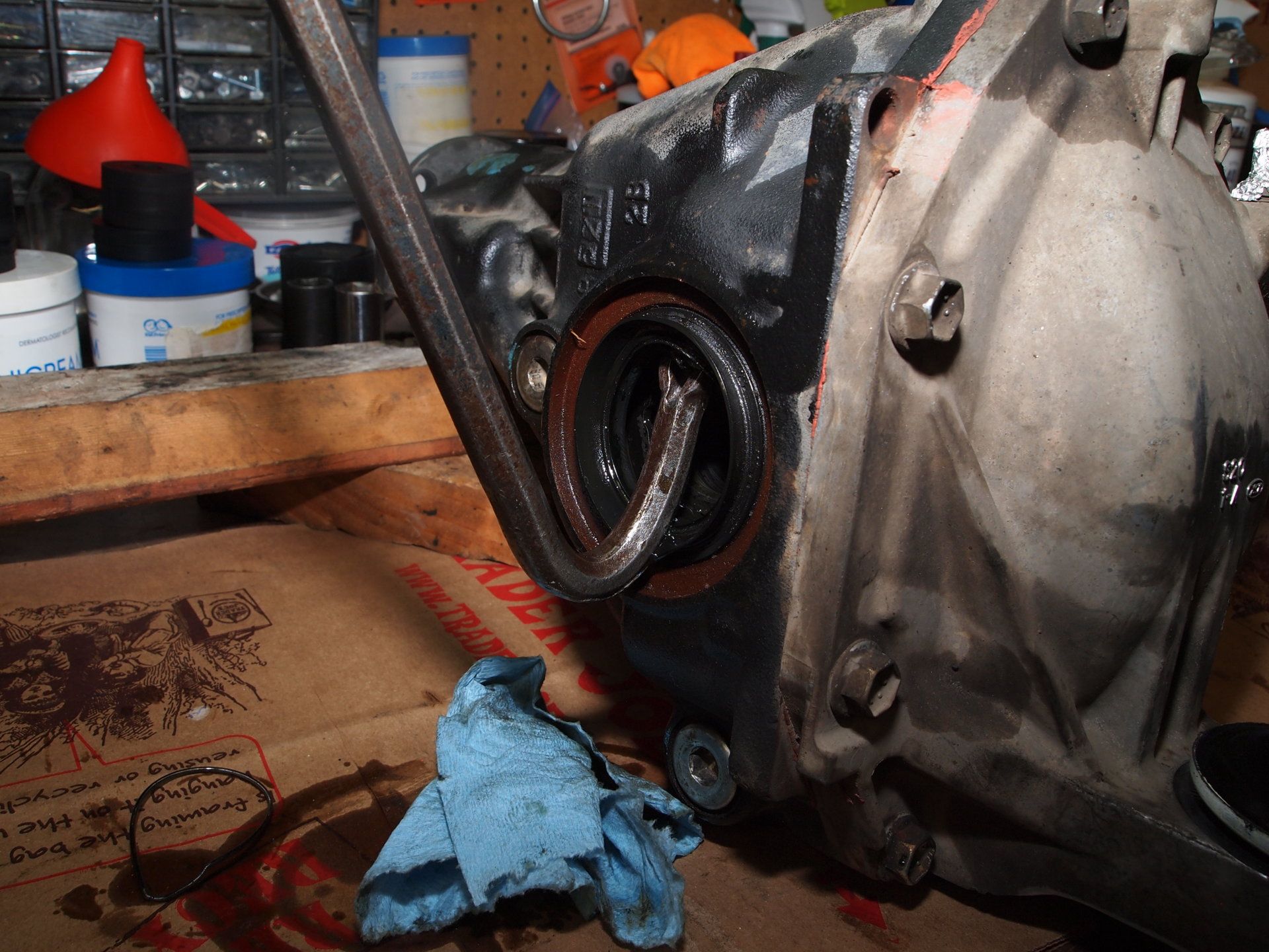

Crow bar work ok for removing the differential seals. Just don't knick seat.

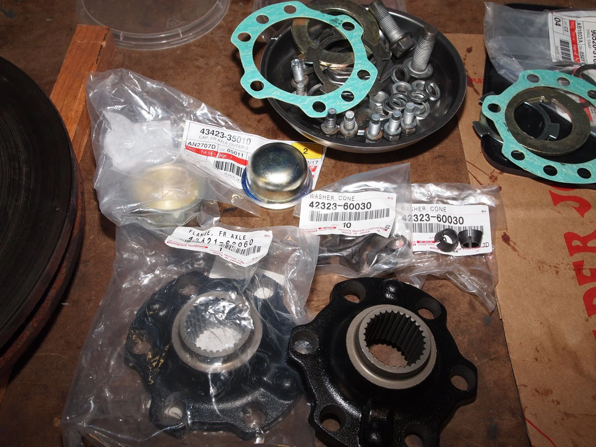

I always replace hub flange, cone washer and hub flange snap ring along with a new OEM front drive shafts (AKA axle).

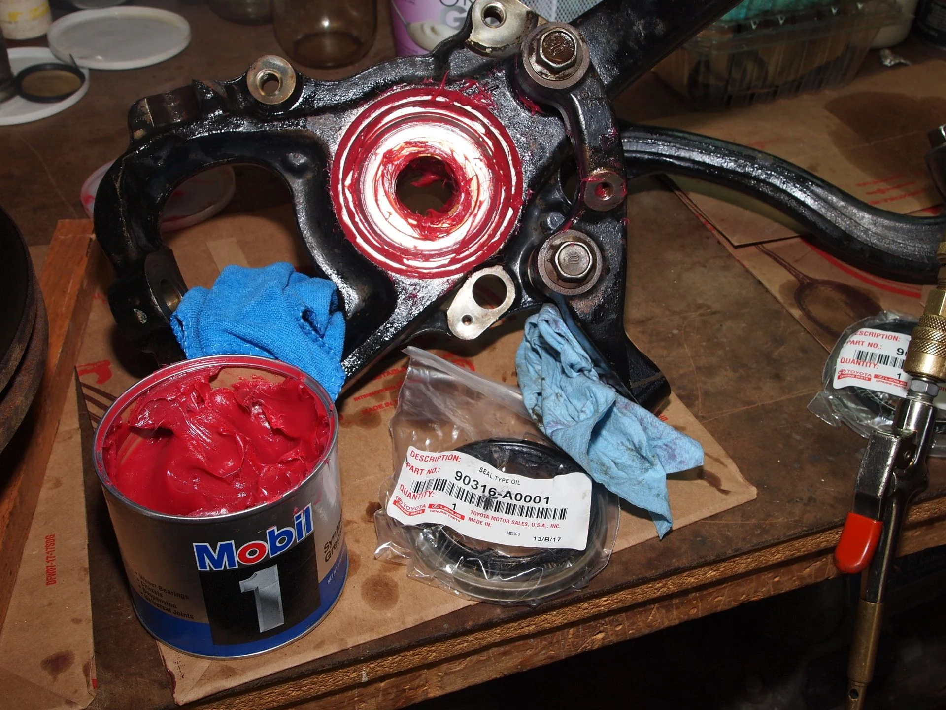

But simple setting a torque of 24ft-lbf is not the way to set wheel bearing on the 100 series. Setting Breakaway Preload (BP) to betweens 9.5 to 15lb on fish scale is the proper procedure.
I finding when bearings have been replaced with new OEM bearings & race, then packed with a good synthetic grease, I'll hit right around 45ft-lbf on adjusting nut to get proper BP. With very good and nicely worn in used bearings. I've hit as high as 72ft-lbf torque on adjusting nut to achieve the minimum BP of 9.5lb. With rough, pitted bearings and scored races I may hit a torque of ~ 10 to 24ft-lbf with a BP of 12lb on fish sacle.
The factory only give us a starting torque of about 5 to 7ft-lb. What they recommend is using a spring scale to set Breakaway Preload, without actually giving a maximum safe torque.
At 24ft-lbf you'll likely get chatter on claw washer. This scores (groves) the claw washer loosening bearings further, creating more chatter.
New hub flange and cone washer is not always needed but nice to reduce D to N to R clunk. With new OEM front drive shaft I always replace these.
