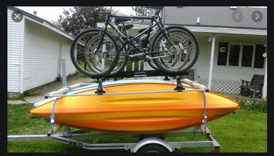

Found this with a google search, links to pintrest so I can't get the full res image. Looks like a rectangular frame with padding front and rear, strapped down to the kayaks and then Thule bars attached to the frame for the bikes.
What about bolting one of those 4 bike trailer hitch carriers to the tongue of the a kayak trailer? Find the trailer with the longest tongue or one where the tongue bolts to the trailer section and replace it with a longer piece of 2x2 tube and the ball hitch.
This is what I was thinking of. Just might have to build one like this.

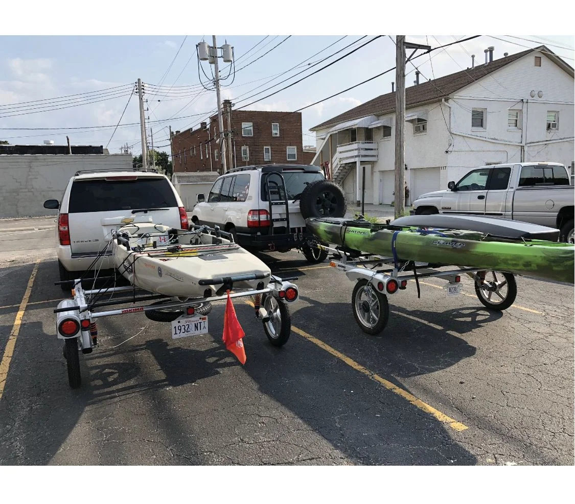

My brother and I have Yakima Rack and Roll trailers. With the upgraded shock, it’s rated for 350 lbs.
Folds up for storage inside, and can be fitted for different load configurations that might meet your need.
but it’s spendy...
Folding is nice but almost $3k....damn

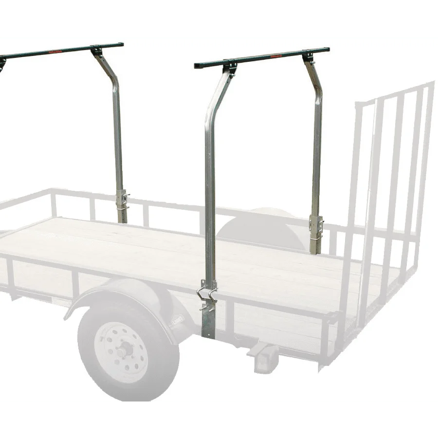

Rent a utility trailer and for $300 put one of these on it...
Put the kayaks on the rack, bikes in the trailer and the gear in the cartop carrier and/or the trailer. It will have a lower profile than blkes or kayaks on the roof. You will need the trailer space to carry kayak paddles , PFD's, etc.
