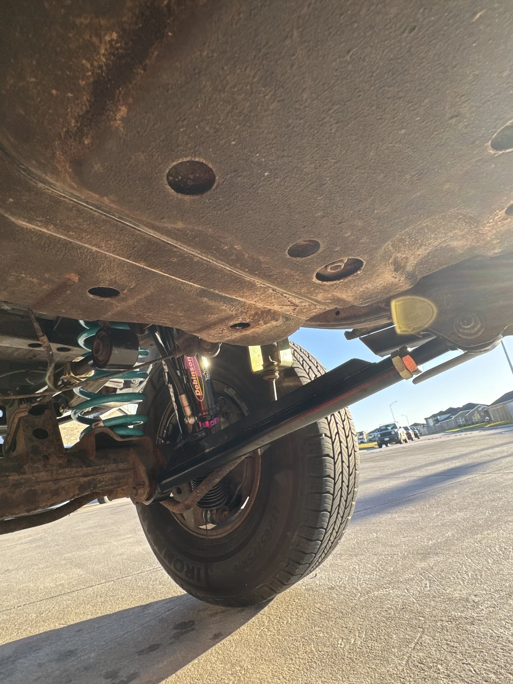

Recently installed a 3.5” dobinsin lift on my truck and was looking for some guidance on the control arm lengths and how to set up the arms to correct the pinion angle. I know the stock length for the LCA is 27.5” but have had a hard time finding any info for the UCA length. ( I do not have the original ones to reference at this time). After some research I was able to find out that the UCAs can stay the stock length and the adjustment would come from the LCAs however like I mentioned I don’t have the UCAs handy in order to get the adjustable ones to stock length.
Not sure it matters as you have full adjustability. Use the lowers to set your axel pivot location so the wheel is centered in the arch, or so that the tire doesn't scrub at full stuff. Then set the pinion angle with the uppers. The pinion angle should be parallel to 1/2* low compared to the transfer case output (with stock shaft) at your most commonly loaded ride height.

You can use math/geometry to set the new length.
I set mine to what seemed right then took it to an alignment shop to dial it in. Any side-to-side variance will tweak the rear alignment.

These arms pictured above look like they are way to short. More threads in the tube, the better.
