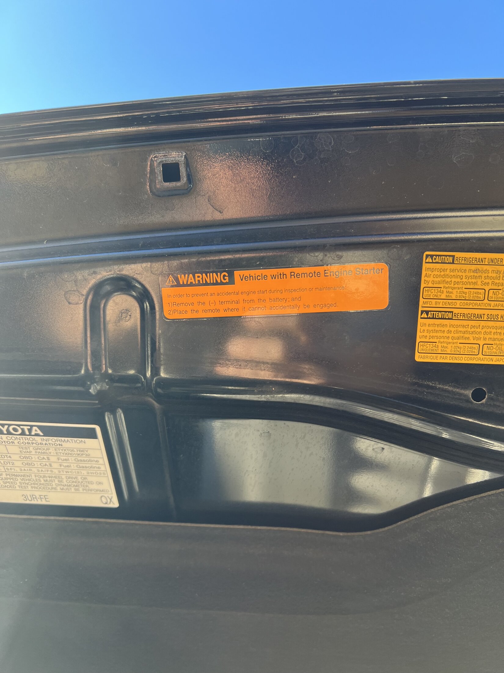

are you sure you don't already have the remote start? check under the hood there should be a sticker there.
Have been running the 12 volt solutions one in both our 200s for 5 plus years now without any issues. Plug and play.
Yeah I have tried the factory setting. Nothing. I haven't looked for the stick. Any idea where the sticker lives?
open the hood and look on the surface of the underneath side of the hood. my recollection is that it's a warning sticker stating vehicle is equipped with a remote start.

this:

It may sound silly but look at the manuals. When I bought my new to me LC I found the remote start booklet with the other manuals. The dealer had no idea. That is how I found out mine had a remote start.
It works reasonably well. Three clicks and hold.

agree. honestly i've never taken the time to track down where the actual device is located but i got the manual as well. i'll have to pull that out and see who the manufacturer is if not toyota.
