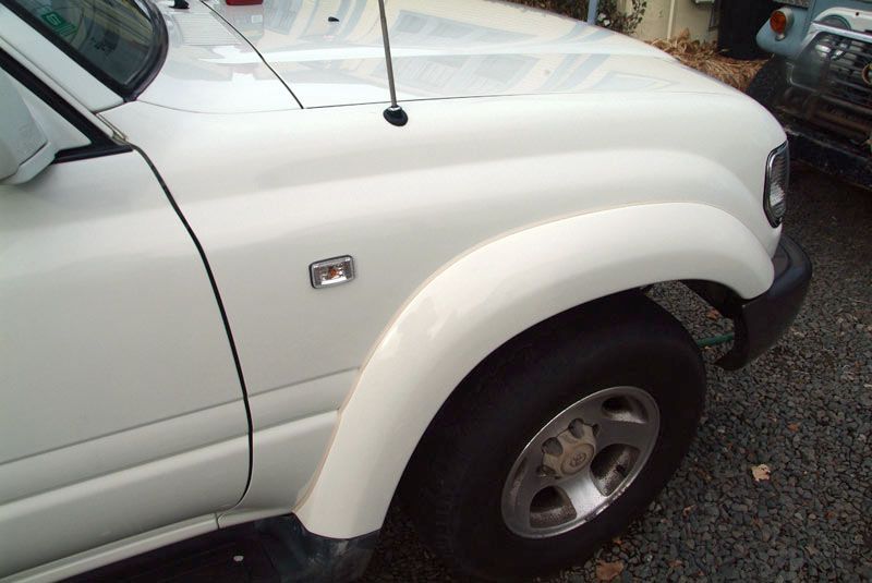

Checked it out on my way back from walking the kids to school.
They do only come on when you turn on the blinkers and they remain un-lit until then.
Again, personally that's the way I would have it for the maximum chance of it catching people's attention when turning/changing lanen (IMO).
Also, I got to have both sides/lenses to "click" back in their place after a couple of tries. :hillbilly:
When removing the lense, be sure to push it in the direction of the larger tab AND THEN pull it out, perpendicular to the sheet metal (Hope that makes sense). If you do that you should be able to avoid getting a nasty gash on your fender like someone did. :rolleyes:

I ended up putting 1157 LED bulbs (3 watt) in the front marker lights. They are plenty bright and can be seen easily from the sides.

After years of wanting to do this, and six months of having the markers on the shelf, I finally dove in and installed. These definitely remove the inherent blind spot for those around us when signalling.
Used the Safari snorkel template to double-check the location. Drilled, step-drilled, then cut with a Dremel.

Filed to fit, then primed and painted.

Blinky!

Blinky!

The wiring is easy enough to run through the fender. If you reach inside there are access holes that help to feed the wiring through. The last pic is where I tied all the wiring together. Two leads from the new side markers and a jumper from the front turn to the side turns. I will probably swap out the dual filament plug with an OE brake/running light plug later. These were from a GM and they fit but not great. All the signals flash and the running lights work on the side turn signals.
