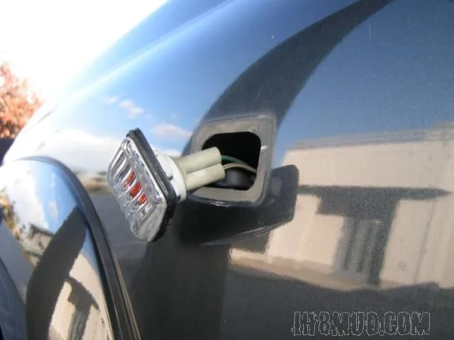

The other day I discovered the FZJ80 had a blind spot...enough of that. I ordered the crystal side markers and turn signals from mot. I also read up on why Toyota decided not to make the side turn signals blink. Christo recommended just adding an dual filament plug to the side markers so that is what I did.

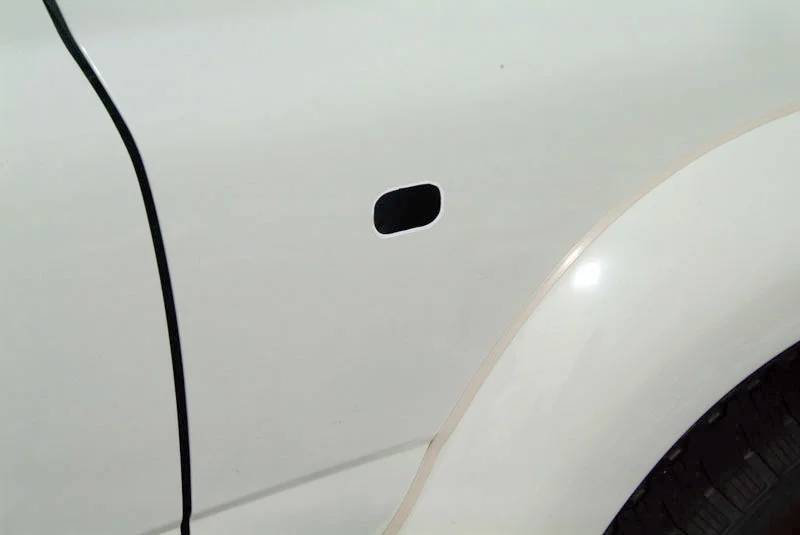

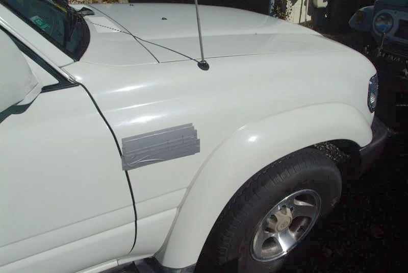

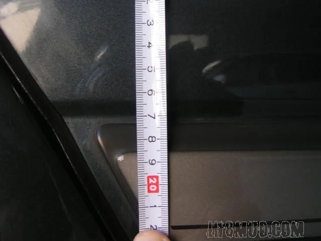

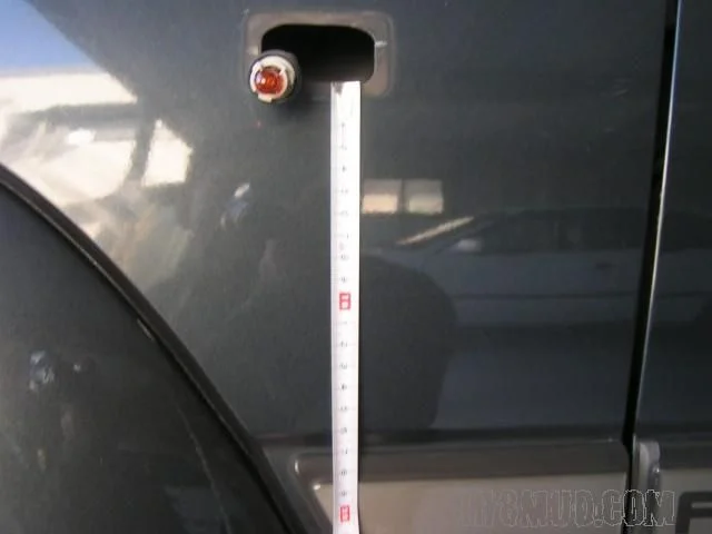

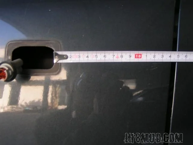

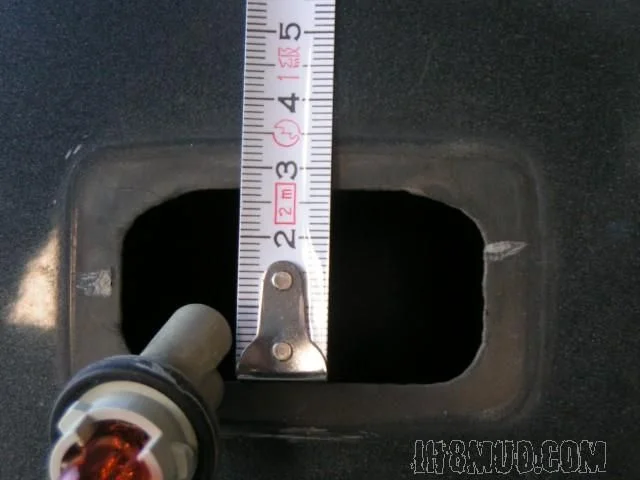

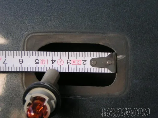

Using mot's measurements I taped off where to cut. The duct tape is just there to protect the metal if I slipped with the cutoff wheel. To align it with the truck I measured up 17cm on the door as well as the fender and drew the line from there.

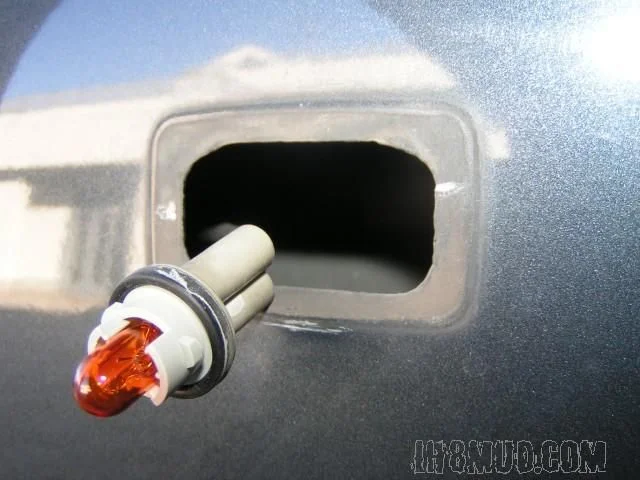

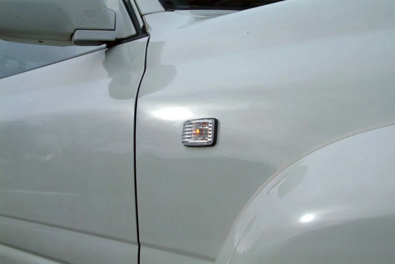

I put a dual filament 1157 bulb in the side marker housing. It is a running/marker light and a turn signal that can be seen from the side.

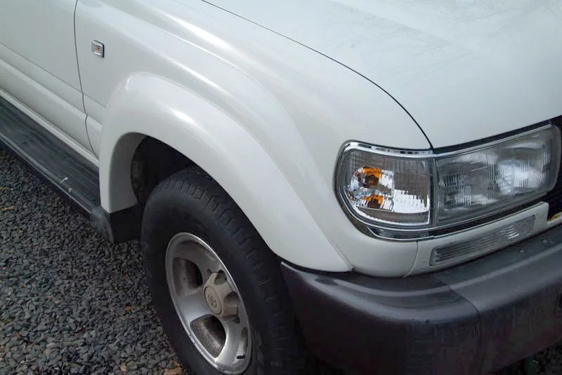

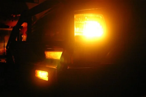

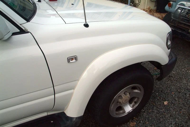

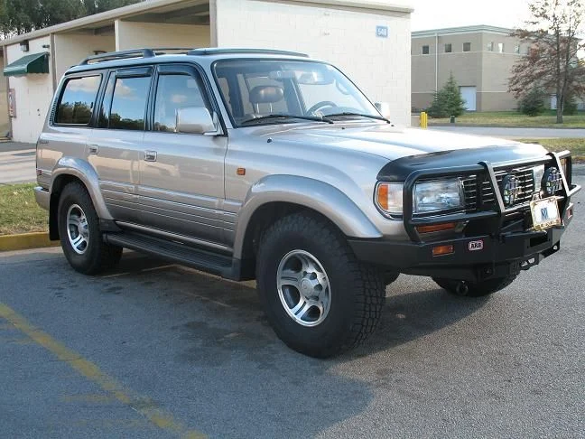

Pic 1: Crystal clear side and turn signal with the ARB bumper

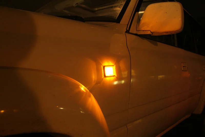

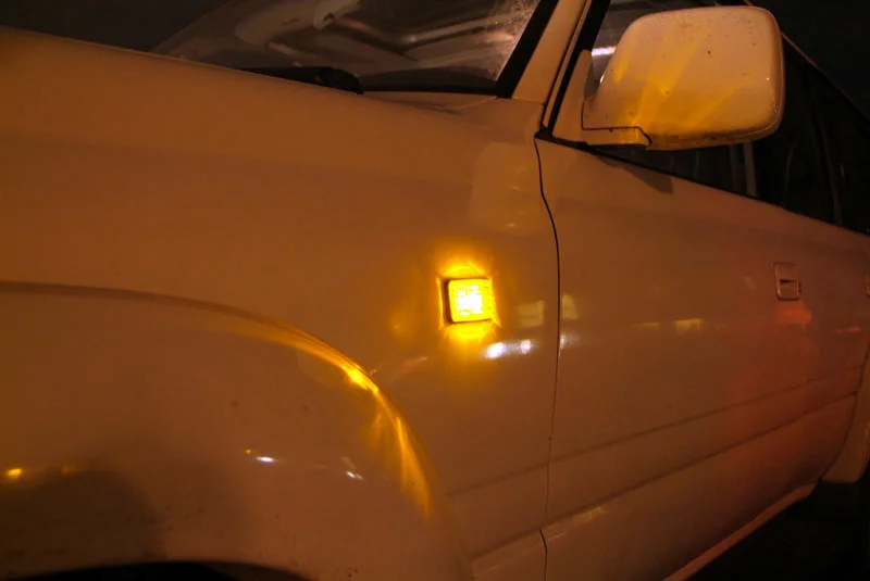

Pic 2: Night view of the turn signal - all three light - side light, turn signal, and ARB turn signal lights up with turn indicator.
Pic 3: Night view from the driver's seat. Parking light

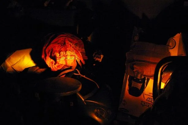

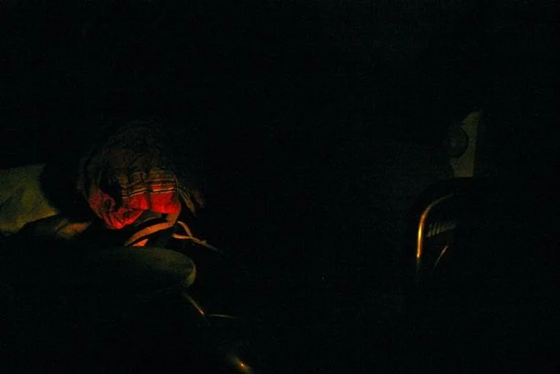

Pic 4: Night view from the driver's seat. Turn signal light

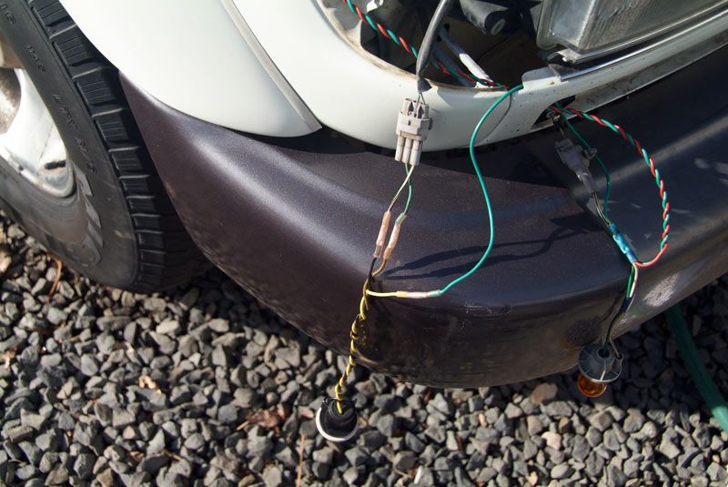

The wiring is easy enough to run through the fender. If you reach inside there are access holes that help to feed the wiring through. The last pic is where I tied all the wiring together. Two leads from the new side markers and a jumper from the front turn to the side turns. I will probably swap out the dual filament plug with an OE brake/running light plug later. These were from a GM and they fit but not great. All the signals flash and the running lights work on the side turn signals.

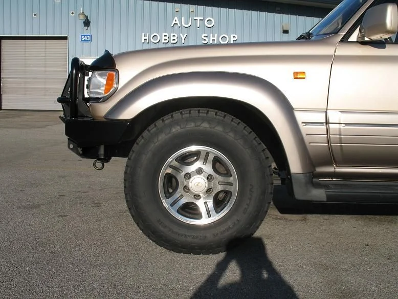

Good job! That was a clean install. Mot gave me those measurements when I was installing my side markers. The 80 really has a blind spot and those side markers are a big help when changing lanes.

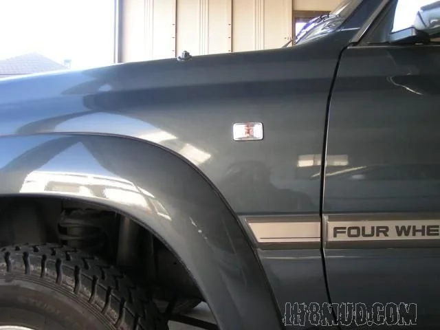

I just installed my OEM side markers (thanks Mot!!), and for the record the holes had to be slightly larger than Mot's and Treeroot's (approximately 1mm higher and 2-3mm longer). Perhaps different manufacturing runs of the lights use different parts? The adjustment was pretty easy, so no harm/no foul.
My question is this - I installed the lights, and they are holding, but I expected a "click" when they were flush with the body. But if I put too much force on the sheet metal, it (temporarily) dents inward. Is there a trick to keeping it in its present shape while pushing on the lenses? I can't reach the lens from inside the fender, so that's not an option.
I even tried keeping the tab bent inward (using a long screwdriver), but it didn't "click" and I don't think there's any real force on the rubber gasket.
I'm concerned that the fixtures are going to pop out under any kind of abuse.

I just got my markers from Mot last week so I can't be of any real help until I install mine but I would have guessed they would be a little tighter fitting. However I suppose this is a trade off with getting them off if you need to change the bulb as you can't get to them from the fender side.

I've never had the OEM/amber markers, but when I removed my crystal clear lense for the pictures posted above (and put it back in) it didn't exactly "click", either. I was a bit troubled then as well, but I grabbed it and wiggled it in all directions, but it did not come loose, so I just never worried about it. And of course, I've never had any issues with it/them coming off.
I'll try to see if I can try it with the amber/OME ones today and see if there's a click.

When removing you either push the lense assy on one direction (can't remember if it matters which direction or how the tabs are designed, but to the direction (if it matters) so that the other tab woulld clear the opening of the hole to allow you to pull the lense off/out, OR use a butter knife and do something similar with the tab(s) so you can pull it out.
