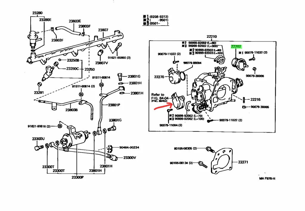

I'm experiencing the same thing which has been occurring for the last month or so. My first question is, what is a TPS, and secondly, have you made any progress on this for any updates? As I was reading your description, I was like....damn, couldn't have described my own issue better.
Throttle Position Sensor. If you have a 93-97 FZJ80 it should be Toyota part number 89452-22090

Hey @BILT4ME,
Thanks for pointing that out. I have the FSM here and after checking all the info, there is nothing mentioning the position/angle that the TPS should be installed. Is it ok if it's installed on the same position as the current one installed or are there any recommendations regarding how to match the flaps inside the TPS with the other side?
