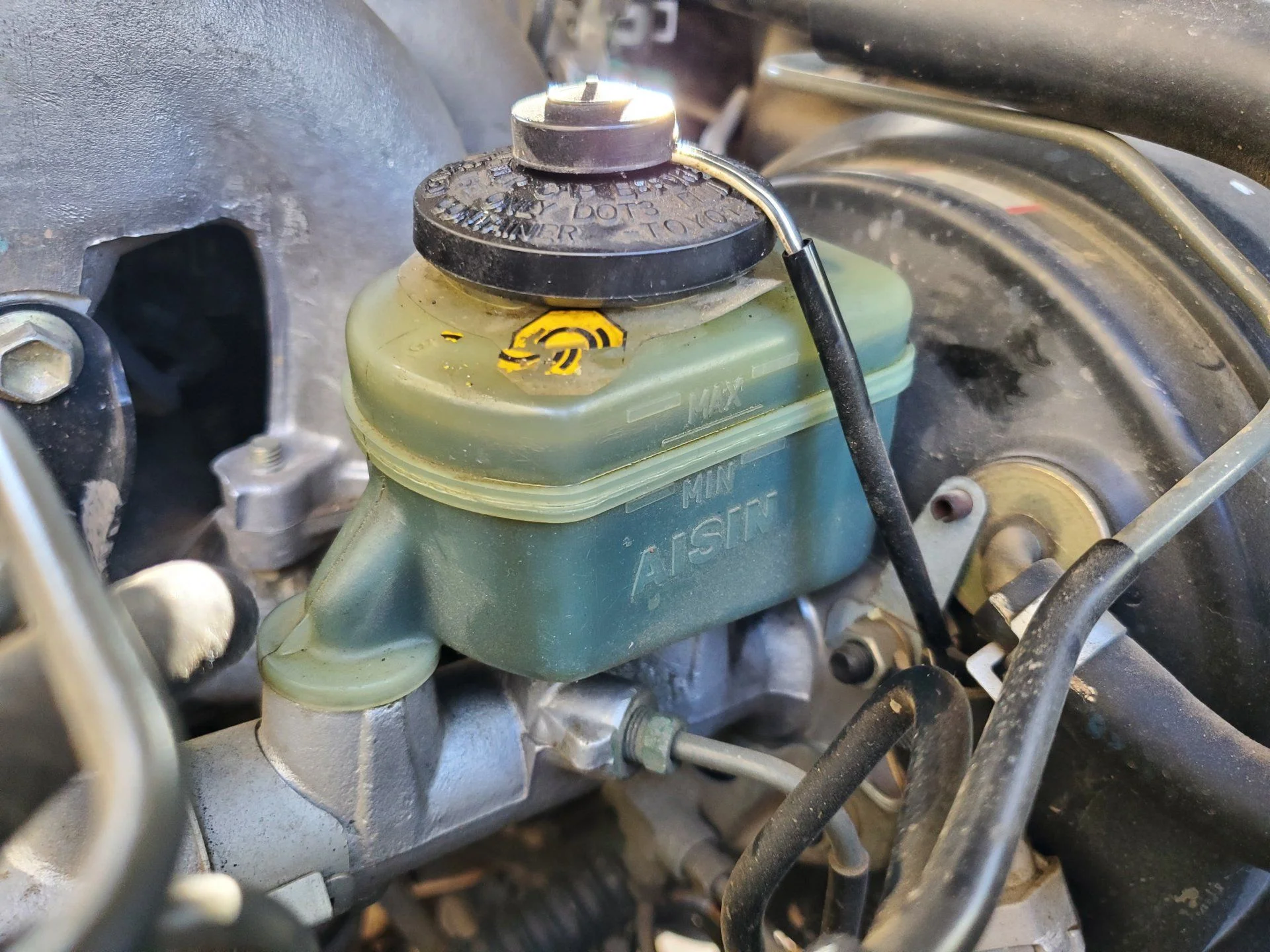

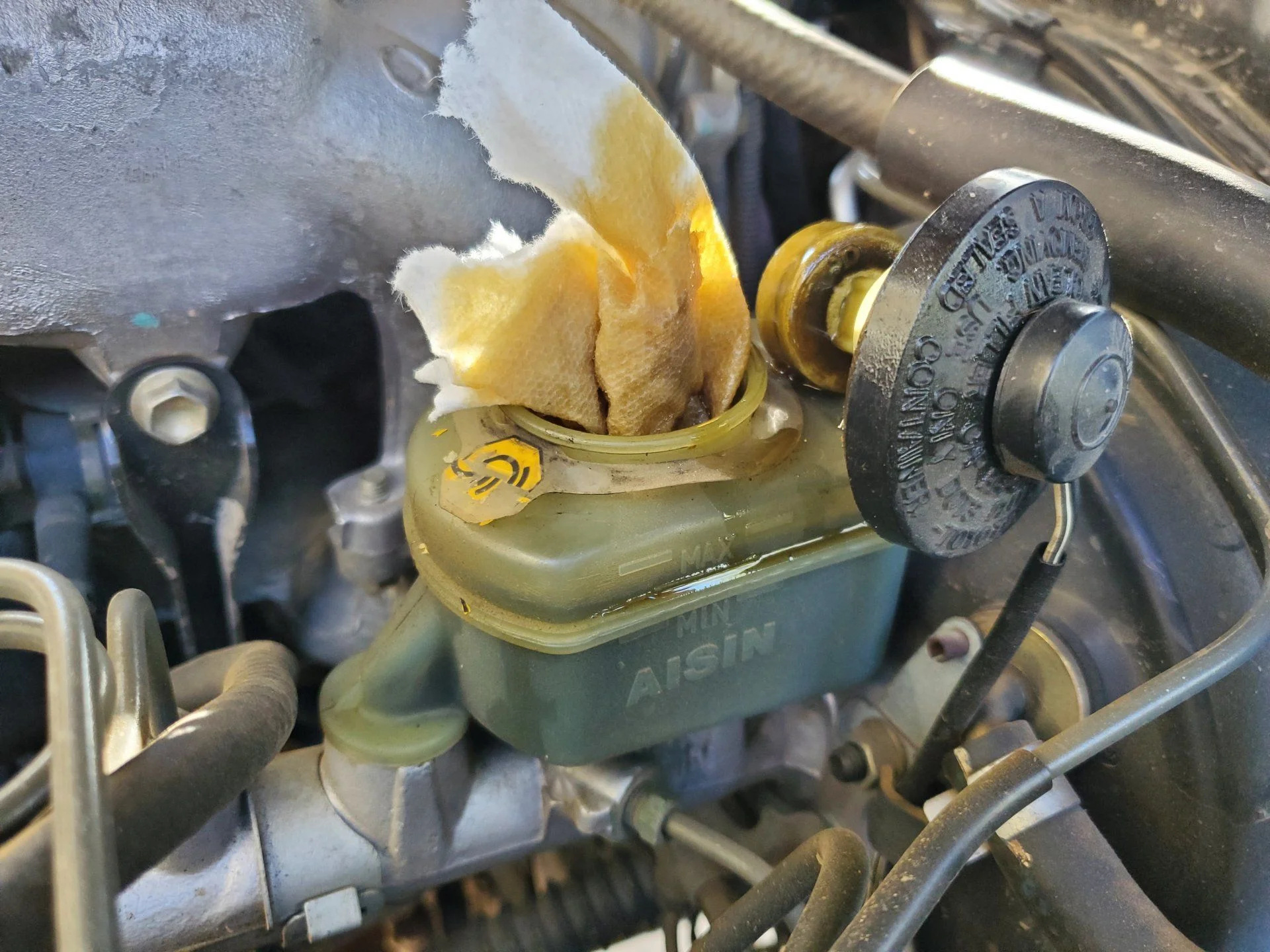

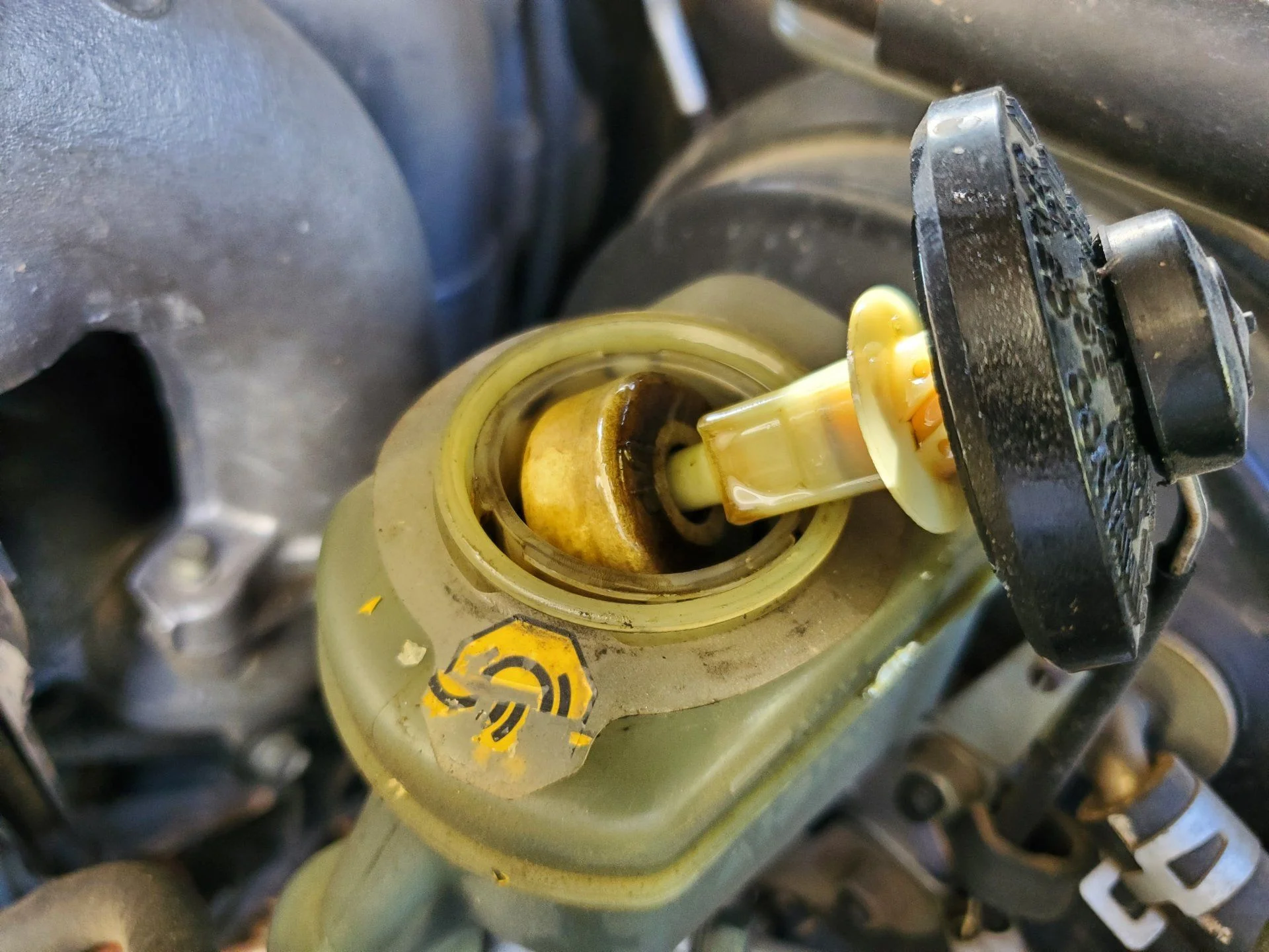

Edit: A few photos of the brake fluid level before and after extracting a little. Am I due for a flush?
