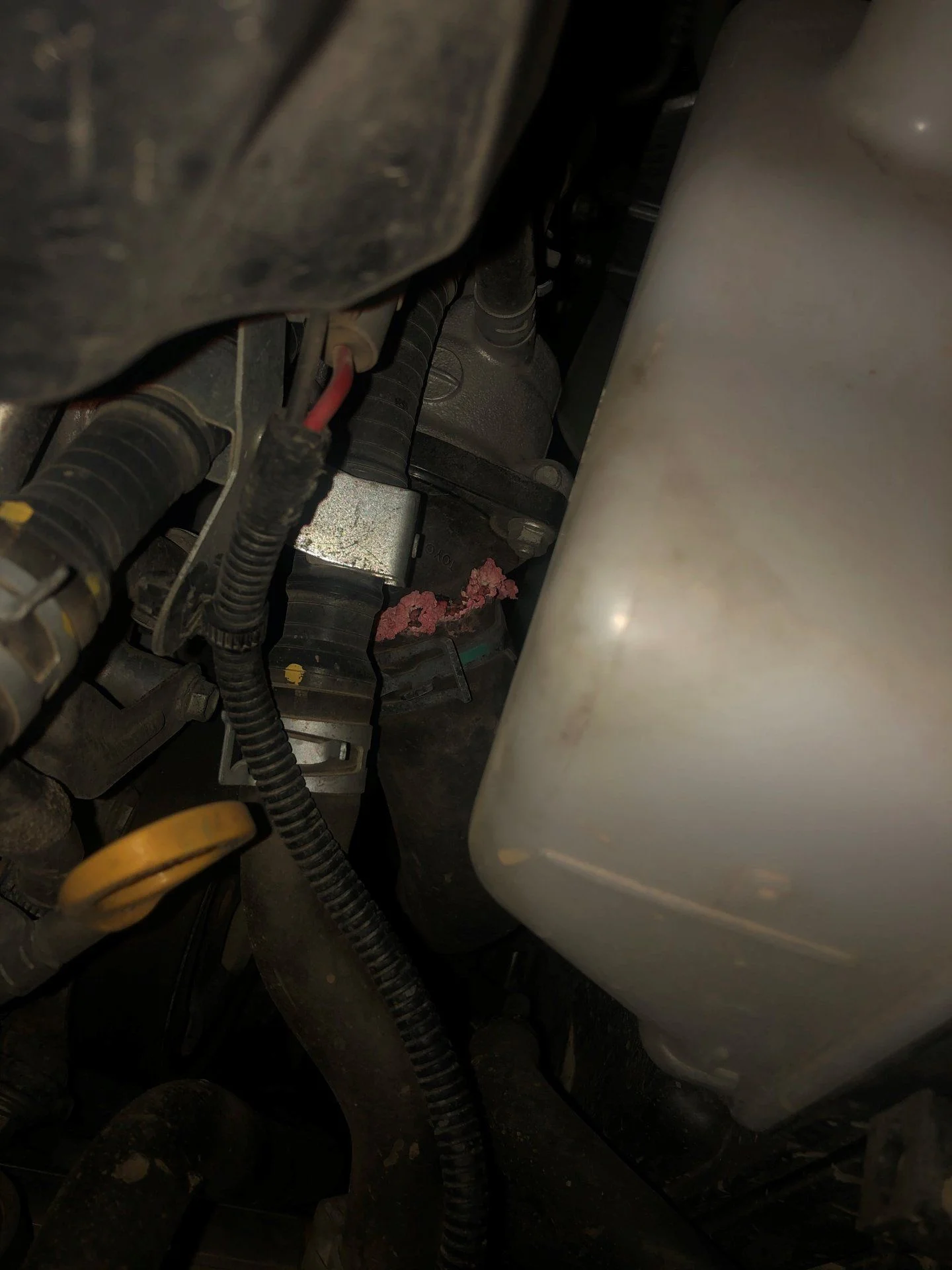

I do have a leak at the hose connection though:
I was not thinking I need to worry about the radiator because I have a 2013. For some reason, I thought the "radiator issue" was for pre-2013 and my radiator doesn't have the markings on the flat spot so I thought I had the "new" one. In reading through the "radiator issue" threads, I think I am wrong about this. Still, I don't see any evidence of any crack developing. How can you tell for sure what radiator you have? There is a number on the far side that is PA66-GF35. I googled that it I get Toyota radiator hits but I still can't tell which one I have.
That is the old radiator. The new one has a different shape on the raised spot on top. Yours looks good but keep an eye on it!
That doesn't appear to be an OEM radiator for a landcruiser/LX, though I have no idea why it wouldn't be original if you got it at 40k. Did it have any accident history? You could try looking on the top and bottom tanks for a logo.. or maybe spend some time on rockauto looking through the (small) photos of the broad range they have there to see if you can identify it. If it's not OEM it likely won't have the same crack issue, but then the overall quality could be less too. Hard to say. When you pull your upper hose off, if the outlet isn't dark black like the rest of it, possibly a brown or more mottled tan, it is seeing some age. Same story when you look inside the filler neck.
I disagree on your "hoses look OK" assessment. That lower hose is old, and needs to be replaced. Almost certainly why that leak is present. Consider changing that plastic lower neck too. And if your top hose is original, do it as well. I'd keep the stock spring clamps. They do a very good job even if they are a bit more annoying to operate than screw clamps.

Thanks. I agree about the hoses when I really started looking at it. I need to check the radiator as it is possible it was replaced as part of the front end repair when I hit a deer (pre TJM) though I didn't think they did replace the radiator at that time.
