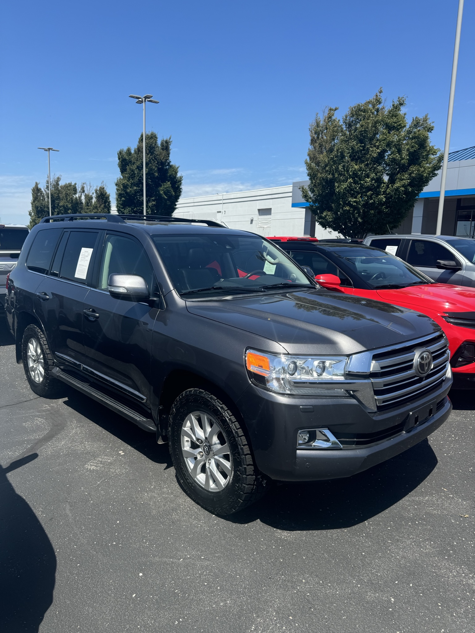

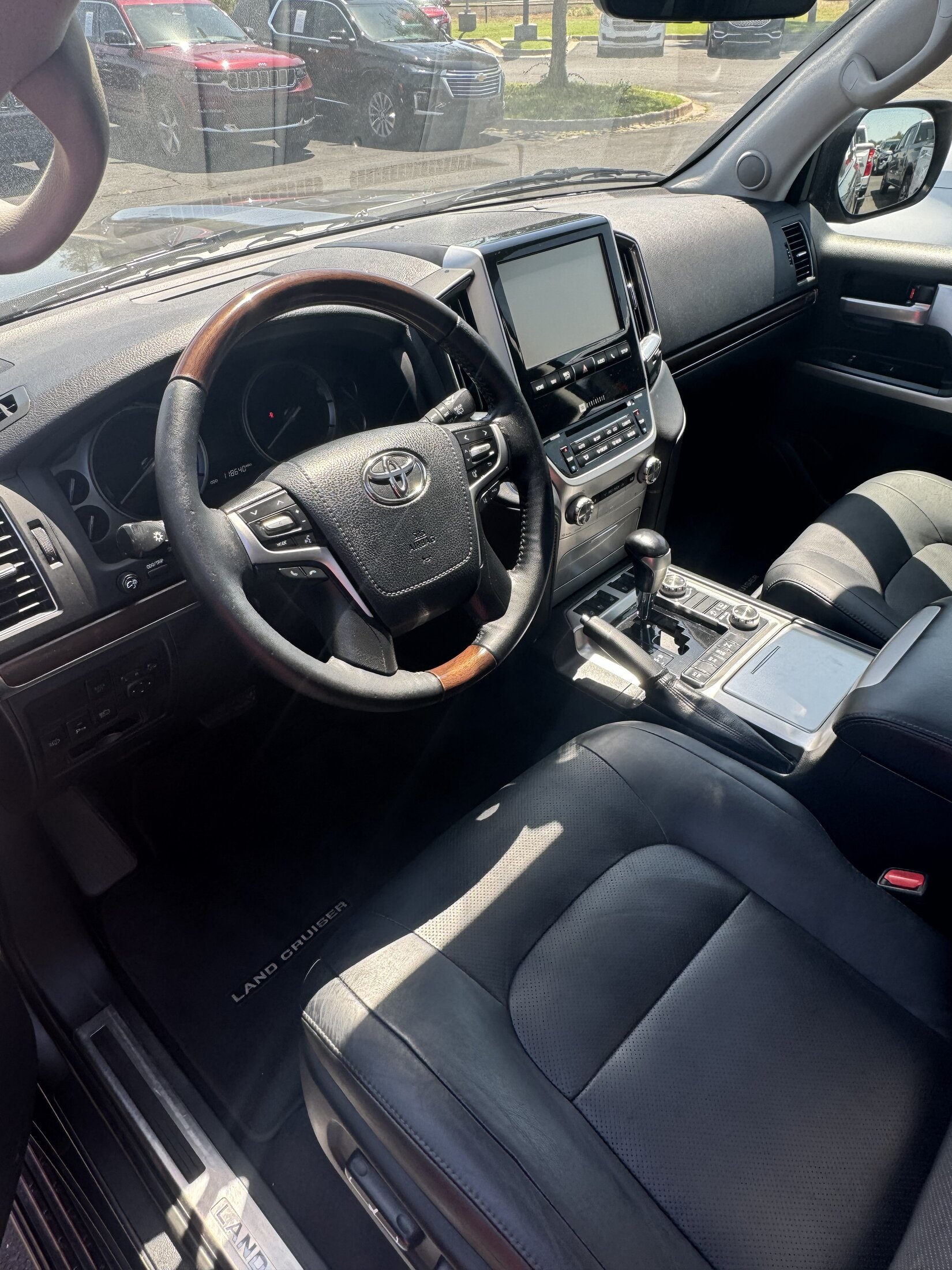

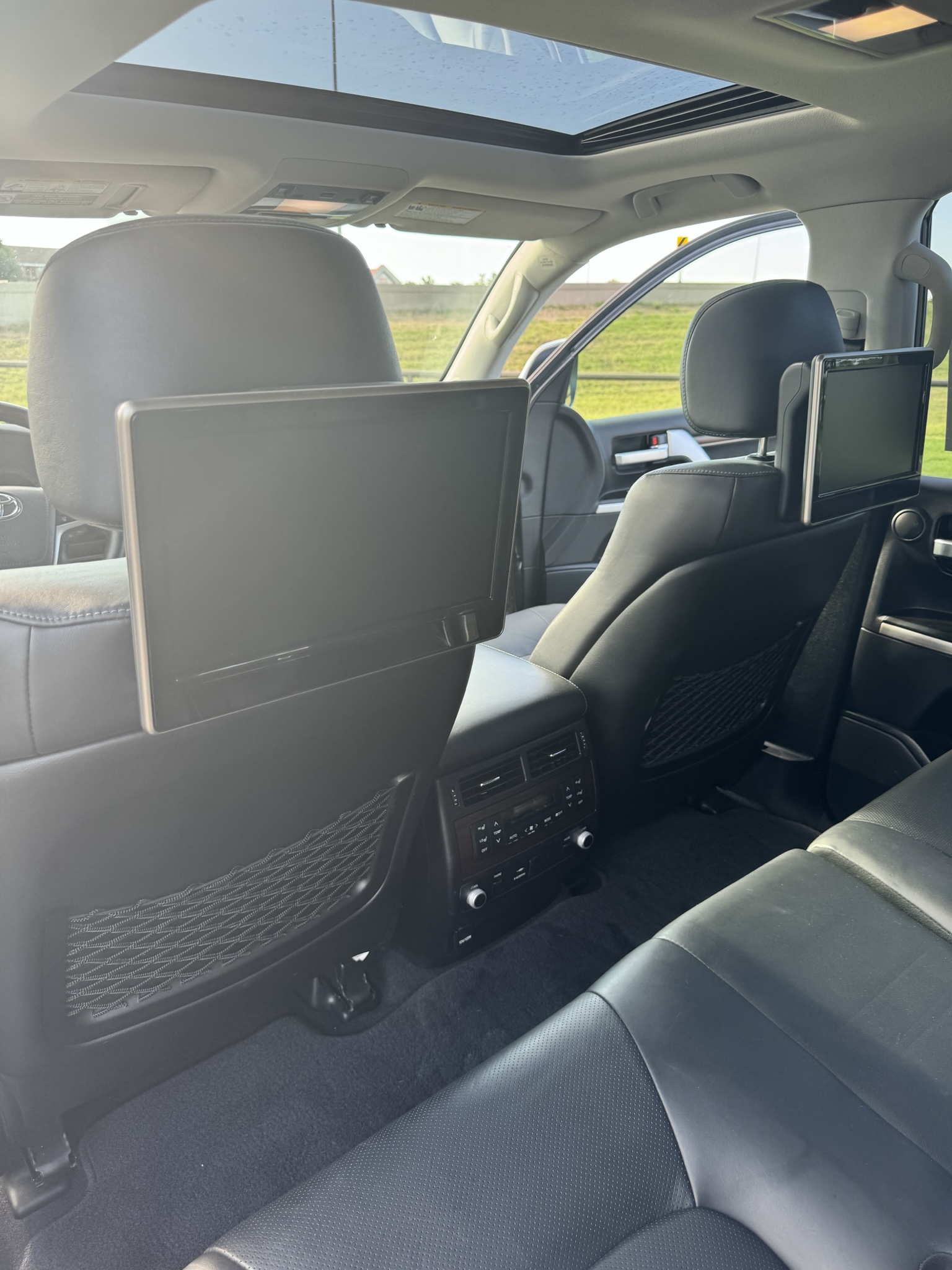

Well, as luck would have it that LX got sole before I could move on it. Which allowed me to enter the actual Land Cruiser club last night.
2016, 118k miles, in fantastic condition. Got to drive it 2.5 hrs home last night, so I got good and comfortable with it. One thing that annoyed me about the GX was the climate interface. The controls are essentially the same but the firmware is slightly different and it’s easier to use imho. And man is this a/c cold. It was over 100 yesterday, and I almost couldn’t make it warm enough in the cabin! I’ve never turned my ventilated seats off before…. I need to figure out this rear entertainment system. Came with 4 sets of headphones still in the bags. And I haven’t even mentioned the power upgrade over the GX. 😎
I told my wife if I ever don’t want this car, she should just shoot me.
