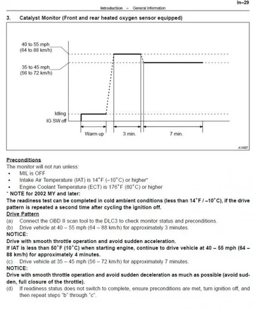

I said 20 miles, we'd usually try a 10-mile freeway run, then recheck. You have to get up to freeway speed for several minutes to get the EGR to run. As a matter of fact, I just found something on that, specifically for your Cruiser.
You'll want to do it after the engine has cooled off.
The catalyst self-test is actually easier, once you get both of those done, everything except Evap. should be good to go.
For the catalyst, it does have to be warmed up, so you'll do this after the EGR run.

I was wrong on the max number of incompletes, it is 2 as per this doc.

man, I can't quite figure out how to drive the pattern described above. No way I can get from my house directly to 50 mph for 3 mins with the engine cold. And then this 40 mph for 7 mins? How do you do this? Either I'm in town and I got to stop all the time or I'm on the freeway and I can't quite go 40 mph...
sheesh....
will these monitor not reset until the specific patterns above have been fulfilled or is "regular driving" for a while sufficient? I always thought one just needed to drive a couple of times at normal speeds and that was it....
They may have already completed just with normal driving. I just replaced an EGR Vacuum Switching Valve on a 2001 Camry, and it only took about 8 miles at 65 MPH for the EGR Monitor to complete. The EGR pattern above is specific to the 1FZ-FE, so it may be more difficult than others.
