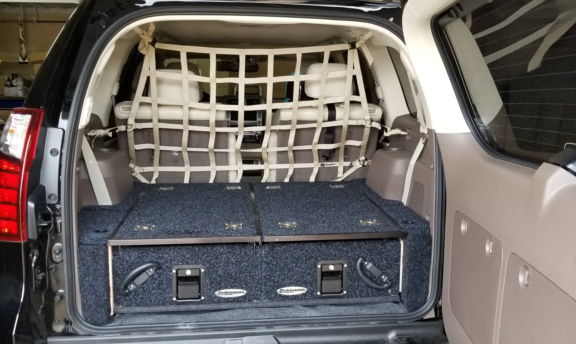

Both ARB and Dobinsons sell Prado 150 drawer sets here in the U.S. I put a Dobinsons set in my wife's GX 460 and have been very happy with it - very good quality and easy to use. The setup has a fridge slide on the left side only. ARBs are a little more expensive but I believe you can choose to have a sliding top for either or both sides, whereas the Dobinsons come in one configuration. If you are interested contact Kyle Fogle at Treaty Oak Offroad and he will set you up. And I am happy to provide more install photos and info if anyone is interested. As to the comment above about height, I am pretty sure all options (Front Runner, Dobinsons and ARB) have drawers that are higher than the 460s middle seats when flat; that is one reason why I built my own drawers in my personal rig. I will say that the trim kit gave me a little grief during the install, but I can provide some tips to anyone who is trying to install it and I am happy with the result.

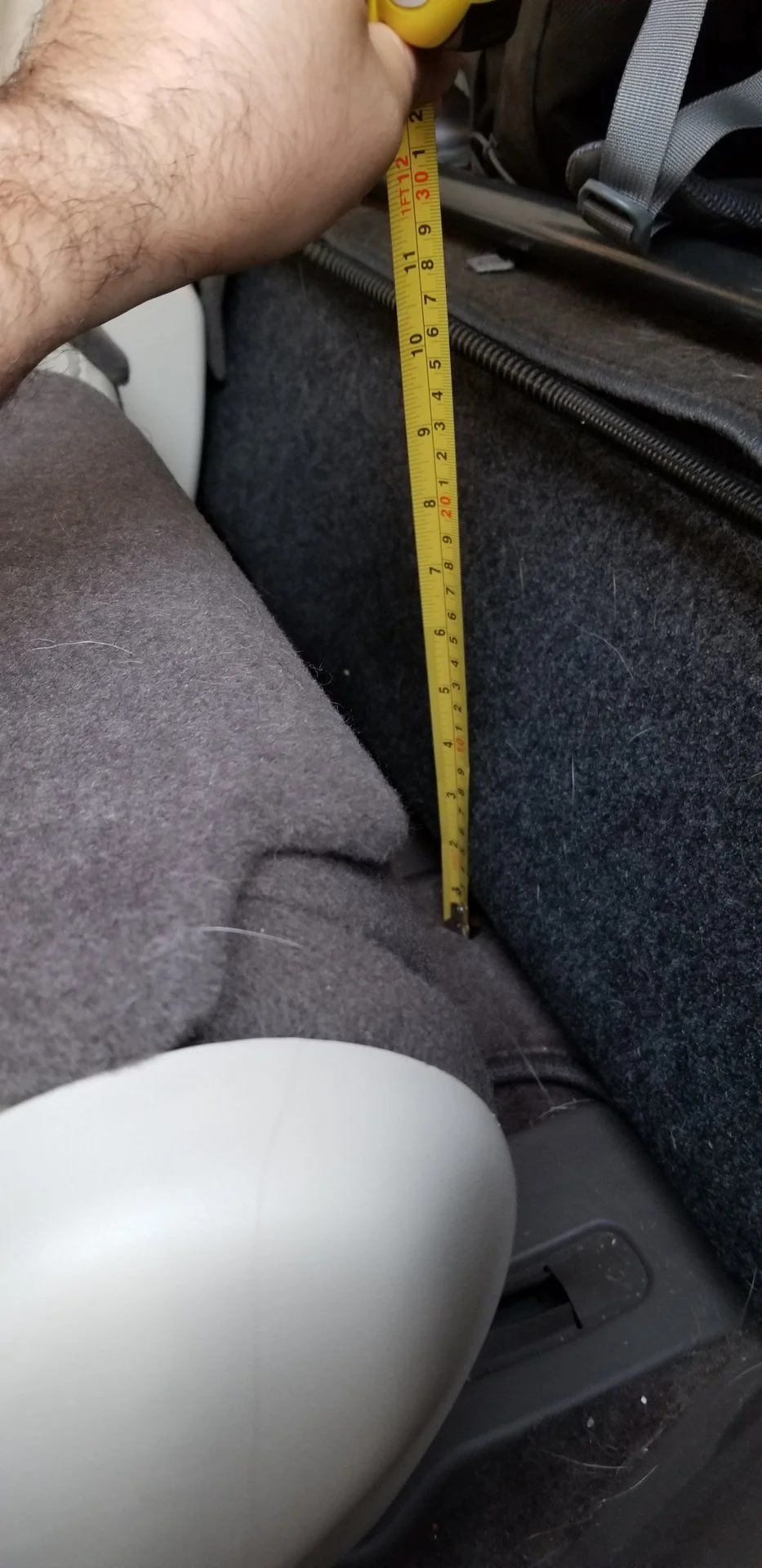

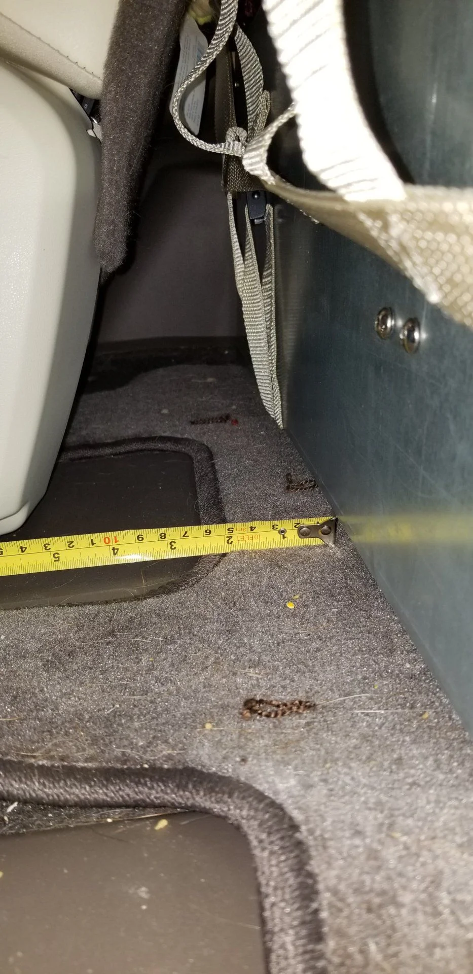

Can you get a picture of the 'dead' space between the back of the drawers and the backs of the 2nd row seats? This space interests me for ham radio and dual battery install. Thanks

As you should be able to see above, my third row is removed. The Dobinsons set up installs straight to the sheet metal. This is also true with ARB. The Front Runner is actually the only one I am aware of that allows installation on top of the third row without removal of the seats. If you look at photos of the Front Runner drawers online for the Prado 150, most of them will show installation on top of the third row without removal. But even if you remove the third row, those front runner drawers are so tall that I am willing to bet they are well above the height of the second row seats when laid flat, meaning you won't get a flat surface. They look even taller than Dobinsons. I'm sure some people don't want to remove the third row and like this flexibility, but I personally needed the extra space and weight savings.

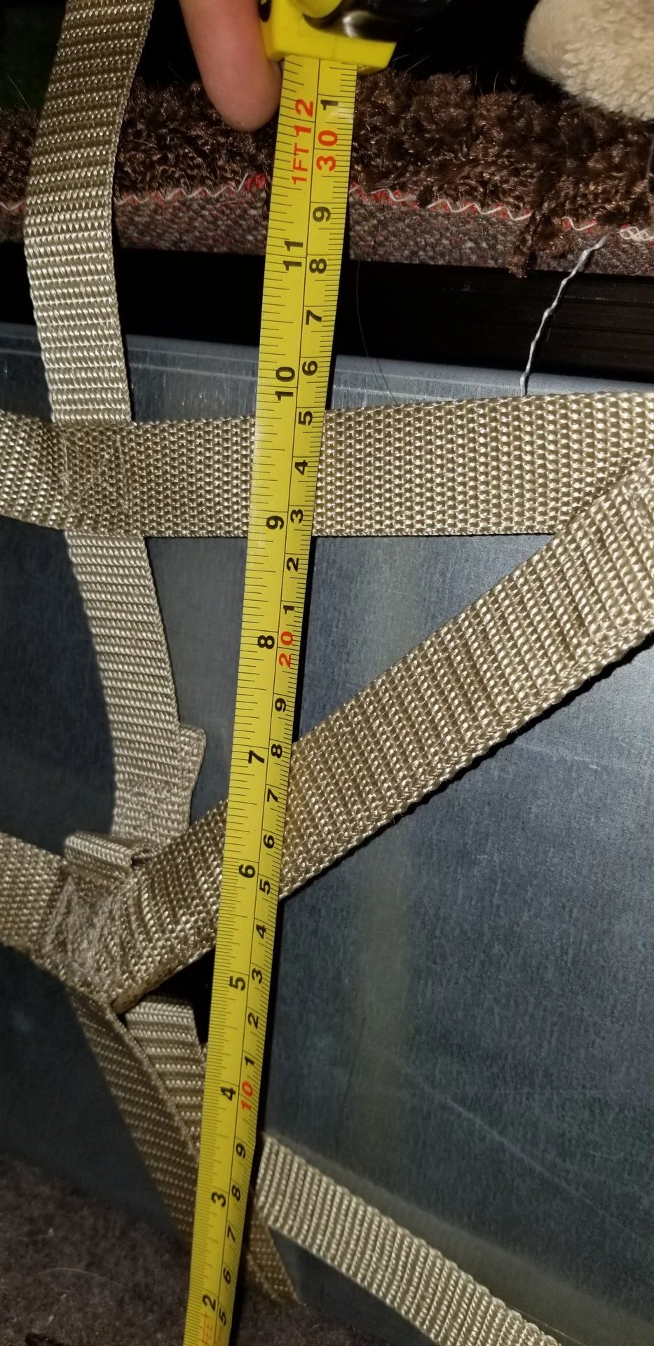

The photo below is from my GX 460. I built custom drawers that went in with the third row removed and provide a flat floor with the second row folded down. As you can see the custom drawers are 10 inches tall. So if any drawers are taller than 10 inches, they will not provide a flat surface if installed with the third row removed.
Slight edit to above. The photo was a little misleading due to the angle. I remeasured and the actual height of the drawers for a flat surface is 9 inches, not 10. The Front Runner drawers are 13.1" tall, so they definitely would not provide a flat surface with the second row, even with the third row removed. The Dobinsons drawers are a little closer at 11 inches, but they also won't be flush with a folded down second row.
