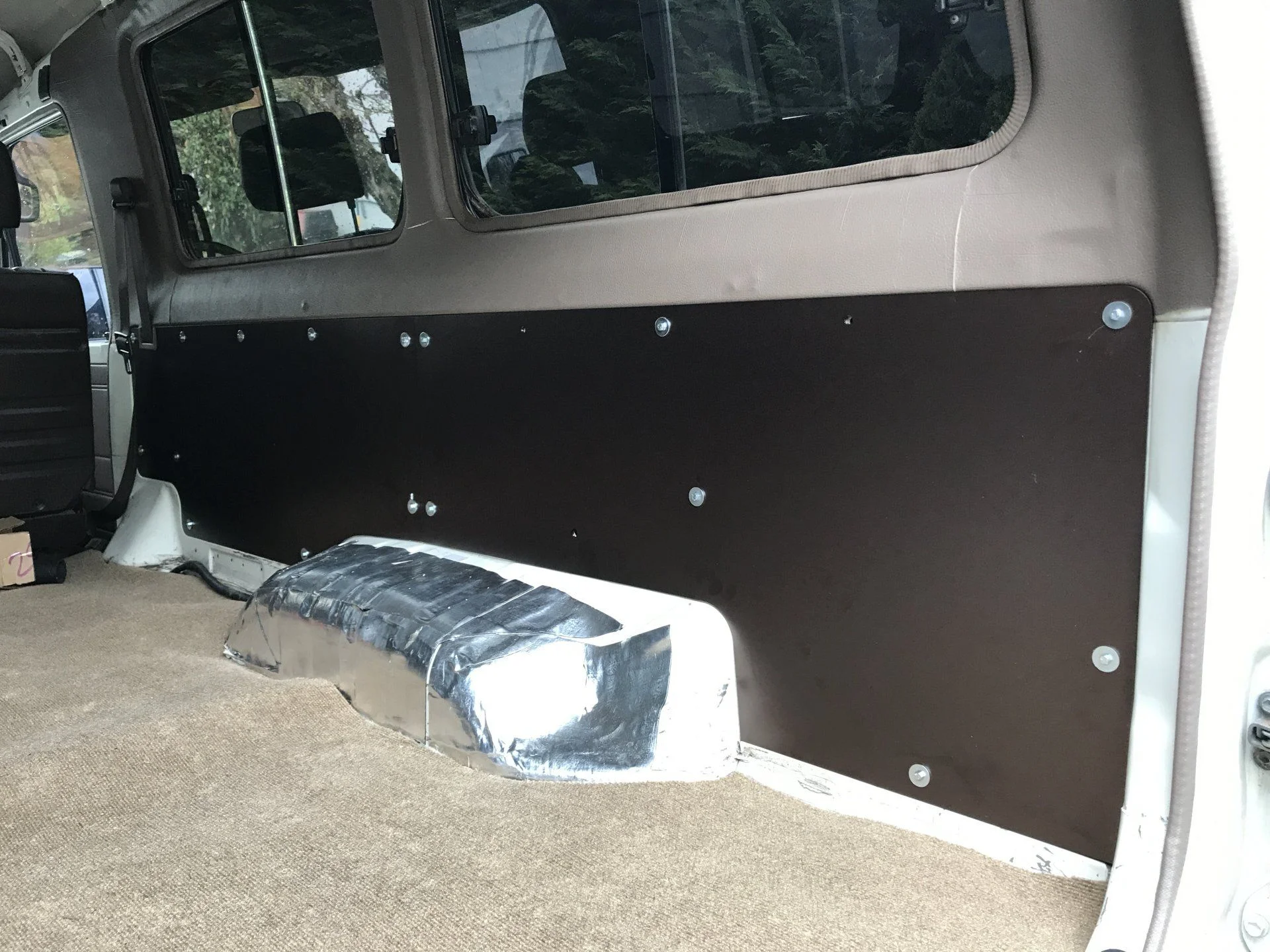

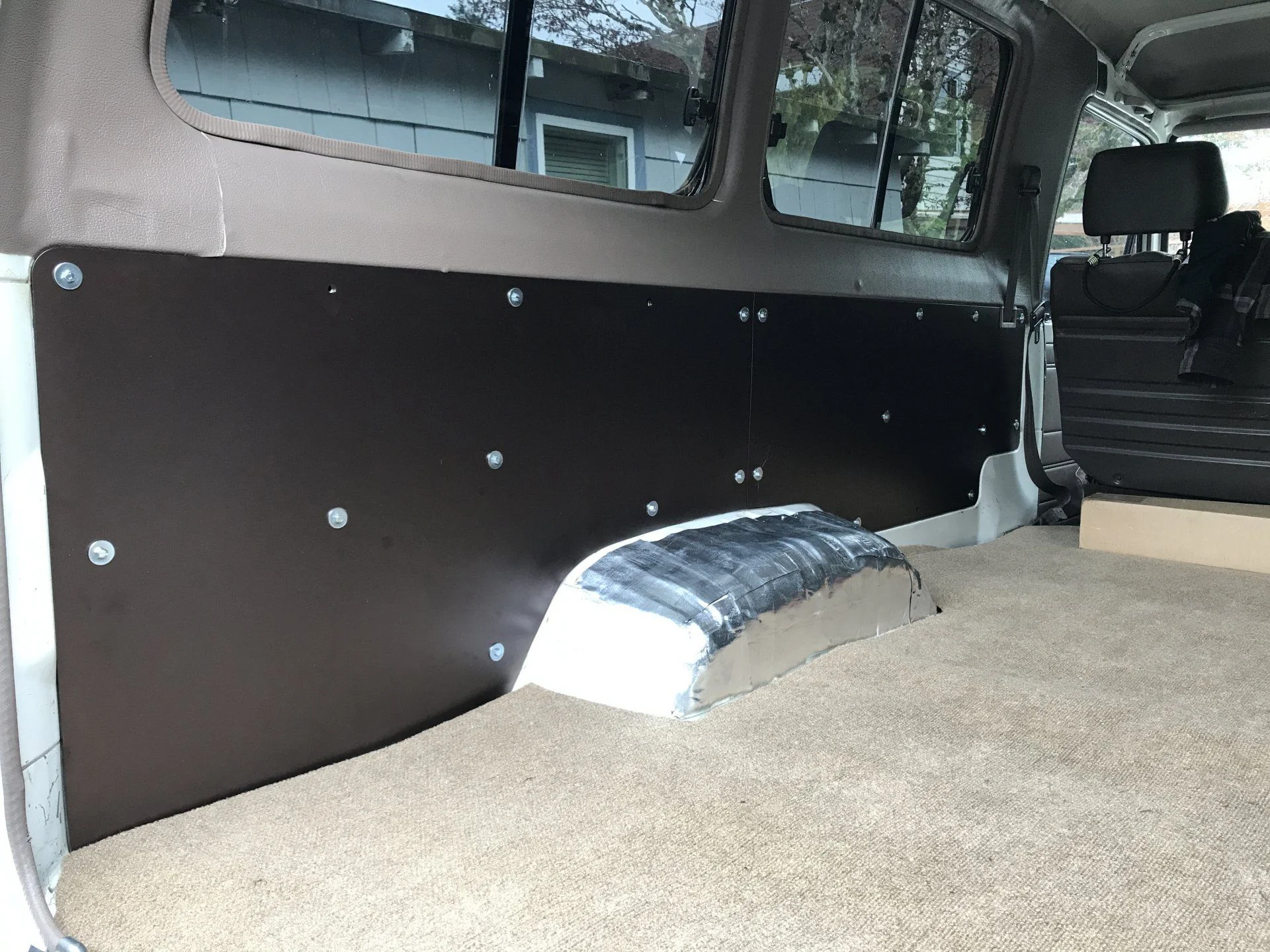

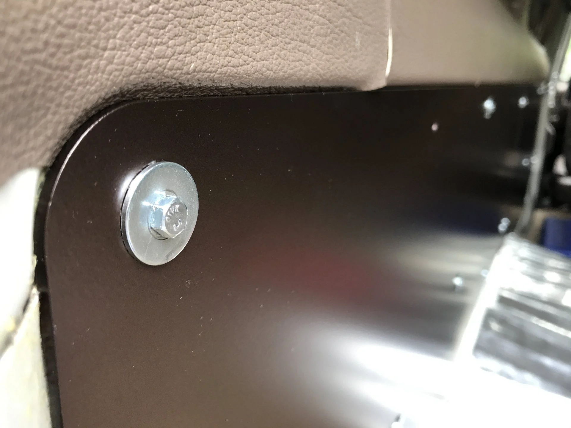

Finally got my new panels in. Some good friends of mine own and work at a metal fabrication shop here in Portland and I am lucky enough to be able to trade them photography favors for custom parts for the troopy. They killed it on these! I went in and custom ordered this dark brown paint for powdercoat and made sure to get enough for future interior parts if need be. Like the wheel well cubby that is in line now to get started.

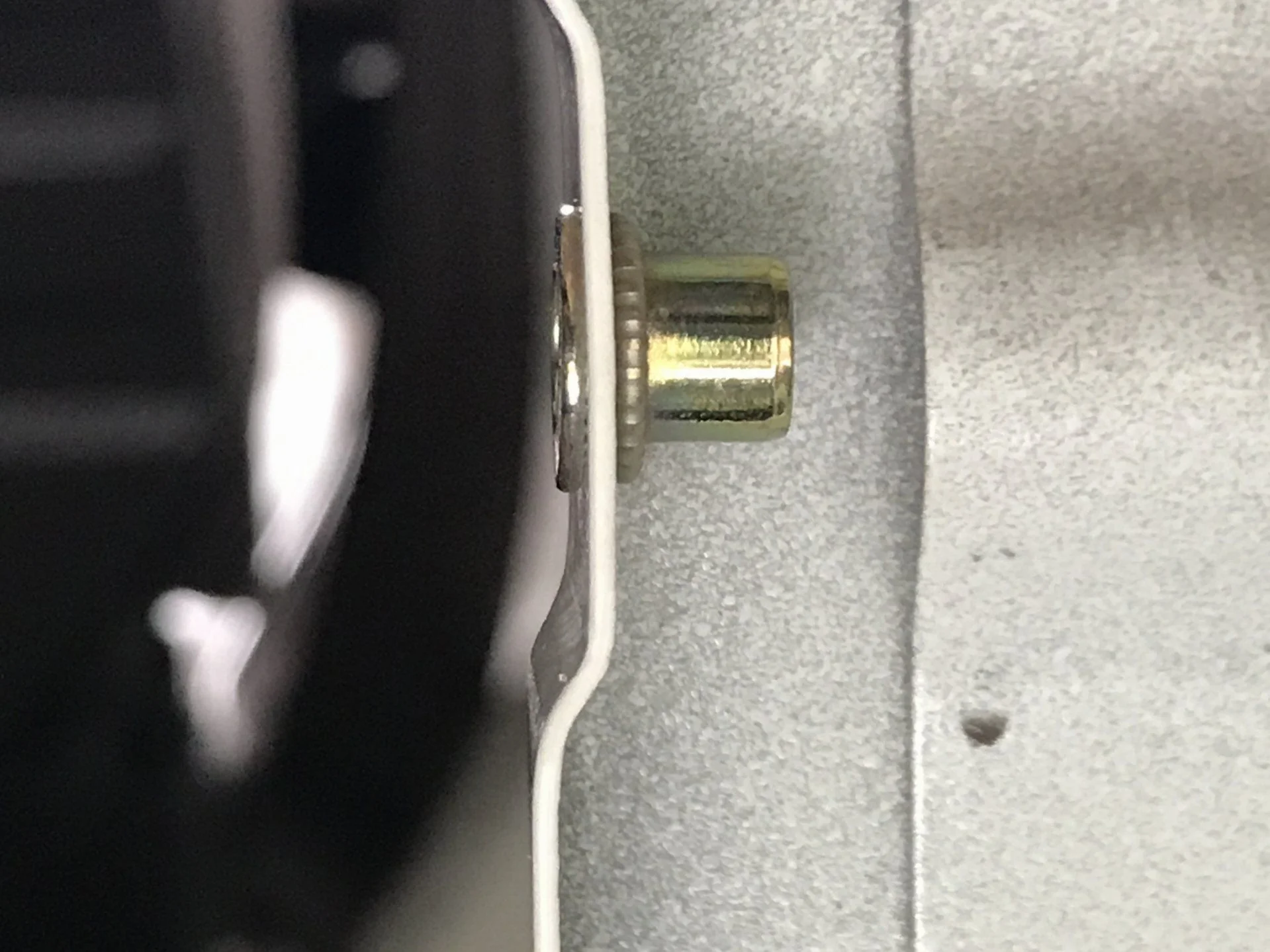

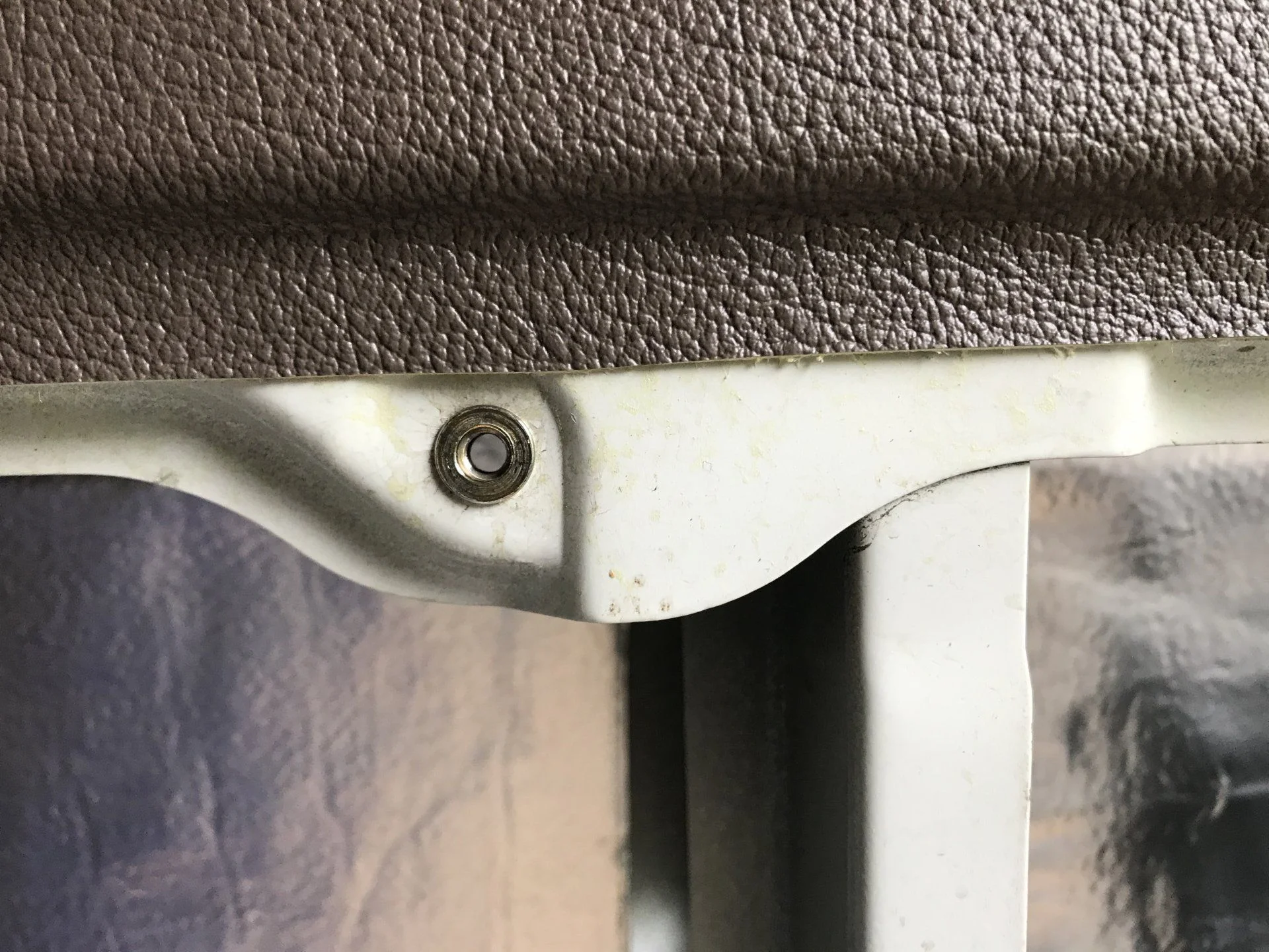

I was struggling with how to mount these new panels since I wanted to ditch the stock plastic fasteners but @AndrewHadji came to the rescue as usual with the recommendation of rivnuts. They ended up working great.
I had to use some pretty big washers because some of the holes didnt line up perfect so I had to bore out some of them to make it work. Big washers to cover it all up. I will be looking for something to do soon im sure and pull them and paint them matching brown.
Decided to just block out the vents. If I decide I want them again I will cut slits where the stock vents are.
All in all im happy to have walls in my apartment again :lol:
Excited to move on to the fun interior stuff now. Bench, storage, sleeping platform etc...

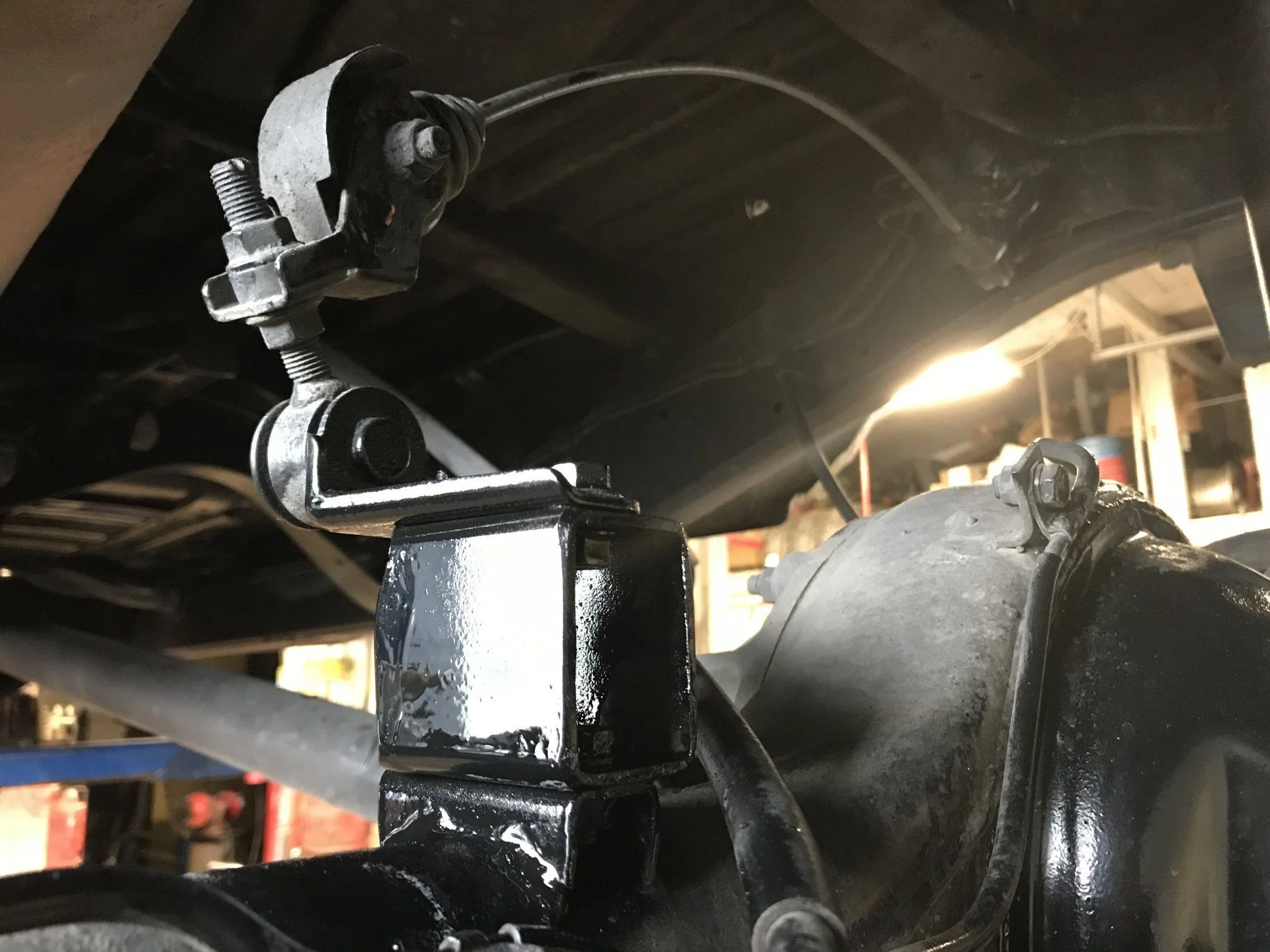

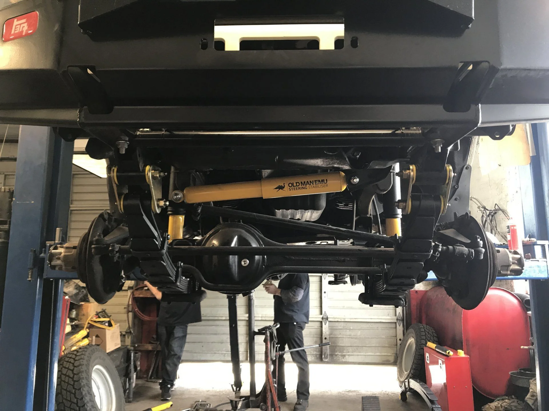

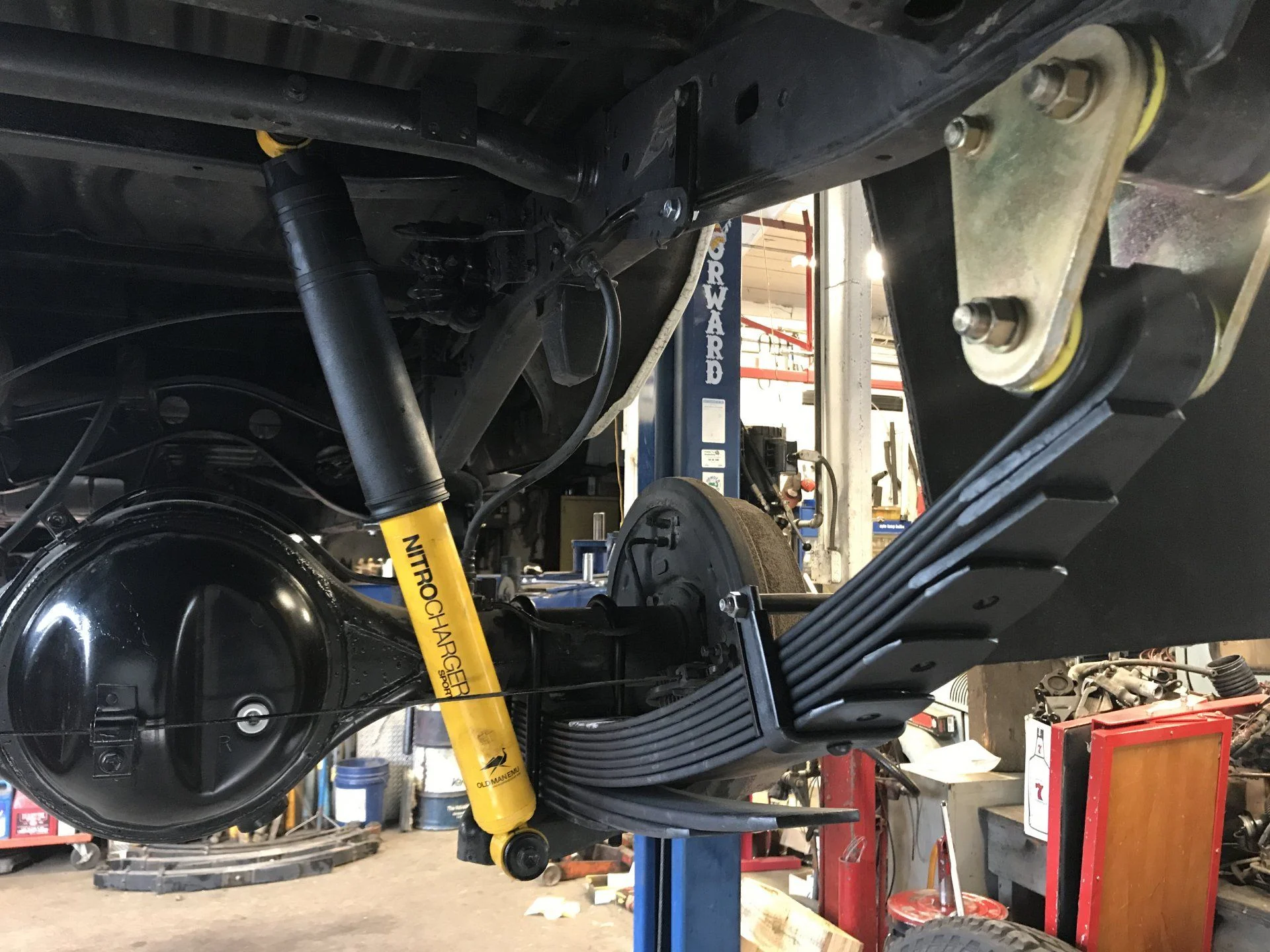

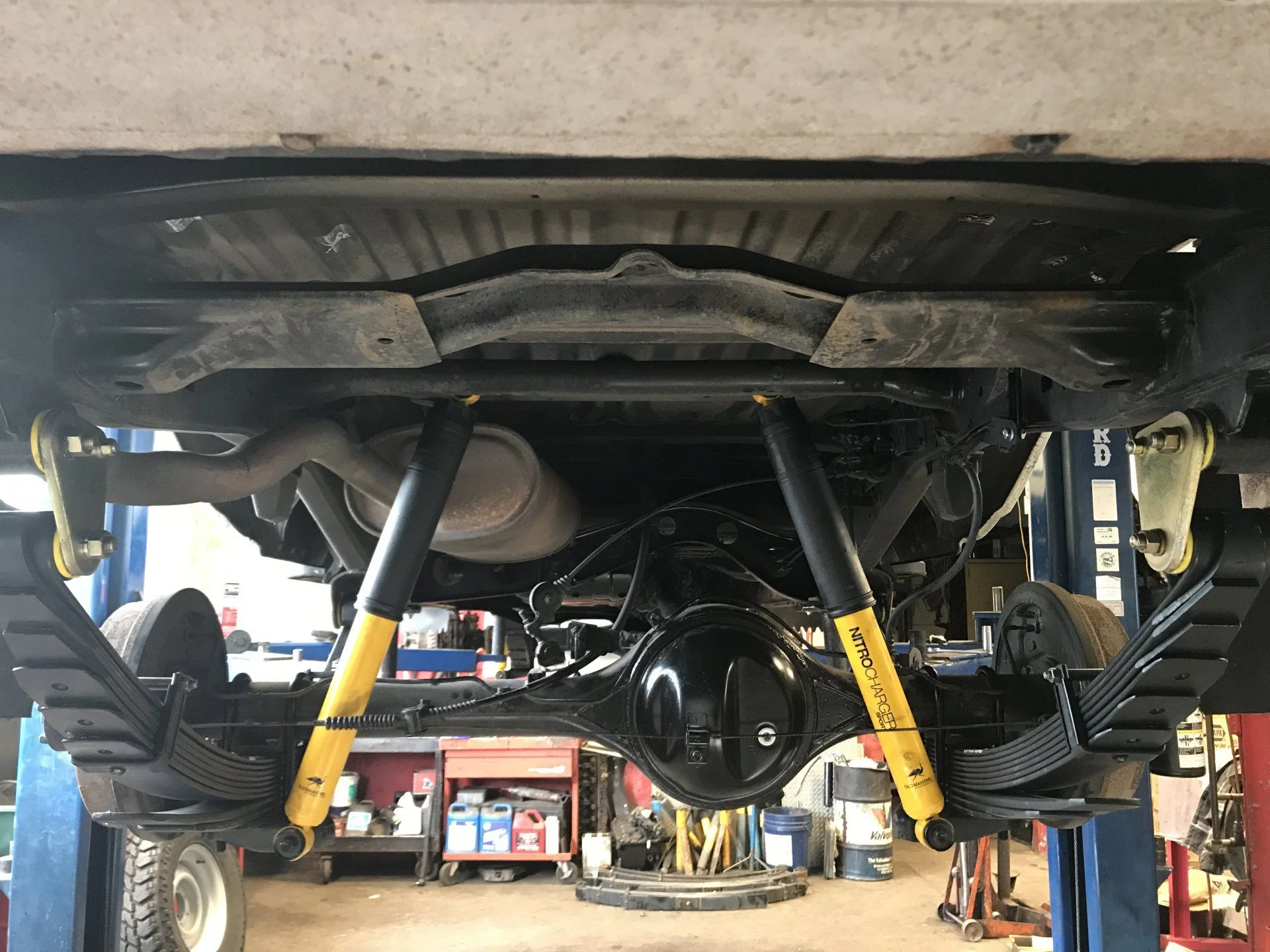

Got the suspension put on today. Really glad I brought it to Josh at Willamette Auto here in Portland, he does these OME installs on cruisers in his sleep pretty much and is the only mechanic around here who really loves and knows these diesel imported models.
So many little things that would have cost me an extra day (at least) to figure out only caused 5 minute delays with him at most.
Heres some pics during the install. Including some custom pieces to make things reach a little easier.
I removed a single leaf from the rear packs but left the front packs full.
Very glad I chose to leave the fronts the way they are. There is already much more articulation even without much wight on them (just the ARB bar) than there was stock. Rides way better on bumpy roads already. The rear feels similar to the way it felt stock...aka, ready for some more weight to be put on them! Should be perfect that way until I decide to add a water tank and roof rack etc.. then I will add the leaf that I took out.
