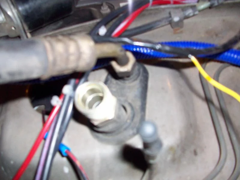

Don't know if the parts are diff between 60 and 62s but the easiest way would be to just take the rig to the hose shop and have them measure and make on the spot. That is what I have lined up with the local shop here. Here is a couple of pics up close at firewall. Guess its getting about time for the AC down South. Can't wait until I retire and move back to Alabama.
Two more at the evap. Hope the pics help.

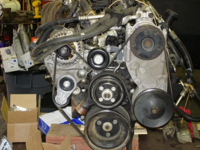

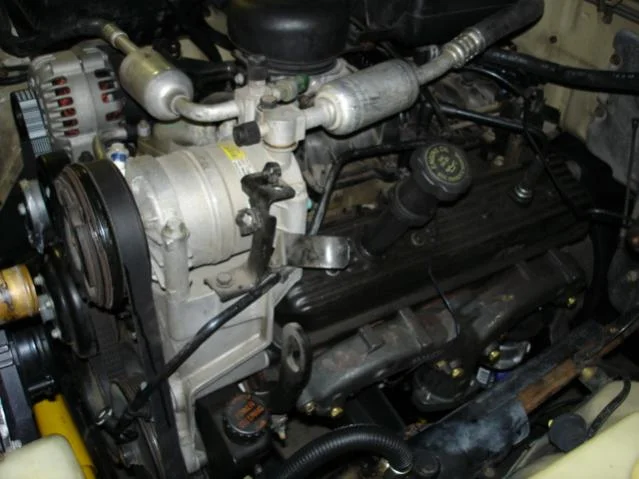

all new cause in south Texas it not worth chancein a broken hose when it hit over a 100 deg for 90 day straigh all the time no A/C sucks I have a 5.3 the Vortec side he had to order .... got pics of yours I have a carb 5.7 truck for parts it has a round a/c compressor we might be able to work out something.. I'll look for my pics

You have the old school "good" large GM compressor and what appears to be an old school 5.7.
I have a 5.7 vortec which is a different animal for accessories and the belt drive.
That looks like the 5.3 set up other then mines on the passanger side on the bottom .... Those pics are of the parts truck : lol:
