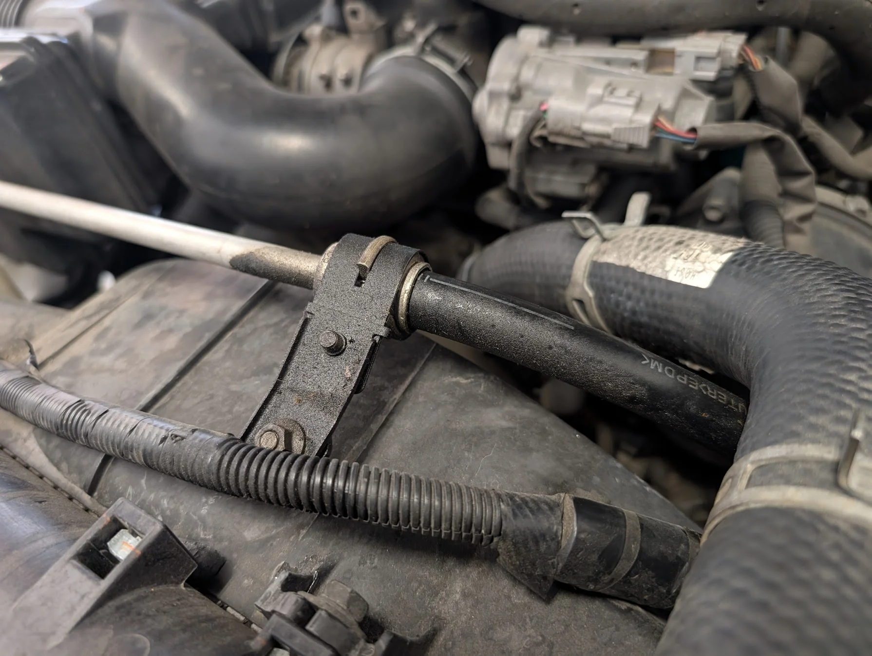

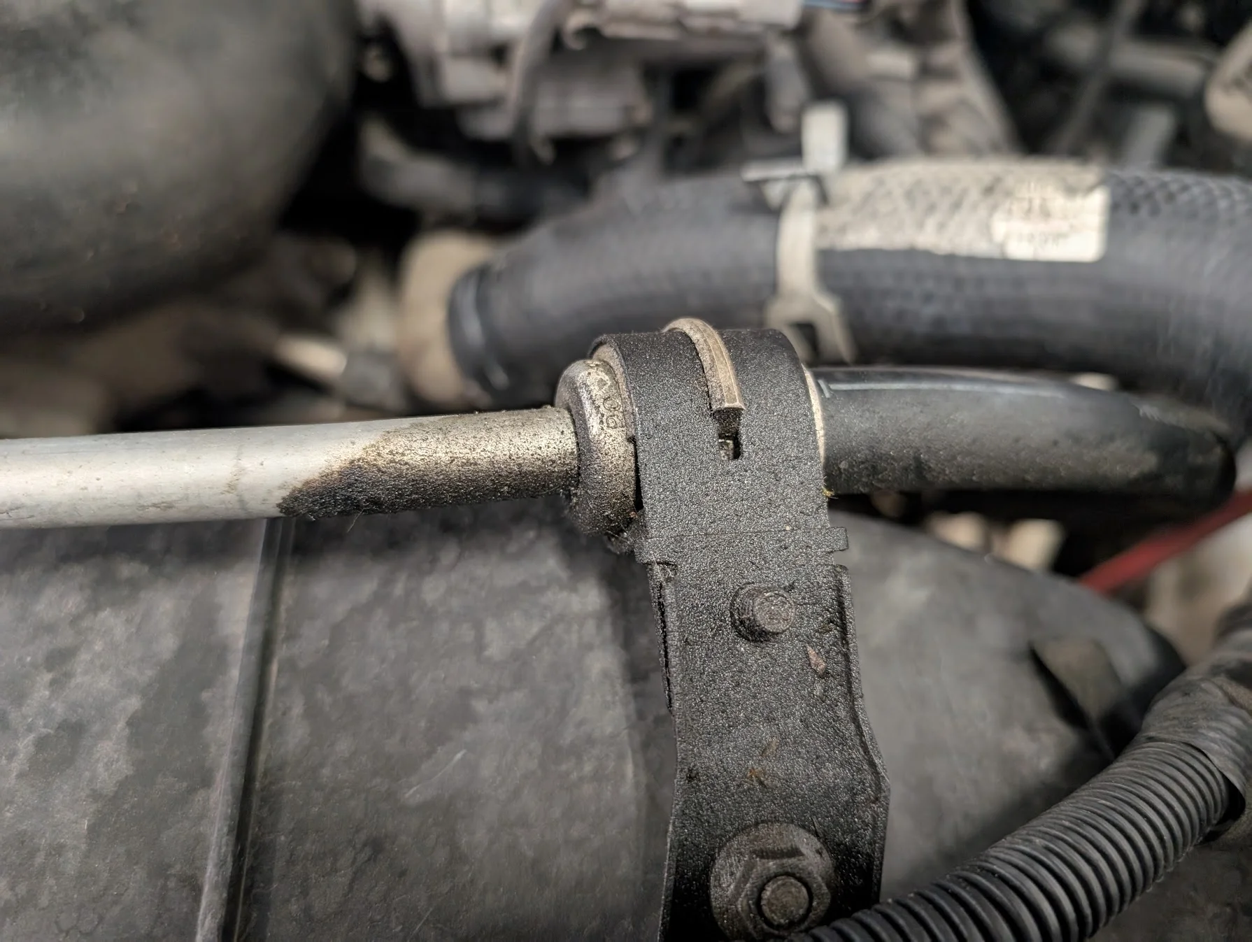

Looks like part number 8871160470, anyone had this leak before? Might be self inflicted to some degree, I haven't paid much attention to those supports for the line in a long time.
As long as the system is still working, I'd just clean it off really well and recheck it in a month or so to see if it is still showing signs of leaking there and If so, repair it then.
Might want to also check the pressures and recharge as needed. Don't want it to get too low. Put some dye in if you do recharge. Makes future leaks easier to verify.
if you REALLY want to know if that's an AC leak, add some UV Dye in your system and then you'll know for sure if its an AC leak. I bet it's something else leaking on there

Yes, this just happened to me recently. I just replaced the line. I rented the vacuum pump and the manifold gauge set from the store. So far so good!
