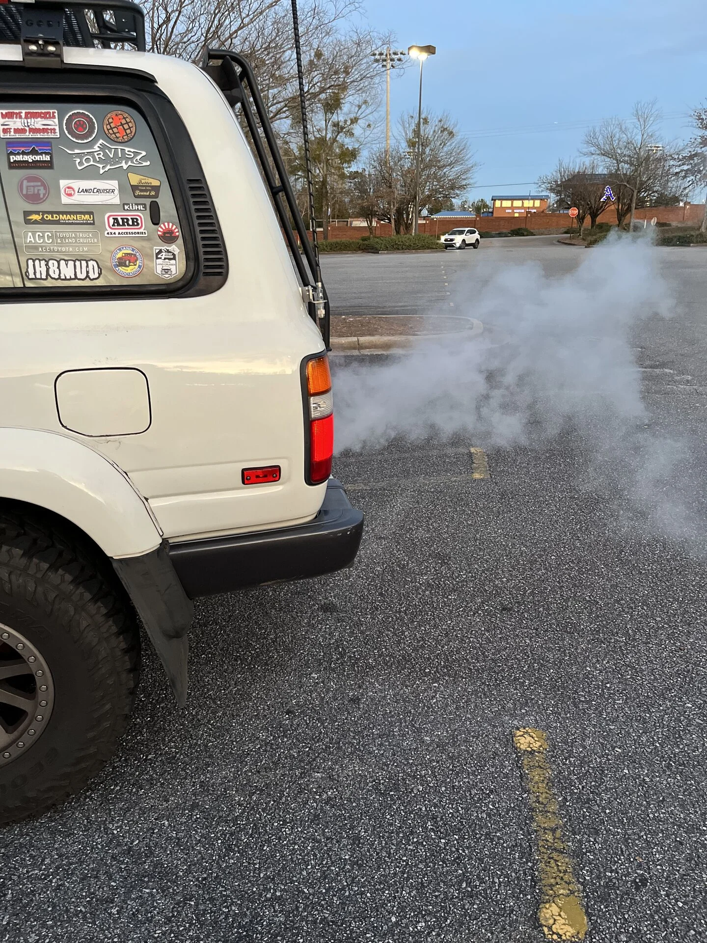

So recently my 97 seemed to gradually become more sluggish turning over. It always cranked but made me wonder if the cold weather was zapping the battery. Then it started idling rough when cranked. After a few minutes or putting into gear and gassing it some it seemed fine until I shut it off. Then sometimes the sequence started again, sometimes not. Now I’m also noticing some white smoke until it gets going, then it’s fine til I cut it off. Seems to be getting gradually worse, more sluggish, more smoke, more often. Still, once going runs out fine. Putting it in the shop Monday but what could be happening? Thanks for any advice.
Failed to mention. Heater not heating until engine warms up and while giving gas and AC not blowing cold.
That’s a lot of white smoke. You know what this means. Time to run some tests to determine if your HG is blown. I’d start with a compression test.
