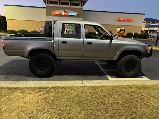

97 Hilux LN107
298,000km
Starting to have a lot of trouble shifting into reverse or will grind, and trouble shifting into 1st sometimes now as well.
Im guessing i need new synchros. Anyone know where to source any? Or a whole transmission. I really dont want to rebuild the trans but i also dont want to pay for a whole transmission either so want to explore what my options are.
