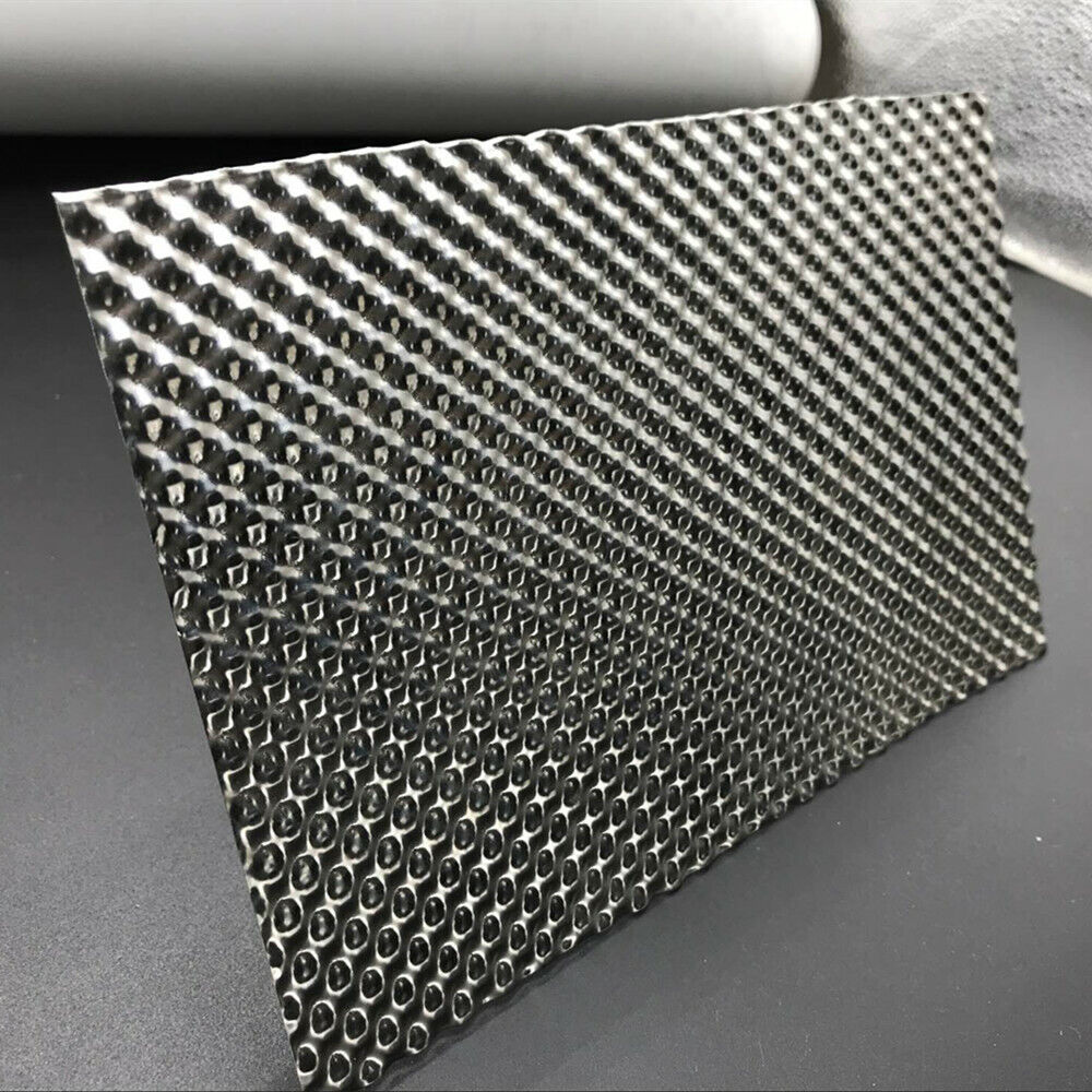

You can wrap the exhaust too. I bet some of that lizard skin ceramic applied to the floor above the exhaust would take care of it. I might know a guy with some @AJR

Yeah, I'd say let Henry's set you up an just build a sheetmetal heat shield yourself. LizardSkin is decent, but a heat shield would make a lot bigger difference.
