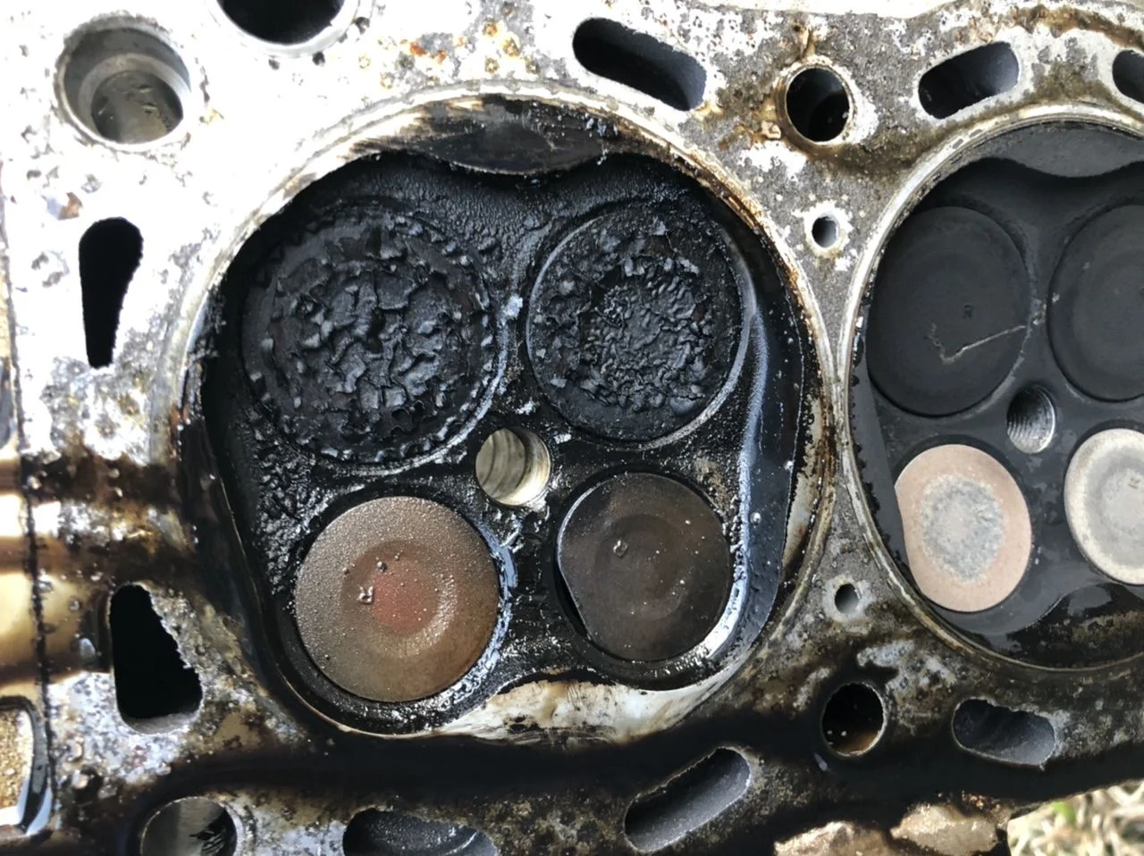

OK so finally got around to doing a leakdown test which showed an issue with the exhaust valve on cylinder #2. We pulled the cylinder head off and, well, see for yourself:
Ouch. What happened? Bent valve or valve guide completely wiped out? Cam or piston damage?
Cam and piston are fine, just that one valve. It's a remanufactured head, so maybe the guide just crapped out?
Sending it in for, hopefully, warranty.
Good news on the rest of the motor. Maybe too much clearance in the guide to start with and it just wallered from there. Weird.

Due to some semi-related issues, went to a new shop and had a leakdown test done, which led us to pull the head again. From what we could tell it was my original core return head, shoddily welded, and those welds had cracked, allowing leakage.
