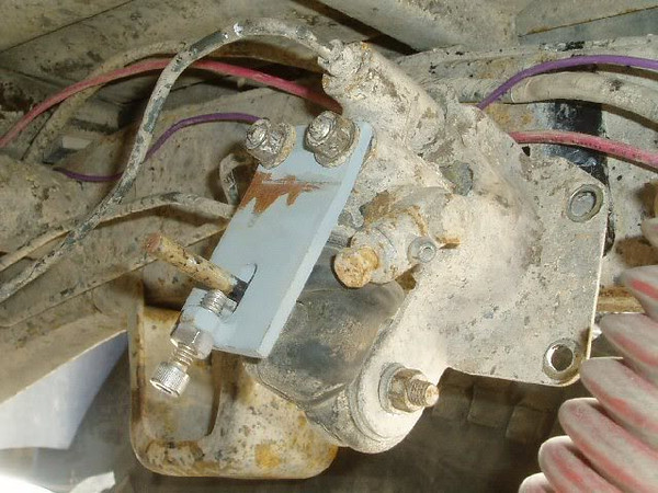

Nice thing about the stock part is that it is self-adjusting for different payloads. They're properly called a "Load Sensing Proportioning Valve" (LSPV)
Bad thing about the stock part is that if you go to larger & heavier tires it is usually maxed out or close to it. After years of having the lever pulled up as far as it would go (DC'd from the axle housing) I made an adjuster that holds the lever stub at the upper limit of it's travel. When I take the shell off the truck I'll need to back it down some.
When I was putting mine back together, I left off the return line that goes from the T behind the RF tire, I just plugged the opening with a flare nut that I welded closed. I got rid of the LSPV because I don't think it was working properly and they are $$$ to replace. This is how I installed a manual valve:
