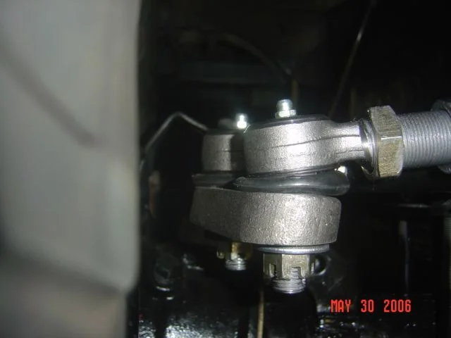

After a trip thru the Rubicon last fall I decided to do an SAS on my 4Runner. It was pretty obvious that IFS, even with a 4" lift kit and a locker wasn't ideal for large rocks. I ordered the IFS Eliminator Kit from Trail Gear. I had picked up a solid axle out of an '84 more than a year ago just to have on hand and it was a good deal. Found a hi pinion elocker at a wrecking yard in Reno and regeared it to 4.88. I modified the housing for the elocker, replaced all the bearings and got it ready to go. Also decided to run the ARP knuckle studs and had my stock birfs heat treated by Bobby Long.
Here's the before pic:
