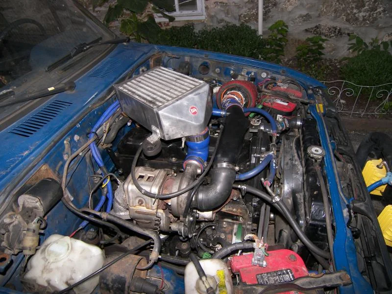

get a turbo set-up (turbo, manifolds, intake, blahblah, etc.) from a dead 2LTE (very easy to find), should run you ~$500. get some new gaskets, plumbing kit for a CT20, etc. and you'll have a turbo'd unit with very little work and less than $700 or so. mind you, an EGT and boost guage will be necessary for another $300. i think AXT sells a complete 3L turbo kit for ~$1,200.
relatively easy project for even a novice wrencher, and the performance on the highway will be like night and day. that's what i'd start with.
3L with 2LTE turbo, and top mount intercooler ('85 toyota MR2), in a 1982 LN:
