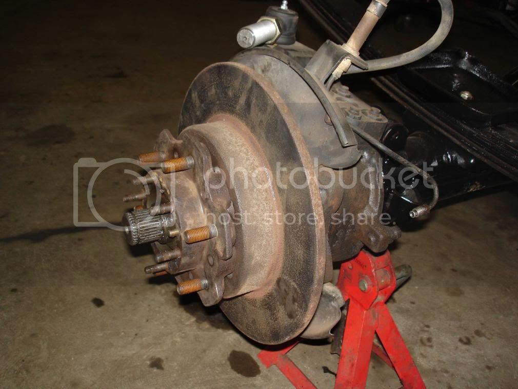

ifs wheel bearing hubs, stock solid rotors redrilled and bolted on, just need bolts to remount the calipers, then repack the wheel bearings, and install new wheel bearing seals

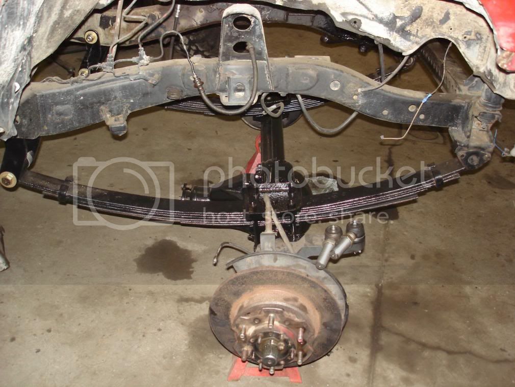

dom built a tube truss for the front axle yesterday -
new budbuilt shackles, there's no drivetrain in it, so the angle will be a lot better later
pass ubolts installed -
front axle should be 2" forward from stock once there's more weight on the springs -

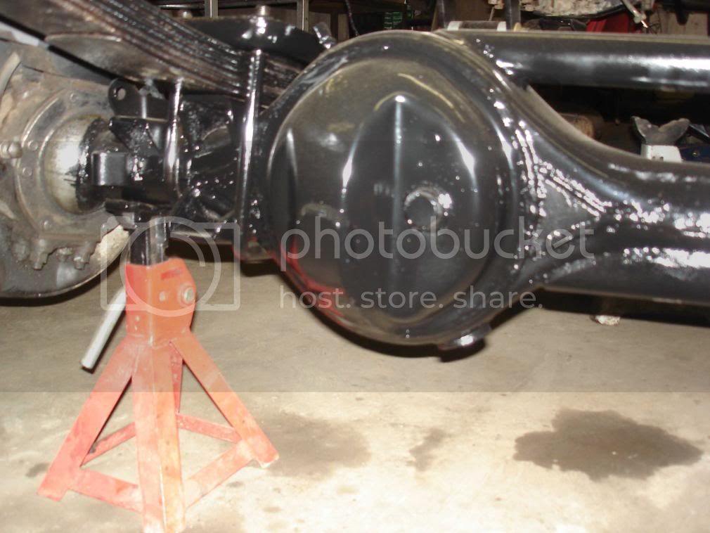

cleaned and painted front axle -
1/4" plate diff guard i made friday
im gonna get new caliper bolts tomorrow, and should have the wheel bearing seals tuesday, then i can put everything together for good and see what the wheelbase looks like w/ the 37's, should be about 106-107":bounce:

i repacked the wheel bearings, installed new seals, got them and the calipers reinstalled, along with some brake line extensions and hooked them up, got all the ubolts on and tight, got the tie rod and drag link back on, just needs the toe set again, going to wait to adjust the drag link until all the weight is back in the truck
