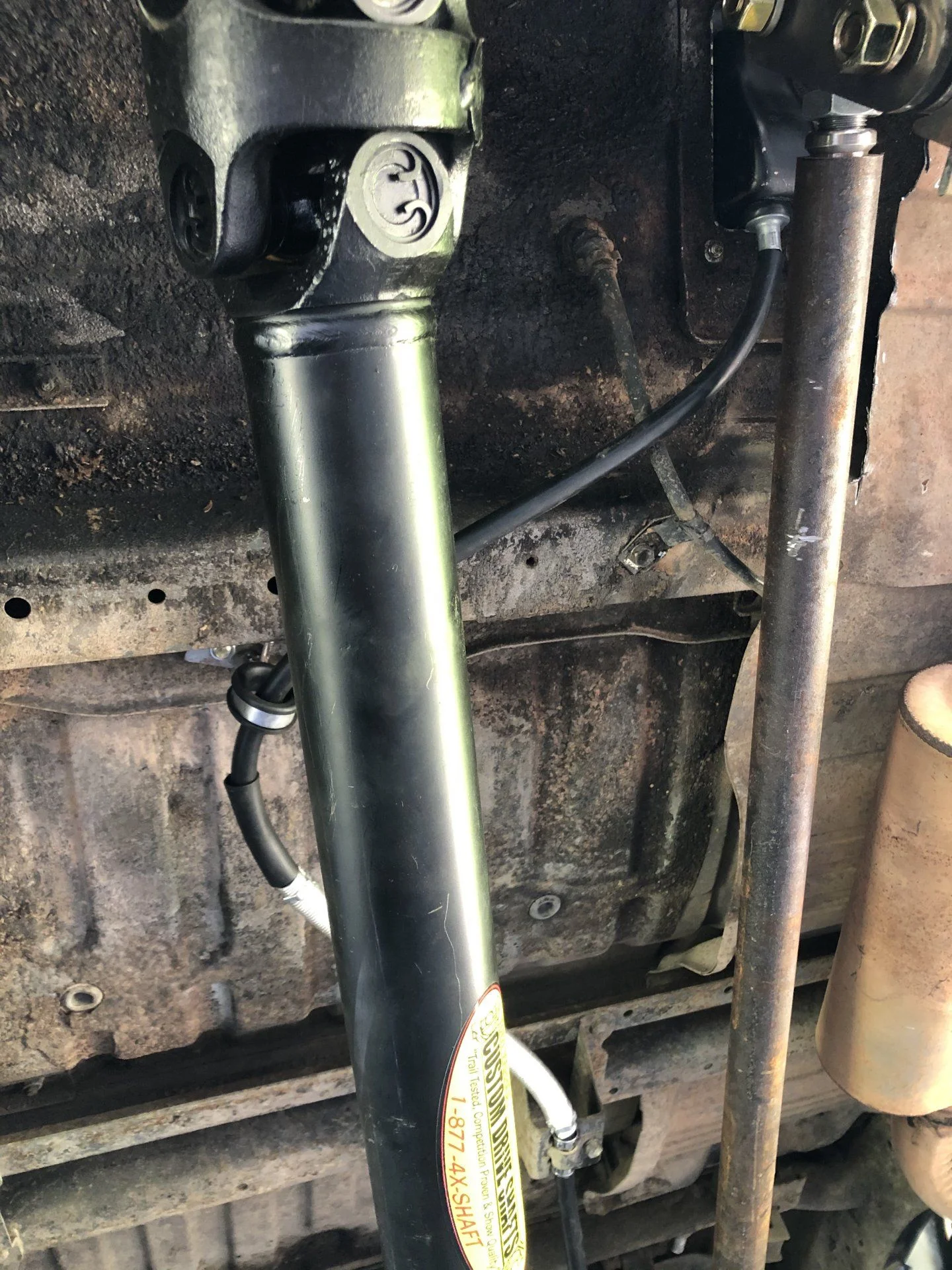

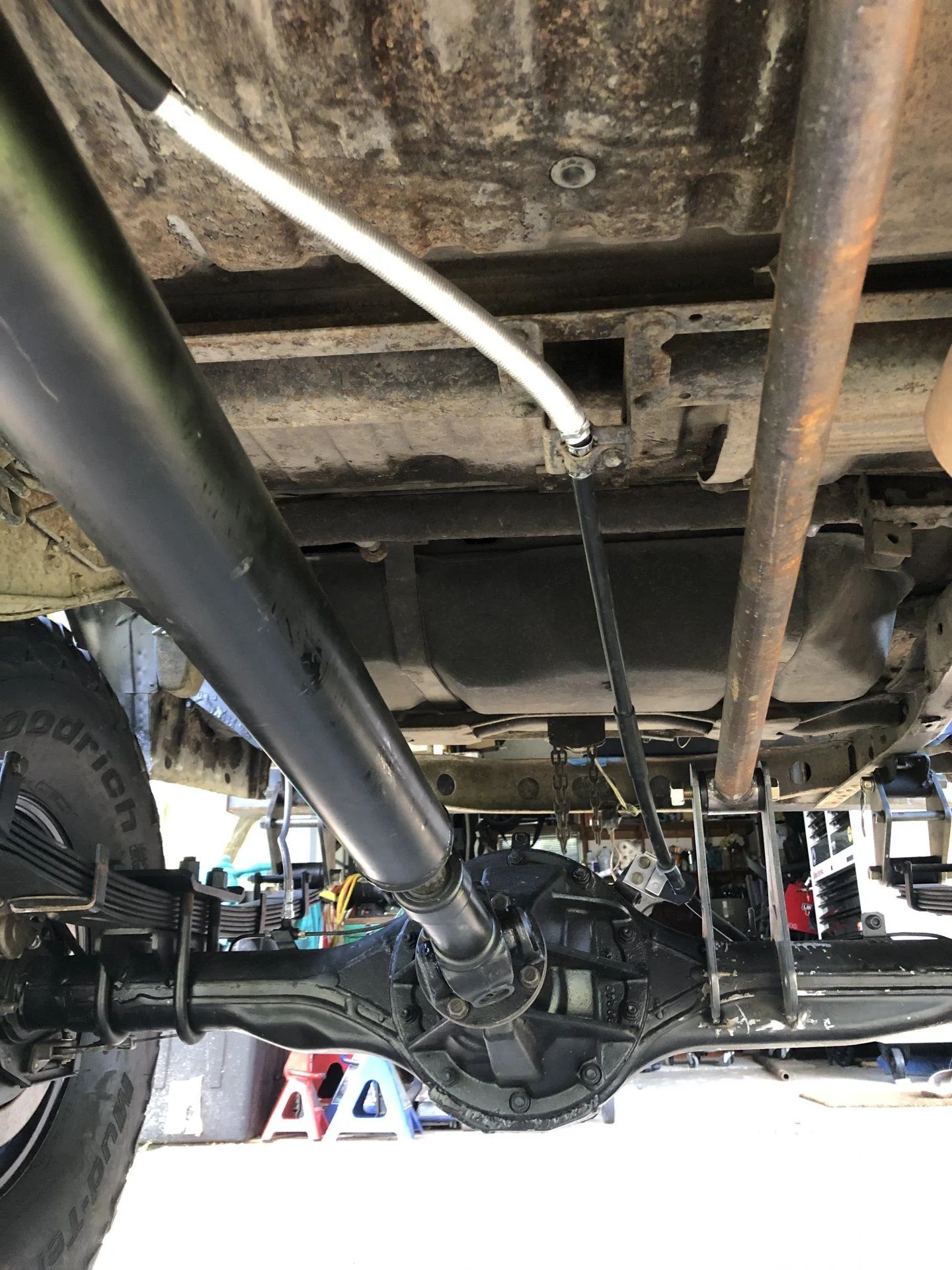

So I ended up running a FZJ80 parking brake cable. I had to make a small S shape to pull some slack out. Works good the rear still need to be adjusted but will hold on a slight incline the new 39s. But I have a new issue when mounting it to the 2 fixed points the cable is tight. So I need to make some brackets because I assume I have to much lift.
Parking brake cable is working but I’m going to pull it out and use a stock 60 cable and mod the passenger side and make it longer. I feel I have to much throw and it has to be completely tighten to work properly.
