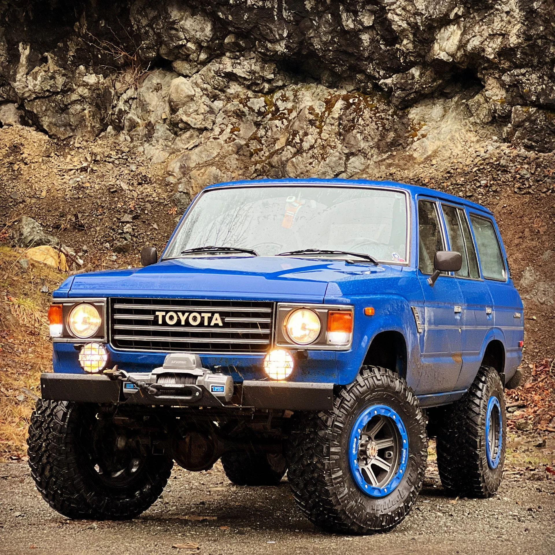

I am currently on 17" Alpha Equipt wheels and running a 35/12.50/R17 Nitto. I'd love to go the tall skinny tire route, so I've been looking at running the factory 17" steelie Tundra/4Runner wheels with LT255/85R17 MT Baja Boss and they are around 9" wide..
