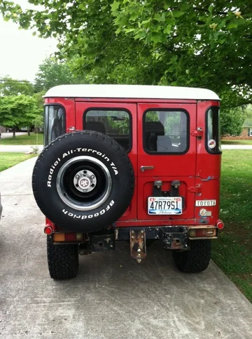

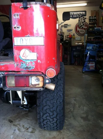

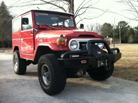

I have used Georg's spring perch kit on a 60 rear axle to put a full width 60 axle under my 40. It worked very well! I actually liked the extra width in function as well as form. Those are 33/12.50's mounted on 8" wide rims. The axle puts about 1.50" extra width on each side of the body.
View attachment 1011594View attachment 1011595View attachment 1011596
I considering this, but was concerned about my 31s hitting the fenders. (stock suspension) I also wasn't sure how it would track with the rear axle being wider than the front. (ih8spacers)
