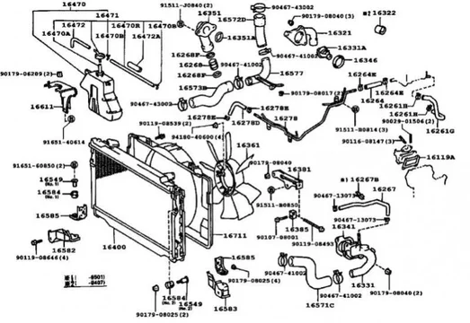

Any takers to what the cause of this may be?
Came home and noticed coolant stain.
There is an o ring in there might have hardened up I'd broken.
White Trash of the Elwood Chapter, TORC4x4.org, Cottonland Cruisers.
Easy fix if that is it.
Maybe due to the 24 degree night.
Seems the LX may have thought it was spring, too.
It was sitting when I noticed. Cleaned up, let idle for twenty minutes, now no sign.
Pilfering through FSM to see what to order.
Based on reads, there's 3 o rings for the coolant passage tube, two of which are a PITA to replace.
Can't find chit in FSM, but found this detail in thread.
Based on thread, it's the source of leak.
Anyone have definitive info on the O rings?

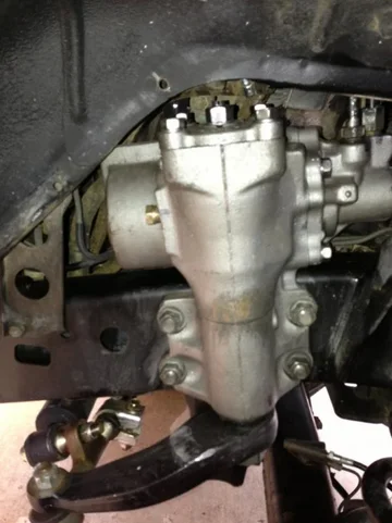

Is the power steering reservoir cap available separate from the reservoir, itself?
Swapped boxes and can't completely isolate the cause, but ATF accumulates at top of resi even though fluid levels are correct.
Does radiator have to remove to swap the HP and LP power steering lines?
Noticing fluid accumulation there, that could possibly be coming from the resi, but "while I'm there".....
Intended on swapping resi for larger, in hopes of hydro, but installed box and guess I'm too dumb to find second port.
PM'd builder, but haven't heard back yet. Didn't pay a lick of attention when installing, since in a huge hurry. Hopefully, I'm blind and font have to remove for second port.
