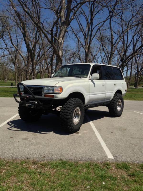

Armor/Recovery

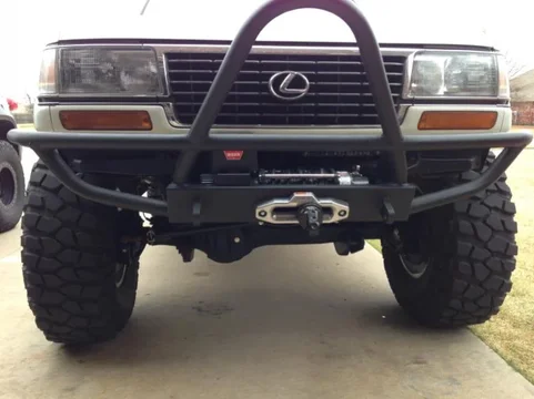

Metal Tech Modified Tube Bumper
Boxed around the frame rails.

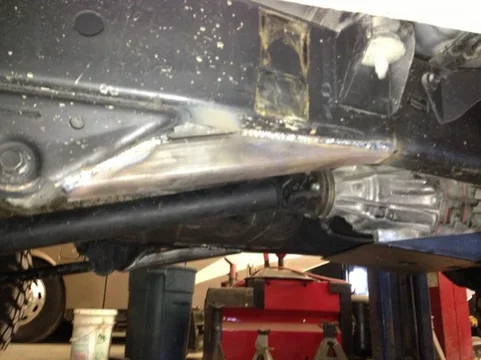

Metal Tech Modified Sliders
Still waiting for LT to get off his ass and build the rear to match

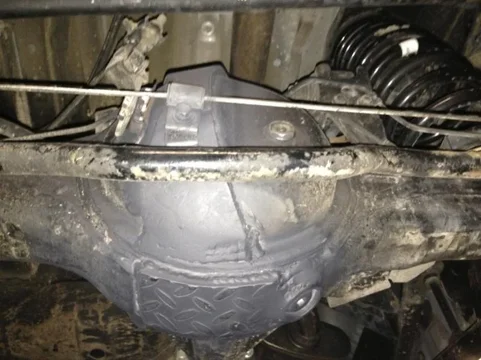

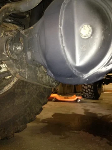

Front Diff Armor
Rear Diff Armor
Lower Link Ramps

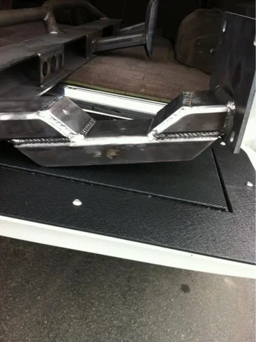

Redneck Ingenuity TC Skid
Slee Rear Locker Guard
Marlin Front Locker Guard ( to be installed )
Warn 9.5XP-S with Factor 55 Pro-Link
Coming Soon In Cab Winch Controls with Slee board and OE switches
In Cab Winch Power Disconnect with OE switch

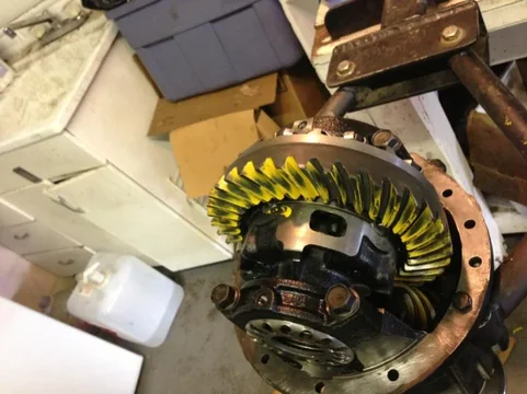

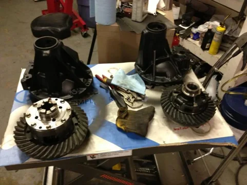

All Transfer Case and Diff Work by Robbie Antonson
VC removed
Marlin Crawler Gears

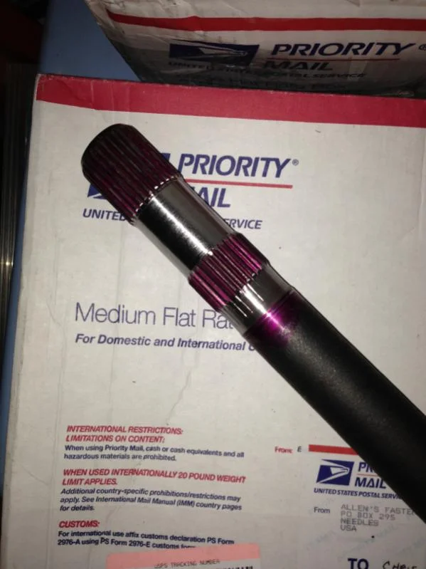

5.29 Nitro's cryo'd
OE Axles replaced/cryo'd
OE Birf's replaced/cryo'd
E Lockers refreshed
CDL switch from Slee
7 pin pulled
LandTank Short Side Axle Mod on second, new OE axle

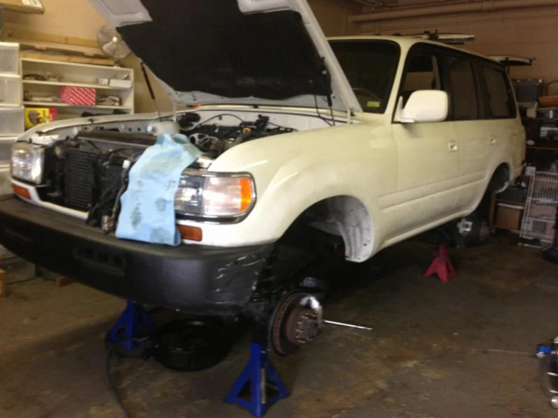

Engine @108k
All by Robbie Antonson
Head Gasket and Valve Job

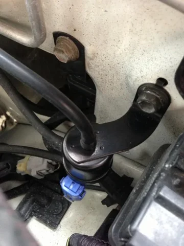

OE Fuel Filter

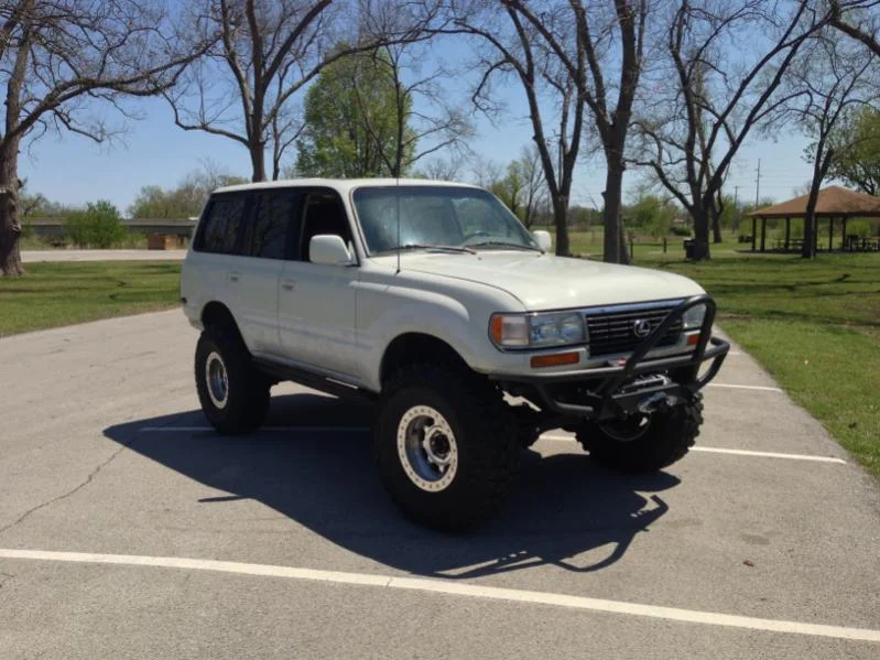

Suspension
4" Suspension Stuff Flexy Coils

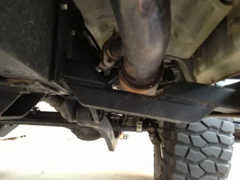

LandTank Upper and Lower Rear Links
Slee Pan Hards
Superior Engineering Radius Arms
MAF Rear Drops
OE bolts replaced for all
Coming Soon
Radflo's

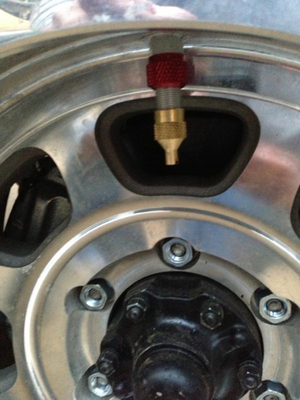

Wheels Tires

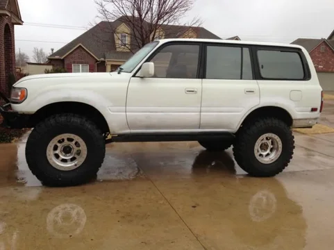

37x12.5x17 BFG Krawlers on Trail Ready Beadlocks with Monster Valves, conventionally balanced....for now.

Inherent to the flexy coils is the dead space at the upper rungs, almost like a 2" spacer on top of a 2" coil ( total 4" lift ).
When I checked max compression using forklift, I believe the coils bound due to the extra material in the upper rungs that keep the coil in the bucket at full droop, but none of the pros agree with me and all have suggested pulling shocks, coils, and cycling to double check my findings.
During the interim, changed wheels and tires, so another variable that wasn't factored.
Don't have the coils compressed dimensions, though, which leads me to believe that the best approach is to cram the tire into the well, cut the well, them lift until coil is compressed, measure, them order longest possible based on compressed number.
Haven't had time nor facilities, but it's coming. I can't stand the ride quality of the OMEs.
