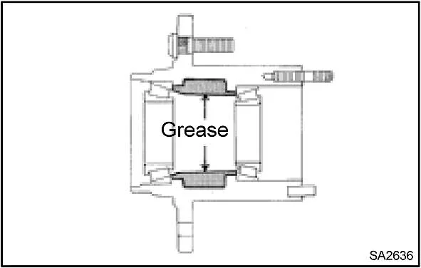

It's normal for freshly packed bearings to run slightly warm, until the excess grease is pushed away from the rollers.
how long does that take ?
Would expect less than 100mi. Depends on how much grease, most think it takes, or is beneficial to put excessive grease. The proper amount is slightly proud of the races, needs to have air space.
