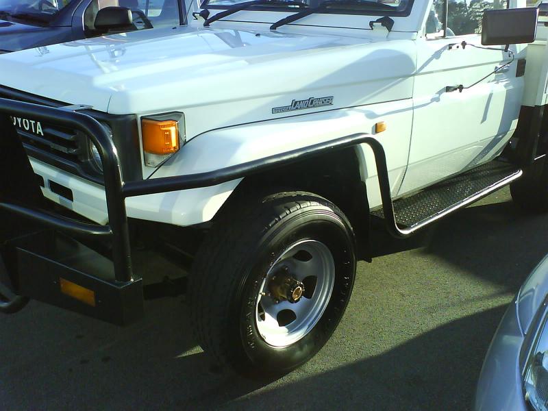

I need conformation on these rims!!!!!
I found a set of Factory 80 series GXL Rims!!!!! ssshhhhh!
So you reckon they'll fit a 74. Any issues?
My main concern is the Tie Rod Ends but these should be cleared by the 16" Rims, right?
Clarification, info and comments would be awesome. Also Hulsty if you see this
you might want to add something cause I think your running these rims too.

The seller said he had them on a 40 series but when he put 75 series tie rod ends on it they rubbed.
Looks like they wont fit. Oh Well.... I have to stay focused on fitting the new windscreen frame anyways.

Checked it,snaped some shots , no spacers on this one either and the left hand side tie rod look close in the pic but has about a inch gap, dont know what that guy couldnt fit it on his 7x series

Thanks for the pics Clint.
Looks like they fit no worries. More clearance than my outlaws.
