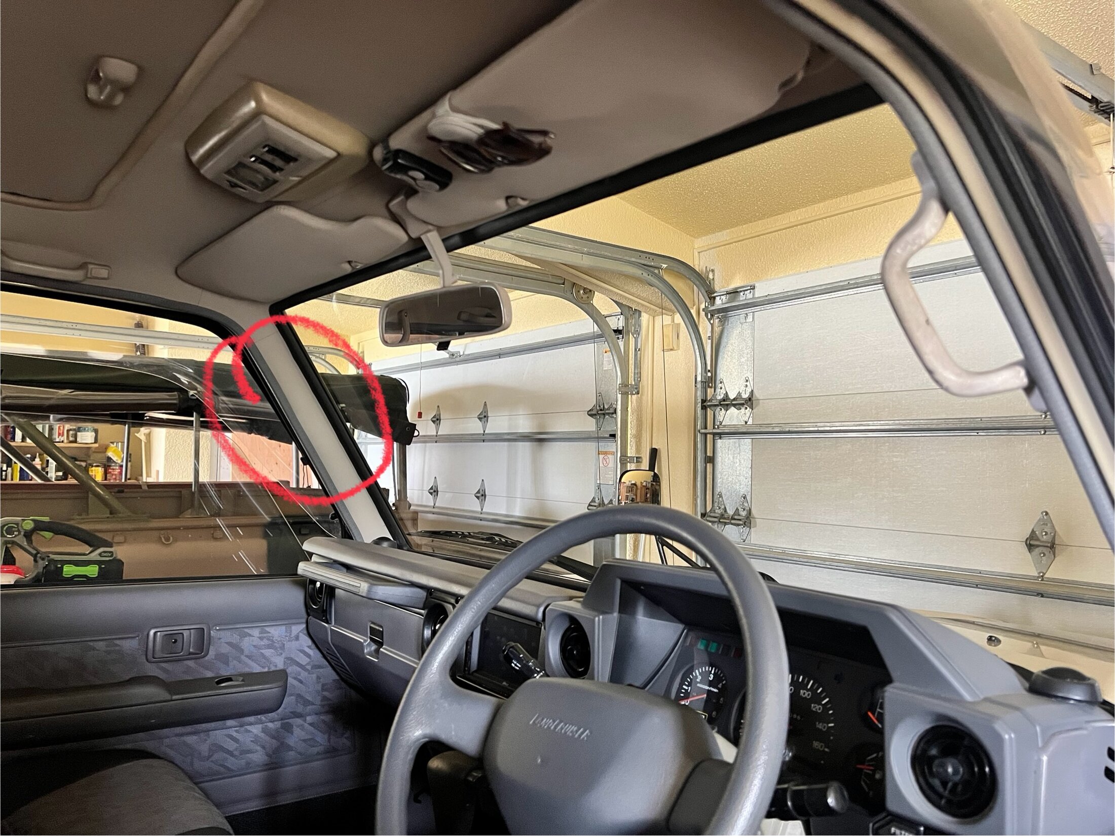

Before I take things apart, wondering if anyone knows if I will find holes in the left-hand a-pillar for an additional grab handle. Truck is a 1999 HZJ77.
Thanks!
Someone on here detailed installing one a year or two ago. As I recall one captive nut was present but buried under the sheet metal, the other was not there at all and required a rivnut.
Interesting, mine is a LHD and the grab handle is on the left.
I'm guessing you will need to remove the headliner on the A pillar to find it.
