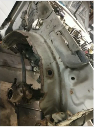

Snipped this off e-bay.
the intake is right up to the top of the fender, essentially the same Hight as the bonnet.
