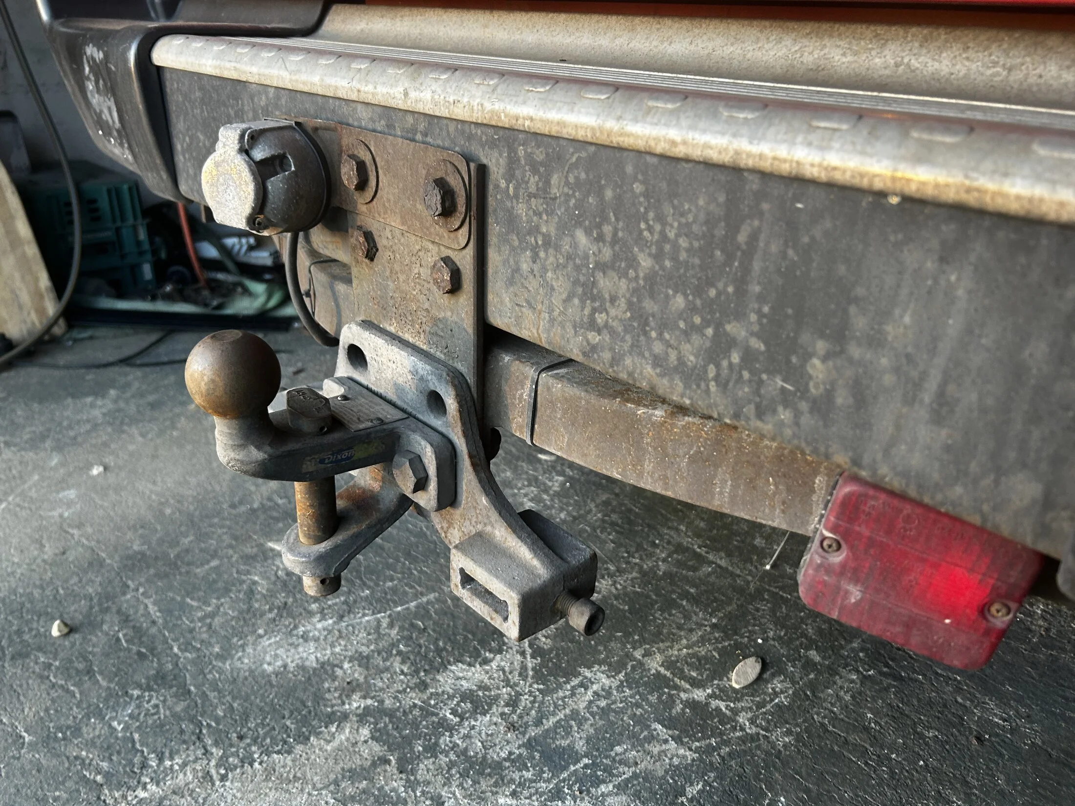

So - from what I can figure so far I need for the chassis 6 x 'M12x1.25' 40mm to 55mm depending how big washers used, and of course putting the spacing plates between towbar and chassis. Apparently random if there are captive nuts or not on chassis rails - due to how many tie-downs attached at factory. So may need washers / nuts for some.
Not sure if this is Europe specific (photo attached of towbar when on donor vehicle) for 4 holes on bumper - top is M12*1.25 40mm to 55mm as captive nuts there. I didn't see the removal as bought it and it was shipped to me. Lower ones no captive nuts, so need same bolts but add washers / nuts behind.
Planning on going 55mm length all around as plenty of space, and as per advice above. And for sure 10.9 grade.
