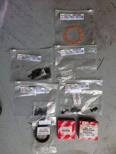

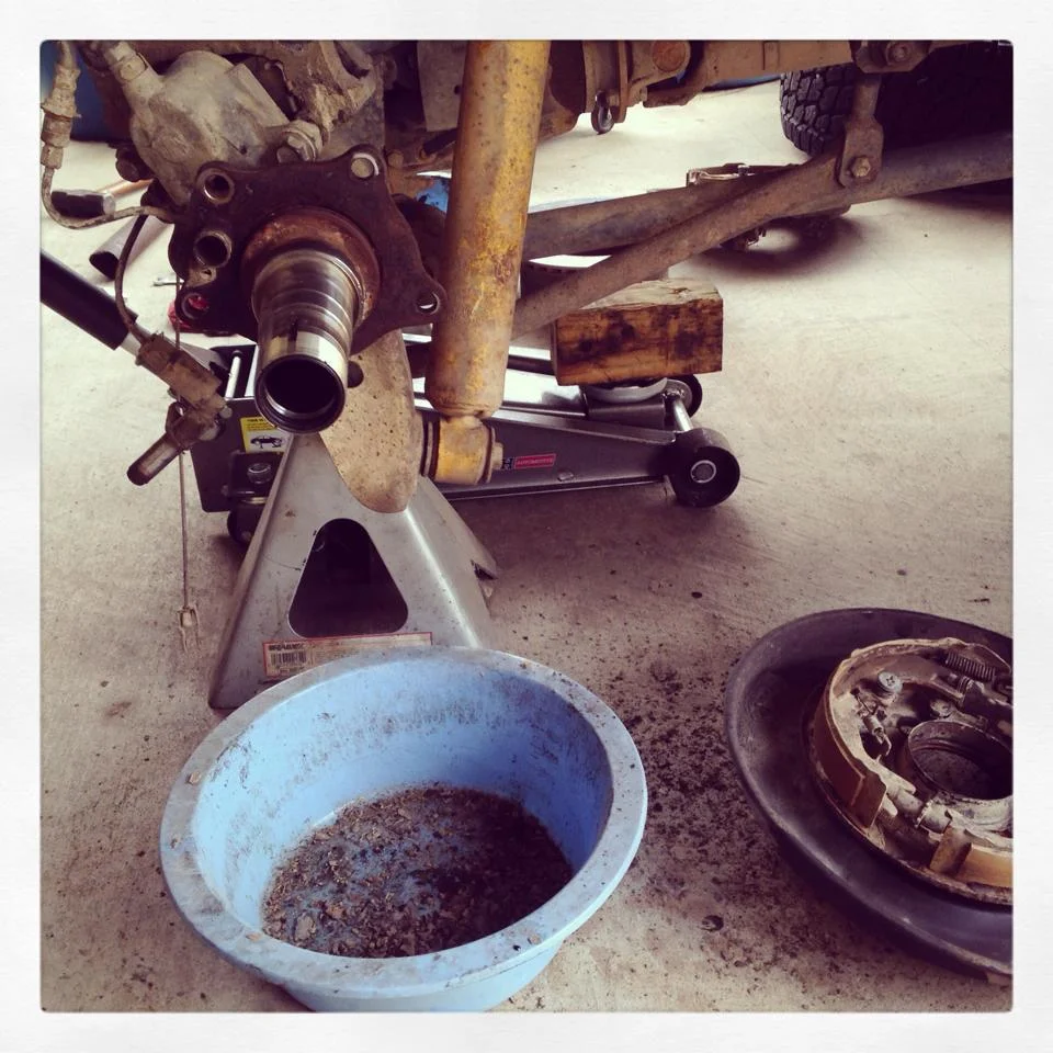

Good info you may need to reference when servicing the rear axle. I've been wanting to do a complete tear down of the rear axle like I did the front last year but I just don't have the time to have it down that long. I'll have to wait for whole tear down as a winter project in the offseason in the meantime it'l be all cleaned up and easier after this bearing job and just in time the axle seals are leaking and washing out the grease which will lead to bearing failure. Keep an eye on your maintenance needs as much as we work our Toys they need a little TLC every now and then
Useful thread I needed the oil seal part numbers.

Rear Axle parts
43422-60040 x2 (gasket for axle to hub)
90311-62002 x2 (inner oil seal)
90310-35001 x2 (outer oil seal)
Other parts to consider:
Bearings:
90368-49087-77 x2
90368-45087-77 x2
If your studs are old, you might consider replacing them as well. If your cone washers don't expand anymore, you might want to replace them. Washers are washers.
90170-08204 x6 (Nuts)
90201-08042 x6 (Washers)
90116-08325 x6 (Stud bolts)
42323-60010 x6 (Cone Washer)

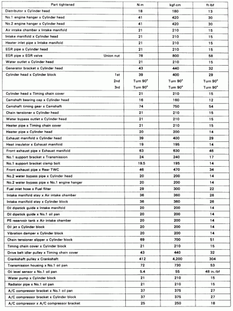

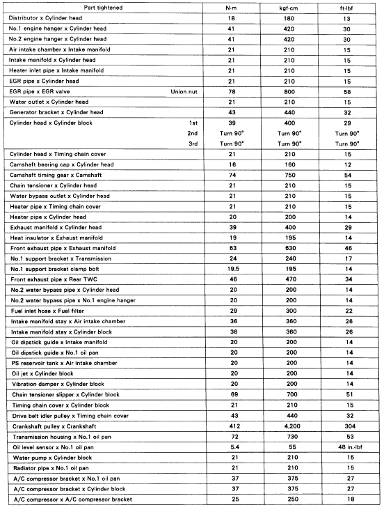

Wish Toyota would just put out a damn torque number instead of the 3 step process on the headbolts :mad: Finally got the block cleaned up enough for my liking bolted the EGR plug and got the head mounted last night :) its a slow process cleaning and replacing all the hoses and clamps as I go. Didn't know until I got the head back on but the connector to the rear Knock sensor broke off in the plug when I thought I unplugged it so had to order one so I can put it back in before I start reassembling the intake side which is the most work.
Looking good LL and yes that's a bit of a pain to torque the head down! There's always bumps in the road. When I did mine I missed the step calling for FPIG between the block and the timing chain cover. I ended up trashing my first head gasket and having to wait on a second.
Thanks bud. I did the same :bang: missed the FPIG part and started torquing the head down but I looked real good at it and I can't see it being that big of a need. It doesn't look like the use much. Was planning to move on without it had you read any conversations on it? Will go look while I'm in here :)

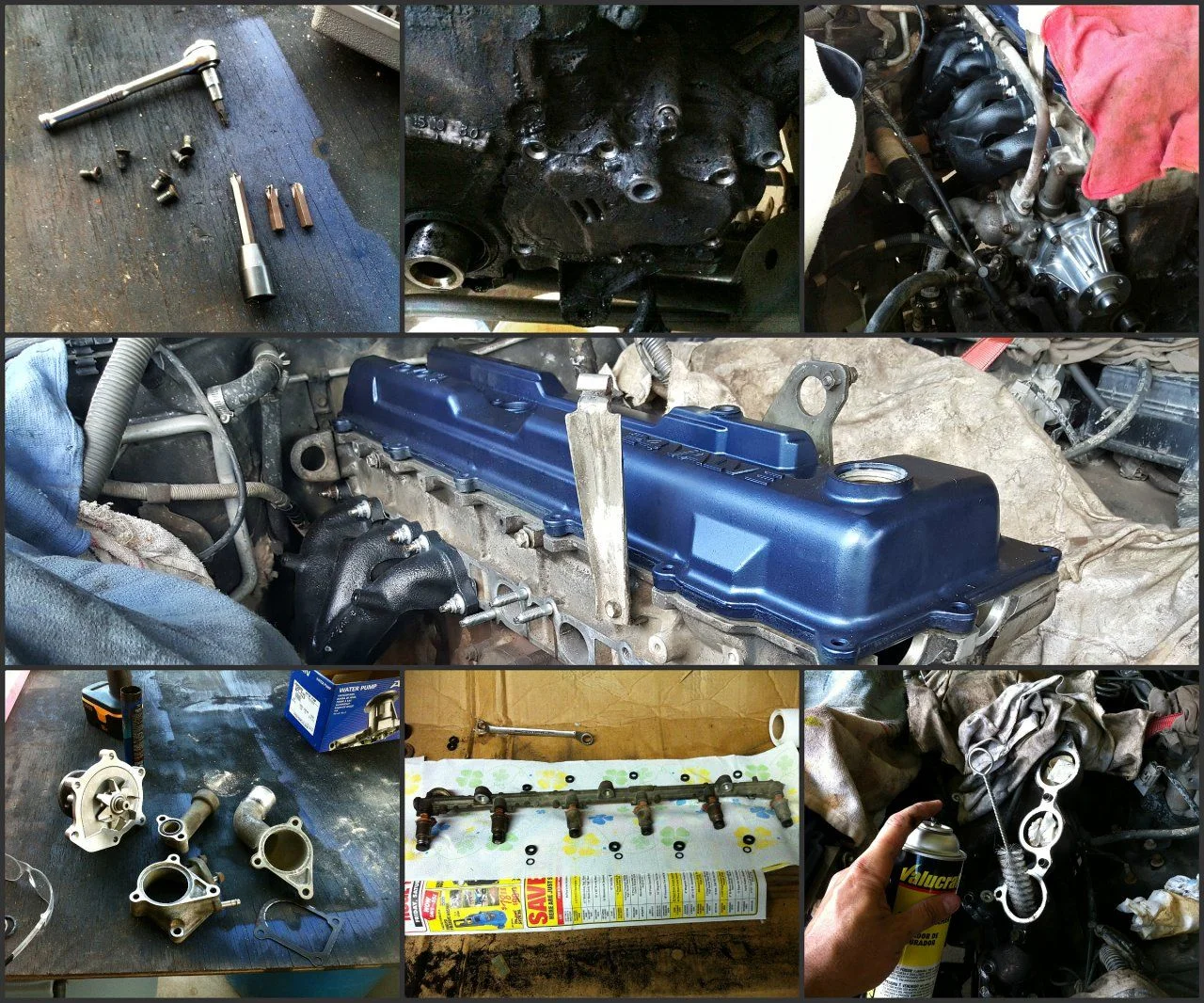

I'm so ready to get this project finished and get it on the road or off the road :) like a lot my projects I took a job and turned into a much bigger project replacing a lot more than it needed but the old adage while I'm in here I might as well.
Very nice! Are the headers ceramic coated?
I've got some valve cover envy:D
LOL, thanks bud, no I just blasted and painted them was tired of the worn and dirty looking parts but in an offroad rig it doesn't take long before its all worn looking again. I wanted blast and paint the water outlet parts as well just fell behind with my surgery.
