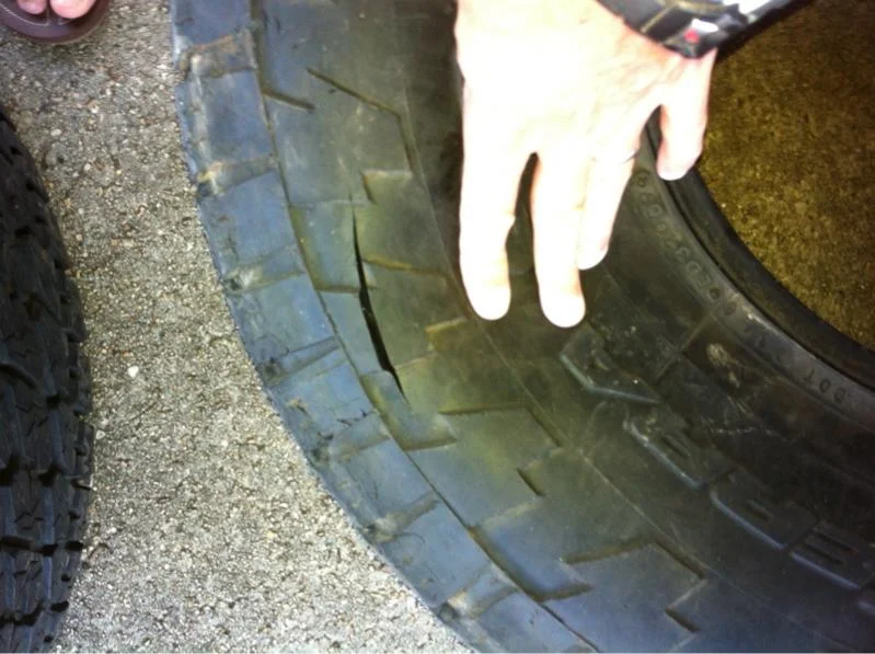

Good to know bud the Hot Springs rocks are slicing up my grapplers of course they been to Tennessee a few times too so I think I've gotten my money out of them but will be looking to see what my next AT will be I drive my 80 to work everyday so a set of MT's wouldn't last me.
Exactly why I'm afraid to buy new tires.

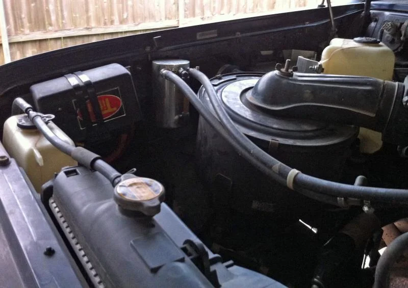

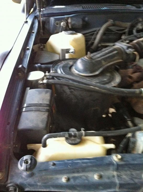

Don't know that I posted these here before SCC. This is the winch solenoid pack extended and relocated under the hood to get it out of the weather and so I can now use the wireless remote. It was a huge PITA bending and positioning the terminals to fit back in the solenoid pack but in the end I like how it came out. I used a Tv bracket in my pile of junk parts that turned out to be a perfect fit for the solenoid pack gotta love it when you save all those junk parts and they actually come in handy to use :) I used the Slee relocation kit to move the windshield washer out of the way to clear space for it :D
Is that the HF winch mount, where ya basically just cut off a couple on's and it kinda bolts up, looks sweet either way. ;)
Thanks Cody Sent from my iPhone using IH8MUD
Yes. It's the HF winch channel. I cut the sides to outside frame width, and also part of the front to fit it inside the stock bumper; the rear upper bar on the winch just touches the center support bracket. With a smaller winch, I suppose one could mount the plate a bit further back, and avoid having to cut the front of the winch channel (which provides support to the fairlead mount).

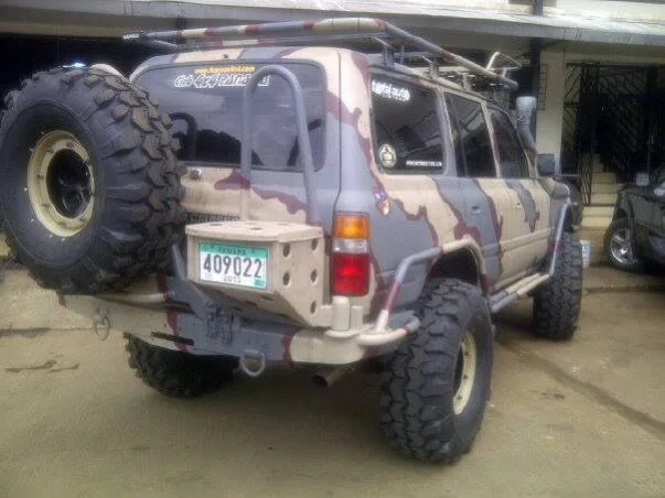

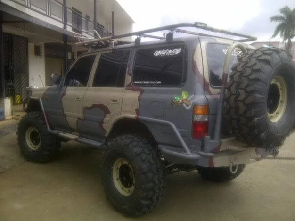

And Larry, that's a sweet looking 80 dressed in camo. Makes me want to get one.....
