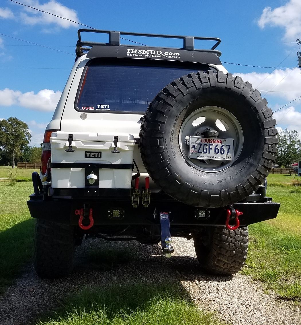

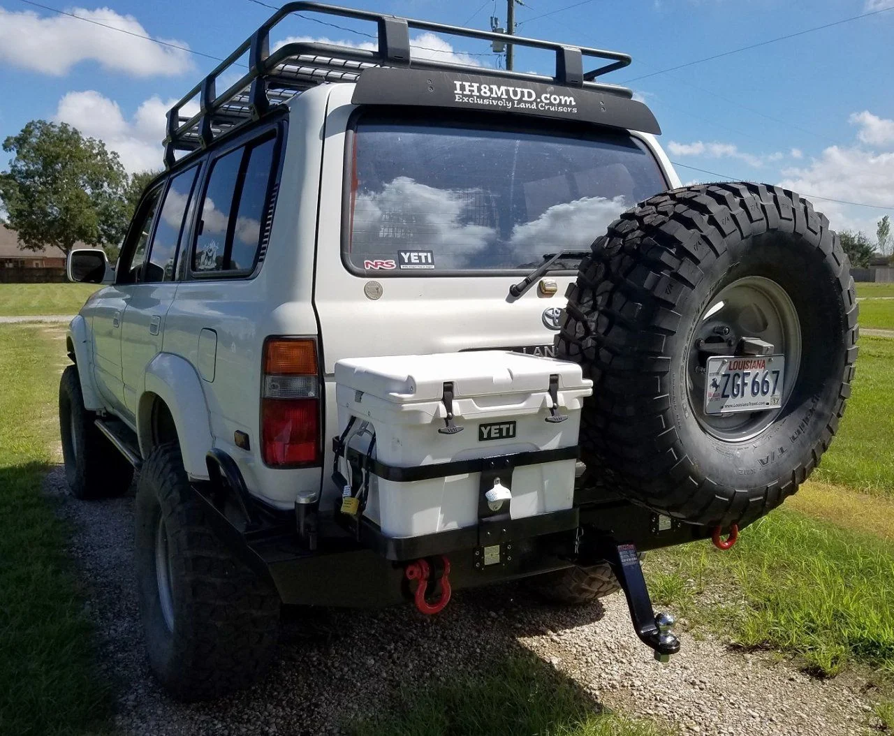

Finally finished the rear bumper...
My birthday present from Nicole.

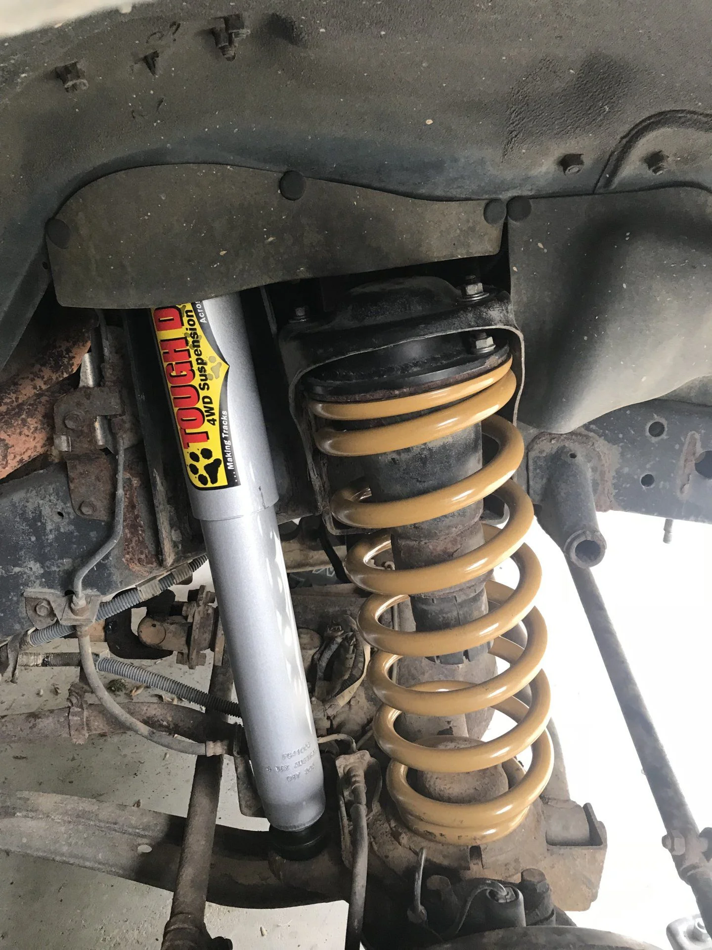

Sean @Footwork post up the pics and details of your TD suspension install. What most don't know they're not a new manufacturer just newly available in the states I think they offer a good product and another option to OME :cheers:
