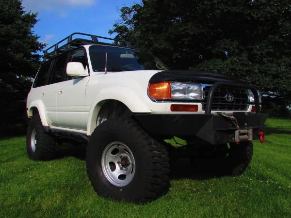

My 1st generation front and rear Slee bumpers will be for sale soon...
I can't recall, what does a Slee First Gen Front Bumper look like?
Looks like this! :)
