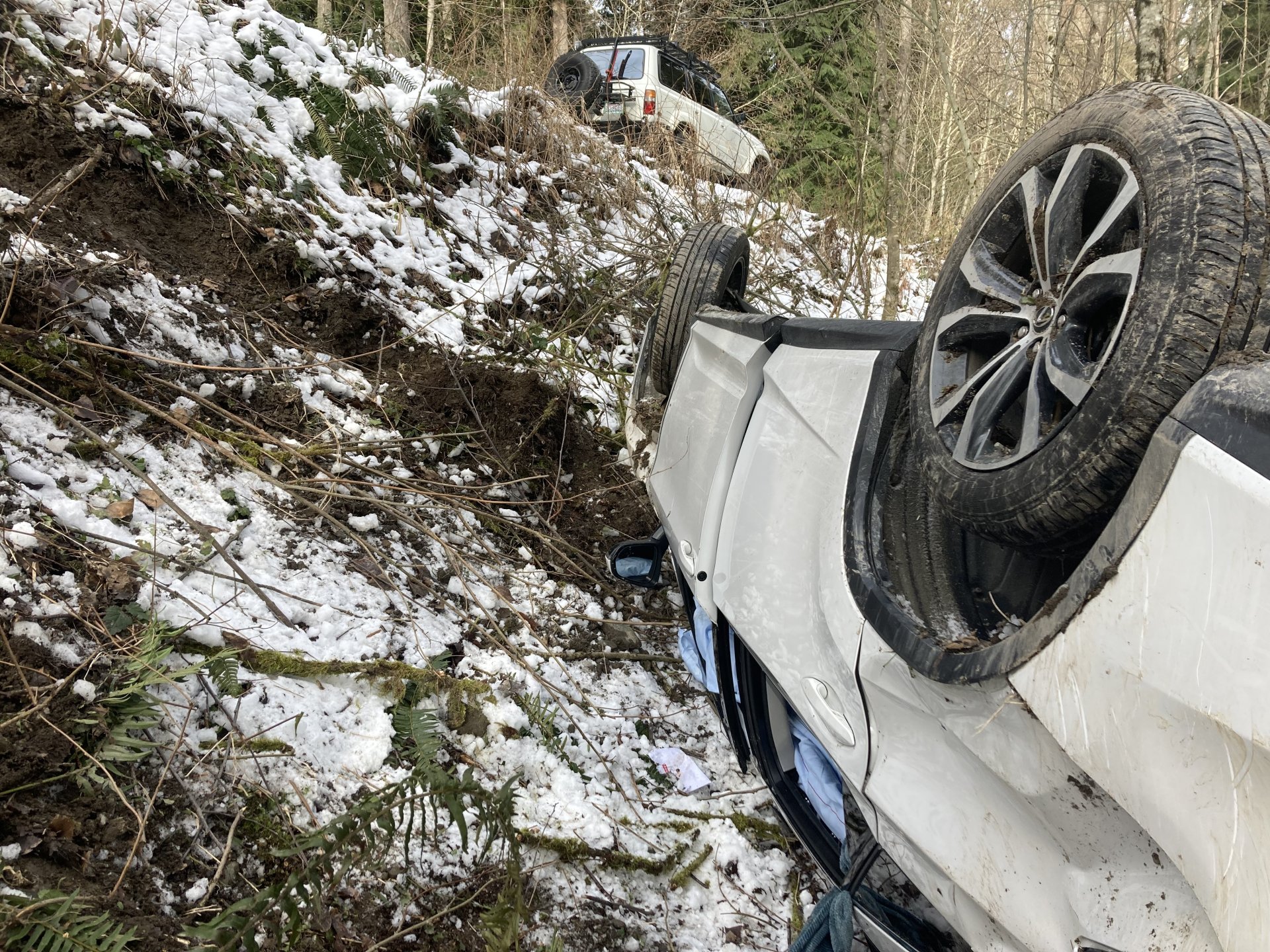

I guess it seems like it would work the best. Lockers aren't the answer for snow on pavement (not to be confused with snow wheeling). I think the cruiser 4wd is gonna work great on icy roads, especially if you put some excellent winter tires on it. I would prefer ABS on my snow car, but that because I have low experience with non ABS in the snow, I can hang and pump brakes and all but ABS, AWD and snow tires are a winning combo. Tires are key. I just found a new LX crossover rolled down an embankment yesterday when I went out for a snowy hike. The FS type road had gotten 1" of snow, but had frozen underneath and this car lost traction in the turn and slide off the road and rolled. It was abandoned when I found it but it had generic dealer type all season tires which are generally pretty mediocre performers in the snow.
