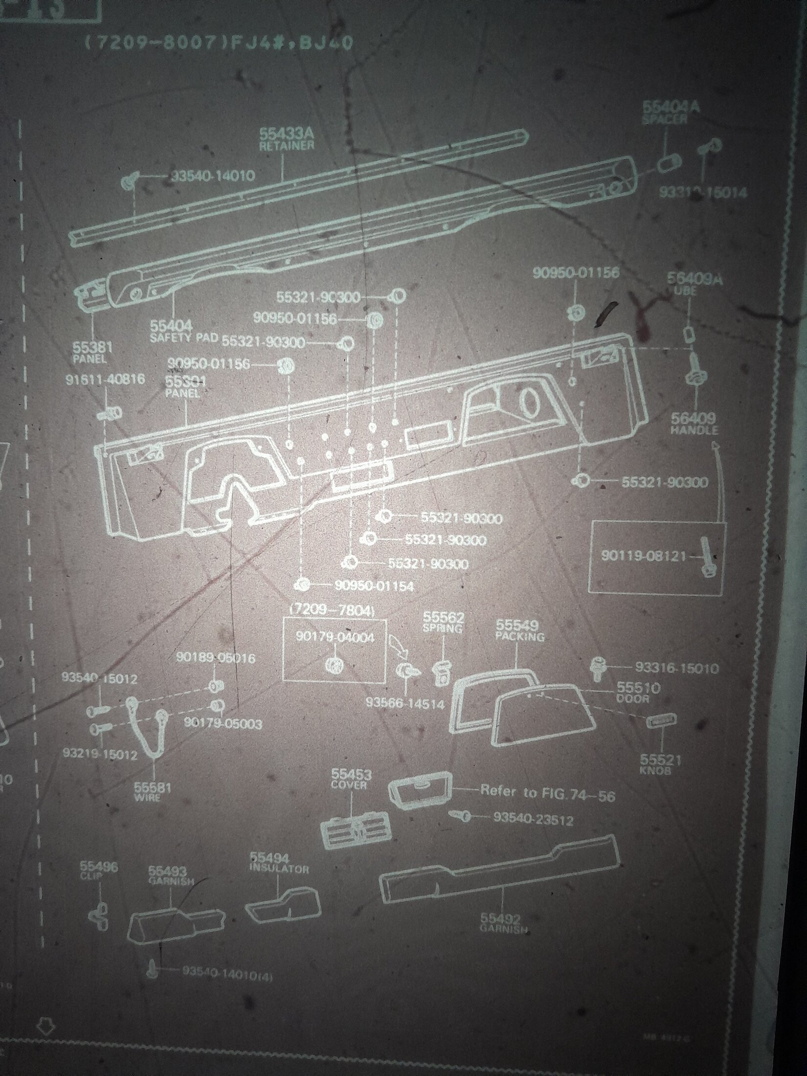

For 78 and later 40's with the side window defrosters, are the OEM bolts still available that replaced the knobs that fasten the windshield frame to the dash? Would anyone have the part number if still available?

See the pic from my microfiche set. Looks like p/n for that bolt is 90119-08121.
The correct part number is 90119-08293 and those bolts are discontinued from Toyota.
Thanks for the reply. The 90119 08121 posted above looks like the bolt for mounting the bracket to the dash??? I retrofitted the side defrosters on my 77 and currently have allen head bolts with washers securing the window frame to dash due to the interference with the defroster.
