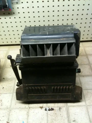

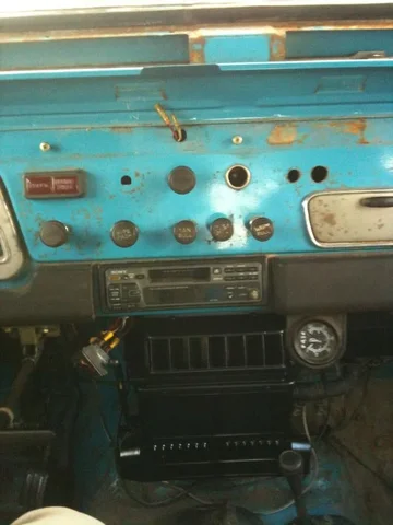

Project 2 - Refurbish Front Heater
The heater was not working at all when I picked up the 40. That took top priority now since I was chomping at the bit to get on the road, and it was winter. I found that the water control valve was full of junk. I pulled that off, cleaned it up with a hose and pipe brush and shot it with some WD40. That got the valve working almost like new. Then I decided to refurb the heater (front only at this point). It was in decent shape to start with (just some surface rust, scratches, rotten gaskets, and a dirty heat exchanger).

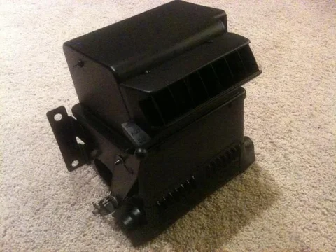

I pulled everything apart. Scrapped off all of the gaskets and used goo gone to get the residue off. Then hit the metal parts with a wire wheel and some loc-tite rust dissolver for the tight spots. I sprayed the cleaned up parts with rustoleum primer and paint. I went with 3 coats and it turned out better than I expected (I had almost no experience with spray painting). I used duplicolor bumper paint for the plastic parts ( I made sure to rough them up a bit with some sand paper prior to spraying with the prep spray and color)
I used some door gasket material from home depot for the gaskets.
I cleaned the heat exchanger with CLR several times with great results.
It was a very low cost way of doing it, but it blows hot air and look great. (especially when it is the only thing inside the cabin that has been painted in the last 35 years!)
