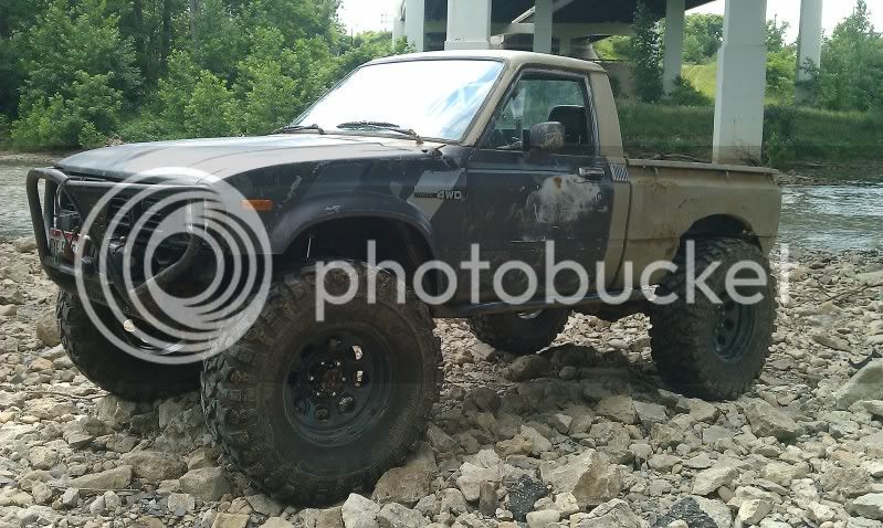

this is my old turd some of you may have seen on the trail and on the road. lots of miles and memories. it will be a firewall buggy on 42s someday...
yeah i love that little truck. you dont see too many fuel injected first gens around here...ive never seen one. the wheelbase is stretched 3 inches in front and back and its 3-4 inches wider than stock. 12" bob on the shortbed. stock rear springs up front, F150 springs in the rear. etc., etc. it works really well for what it is, it just doesnt off any level of comfort and thats becoming somewhat more important. at least with the 40 i will be able to recline. actually the 40 has really decent room with whatever seats these are in here.
i keep the little pickup running thinking someday ill come back to it. the actuality is, i probably never will, but its the first truck i built, so i will likely hold on to it forever.
