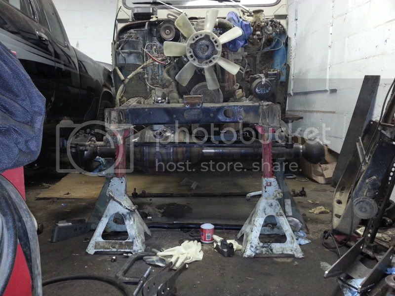

front axle mocked up:
pic thru the roof. about a 100" wheelbase.

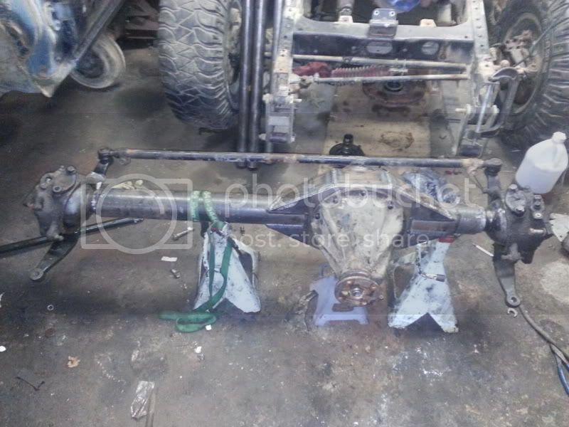

I sprung for a Ruff Stuff 9.5" front axle built to stock 80 series width.
here it is with the RHD steering arm that is so hard to come by.

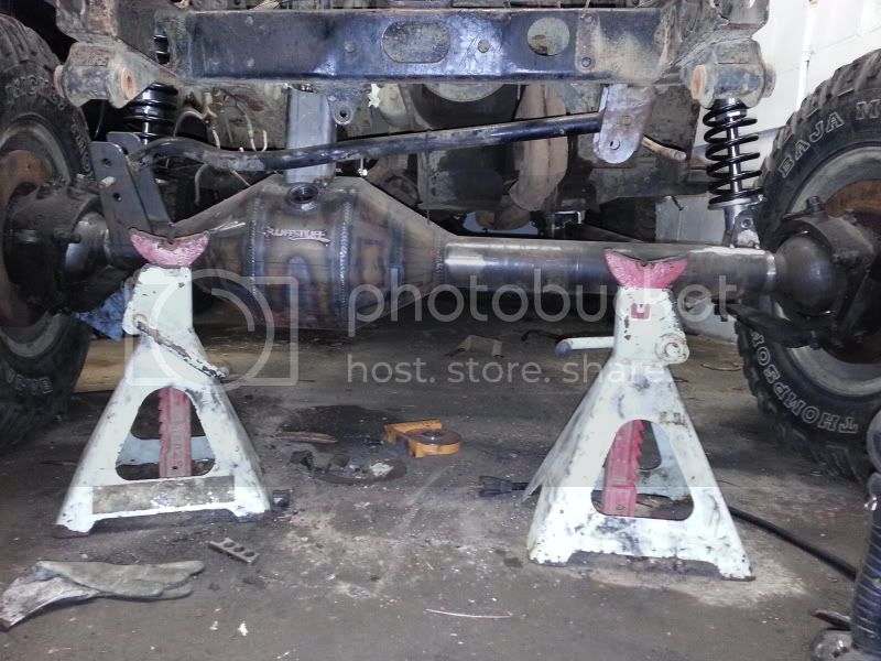

with that i started mocking up my suspension.
I ended up not liking the adjustable towers so i just notched them and brought them into the frame and got rid of the adjustability. that allowed my coilovers to lean in some too, which i wanted.

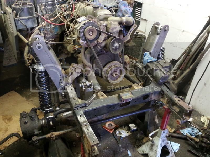

Working on getting the volvo power steering pump attached to the 2F.
Had to move the radiator over an inch to clear the 80 series steering box. I will have to pick up a taurus fan now that the mech fan does not line up.

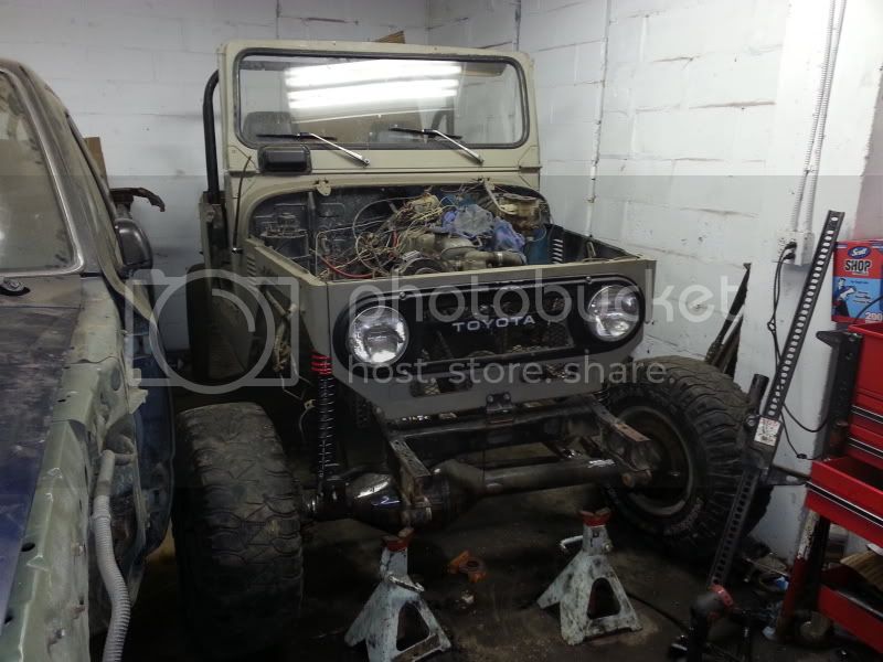

So far I am at a 102" WB and guesstimating 23-24" to the frame on 37s. With the axles being 8" wider than stock, this truck should work pretty well on the trail.
Well I am still plugging away on this thing. I got to drive it home and down to Roseville for the toys for tots run at Heiney Farms. It was nice to drive it and feels a lot better stretched and wider. Still have a few bugs to work out but I am very pleased overall. Bodywork and Motor swap next.
